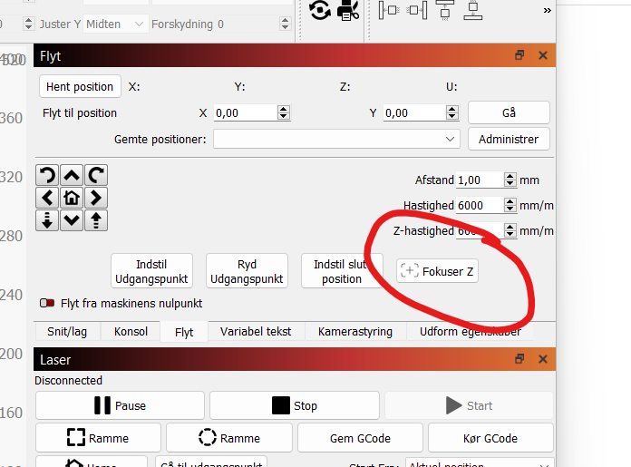

Hello
Is the “Focus Z” controller-specific funbction?
I use at Cohesion3CD controler, and the bottum does not seeam to do anything.
Is it beasuse the function is specific to the controller?

The button is specific to the controller but should be configured for the common way to do this for each controller.
You can check what command is used to do this if you enable “Show All” in Console, then push that button. You’ll need to be connected to the machine when you do this.
