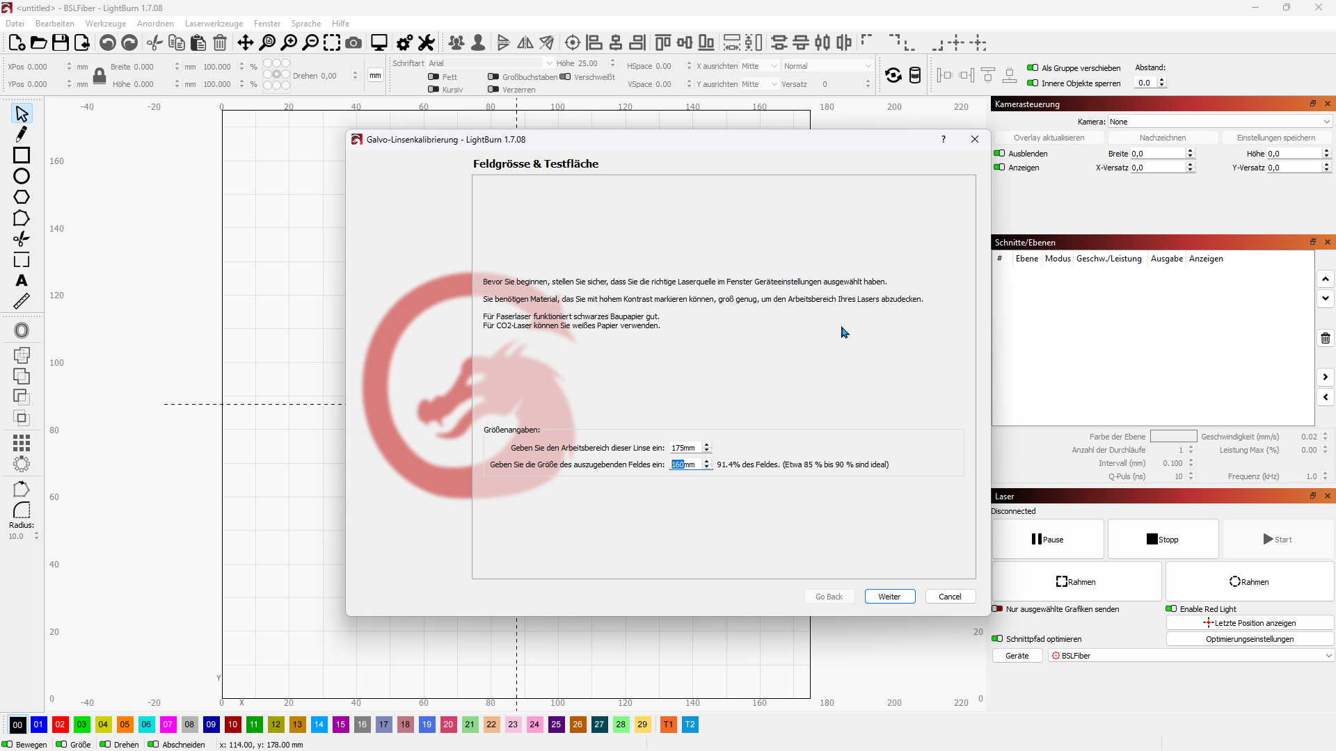

before I ran through this procedure my lens was nearly calibrated correctly.
I have a 175-mm-lens and chosen a 160-mm range. But the 9 squares were way too small. Every measurement at about 55 mm.
After dialing in all the measurements my scaling was totally off and a test-square appeared at almost double size. Running the procedure once again I got almost the same size of these 9 squares (so they are evidently not affected by the new scaling factor).
Any ideas, how this could happen / what went wrong?

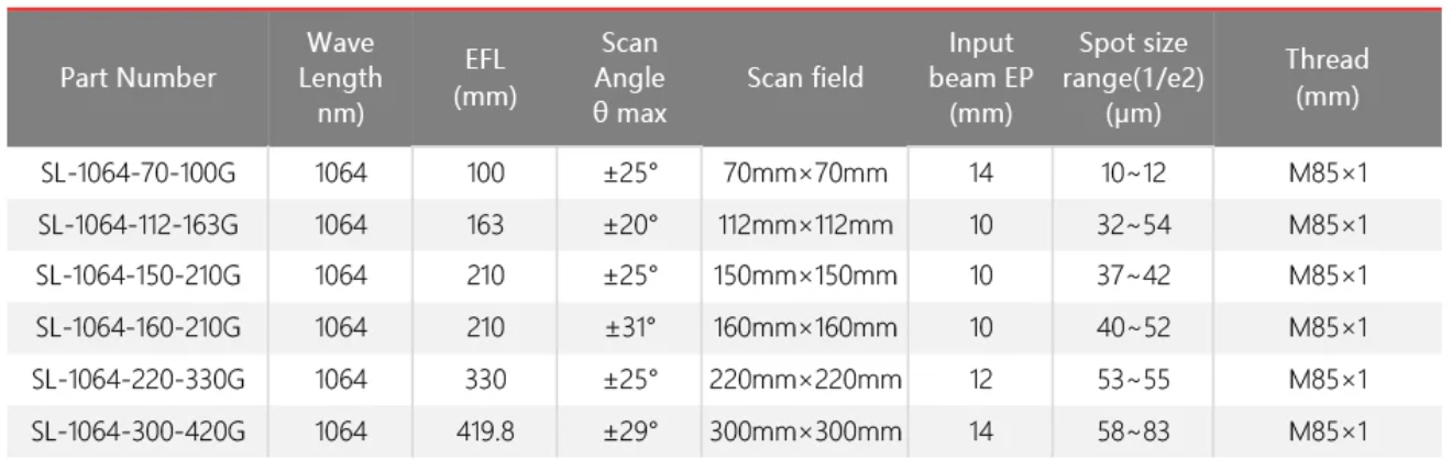

If it’s an F175mm, the focal length is 175mm. You can’t change a 175mm lens and focus it to 160mm. An F163mm has a coverage of 112x112mm. It can’t do a larger area than it’s scan will allow.
An F100mm lens has a coverage of 70x70mm.

My lens has a working area of 175 mm x 175 mm.
The recommended size for the over all width and length is 85 to 90%.
I typed in a square of 160 mm x 160 mm, which is about 91 % of the maximum working area.

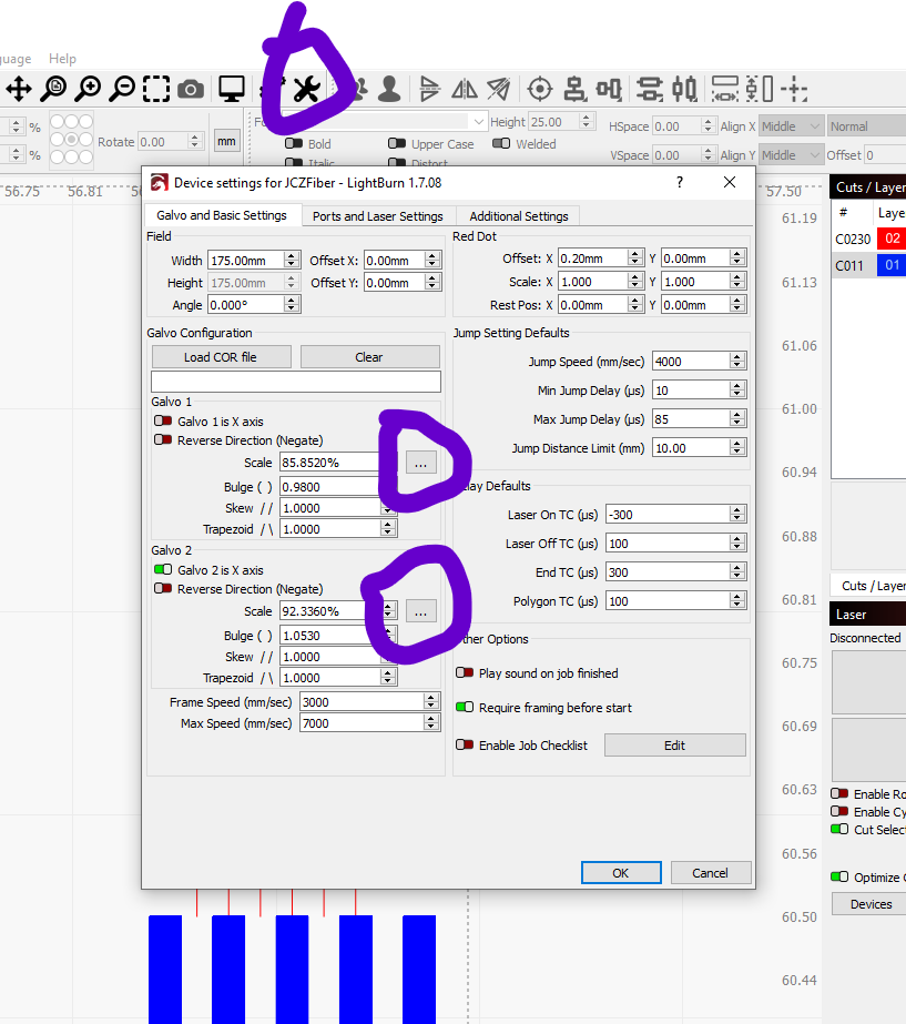

If the 4 squares are too small but correctly proportioned, complete the 9 point correction and next step is the scale utility. Make sure you are perfectly focused and run these two, one at a time.
I looked for documentation “Calibrate Galvo Scale” didn’t find anything, but it basically asks for input actual, input correct and makes the adjustment. Could do the same with a calculator or slide rule I suppose… :smiling_face_with_sunglasses:

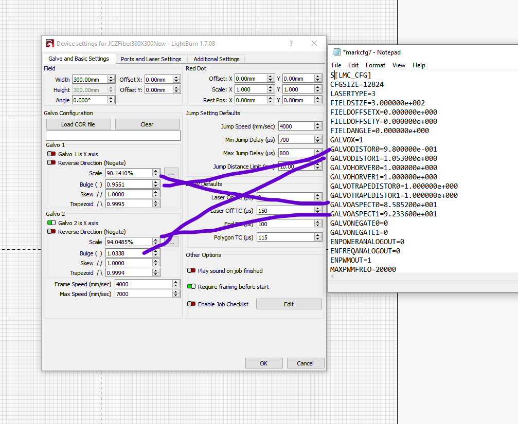

I don’t know how exactly LB does this, have heard issues IIRC about the 300x300. I didn’t have the issue so just lucky. I didn’t even know about the “Scale” buttons when I did mine, but I was as close as the original markcfg7 file.
Original markcfg7 from factory, LB 9 point.
Interesting thing, the markcfg7 file from the factory trapezoid and skew no corrections, both 1.000 for all 3 of my lenses.
LB 9 point trapezoid has corrections.
As far as skew, I don’t think LB 9 point or corefile2 can calibrate skew without a corner to corner measurement. It has to be done manually.

But there are the original settings for the scaling factors to read on the plate or in the manual.
Think, I should start from these settings and then go for the perfect lens correction :wink:

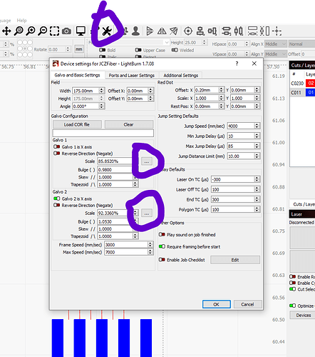

I drew a 60mm x 60 mm rectangle and it was lasered to 106mm x 105 mm

After rescaling I have this for 120-mm-square
It is not really perfect, but I will be patiently waiting for correction of the buck by the team of lightburn or LMA
Maybe it’s just me, but the top line doesn’t look too square.
It does appear curved.
