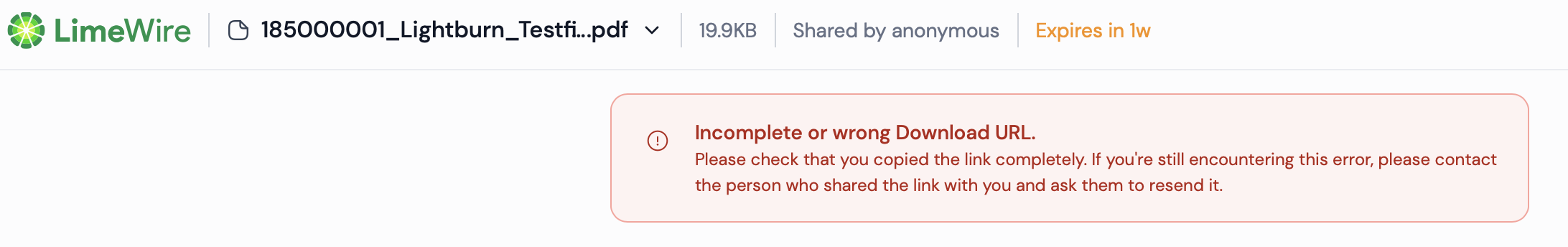

Here is a link to a blank sample file to help illustrate the problem:
That link does not seem to work?
Uh sorry, i hope that link will work:

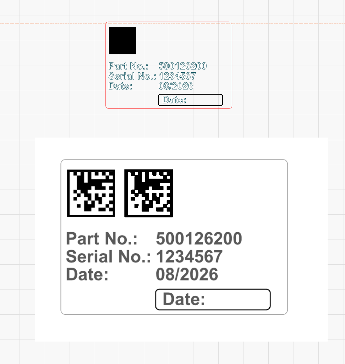

I can see what you mean, but I can’t see why the code is changed this way.
If I import your file as a screen dump I can trace the code without problems, but it’s very cumbersome if you have a lot of cards.
.PDF is probably not the right format to save the file in for LB because it has mixed content.
In the bottom image the code is traced and a “line object” the rest is still an “image”.

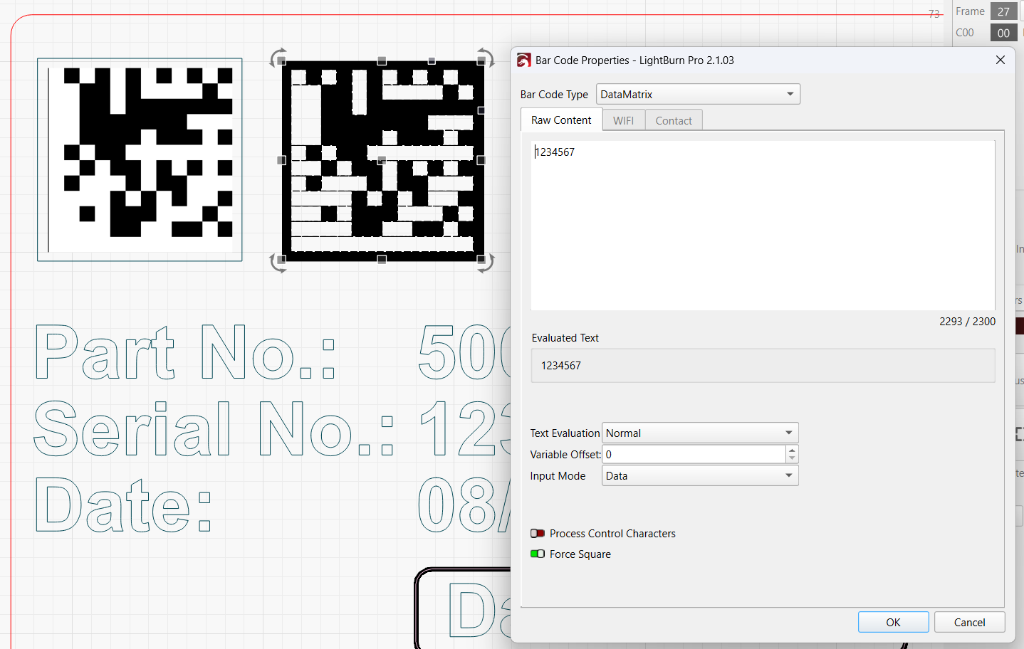

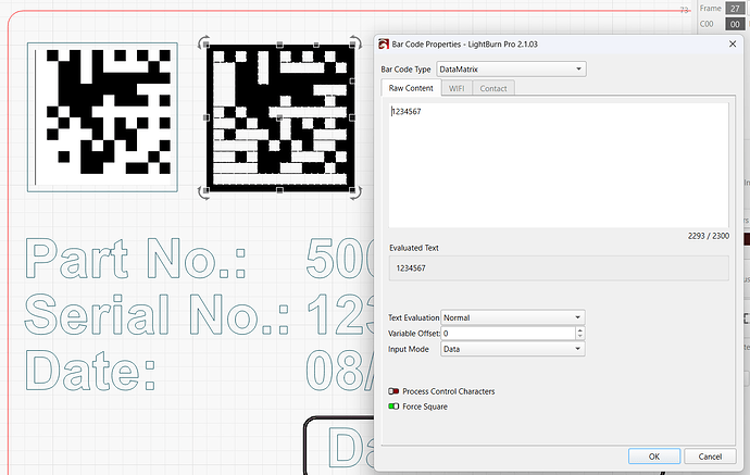

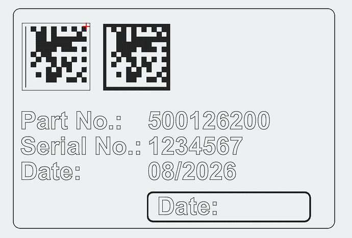

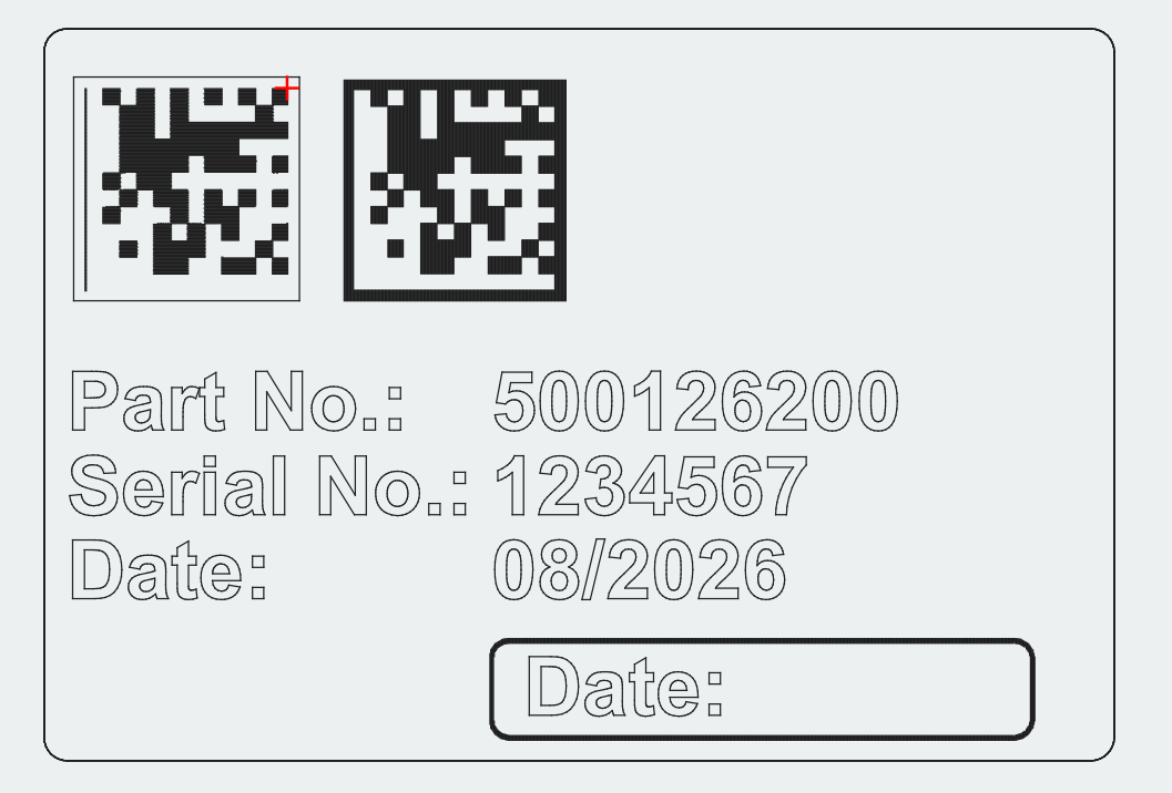

Assuming your serial number was the DataMatrix source, I just used LightBurn’s internal barcode tool to produce a DataMatrix next to your original:
Yours is inverted, so I had to draw a rectangle around the LightBurn one to do that, but they’re identical otherwise, as you can see above.
This is how it was configured:
The PDF version has several images stacked on top of each other. One of them works, and the other two appear to be unsupported - possibly masks or palettized. If you are able to export as vectors it would likely work.
