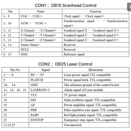

I don’t know if this answer is for me, but in the case it is. Im just concerned where to get the signals from BJJCZ boards that’s says laser is working
Which version do you have? I’m seeing a few different ones on their site.
Original Standard BJJCZ board for EZCad2. I don’t know the correct model number because I have yet to open my Galvos cases just haven’t had the time yet
If this is your card:
I found this pinout document…
I’ve only worked with diode lasers, so I’m not familiar with all of these connections & what exactly they do. There appears to be multiple possibilities on the CON2 connector. Hopefully someone with knowledge on this will come in.
Well the outputs are TTL level so they will be 5V.

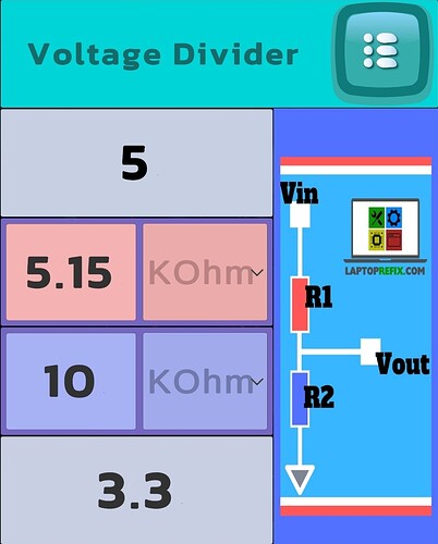

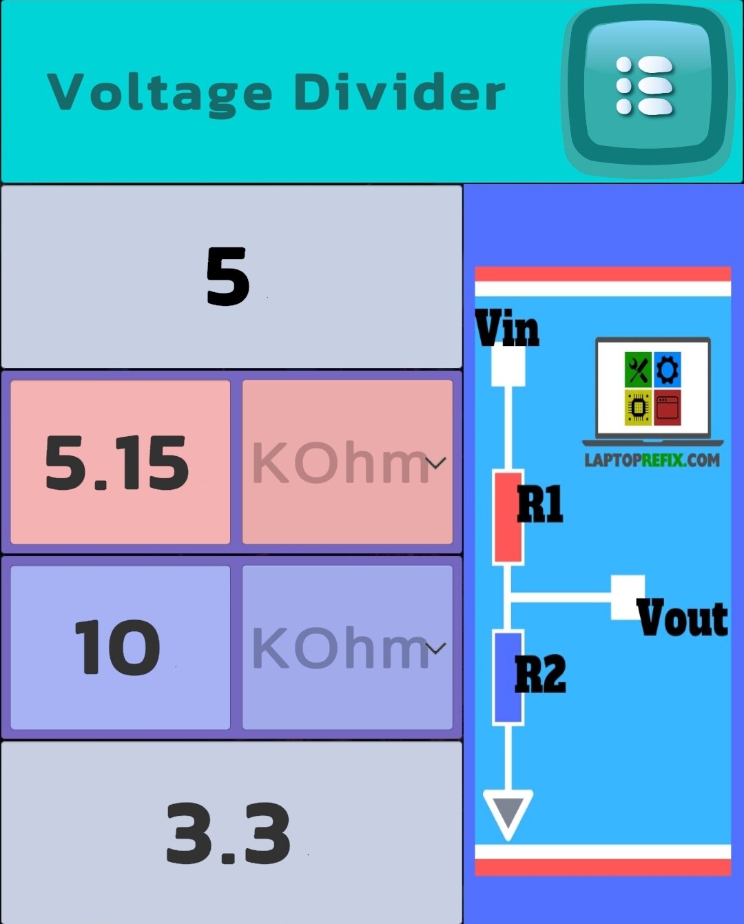

A level shifter as a precaution or a resistor ladder to step to 3.3v logic. I am on the side of level shifter since they often use optoisolator
A simple voltage divider will get you there…
The Arduino Nano is fine up to 5 volts on its inputs. The Arduino Pro Mini is 3.3 volts max.
I would recommend starting with a meter, then a voltage divider on the Arduino input until it’s determined the voltage range that can come from the controller board.
