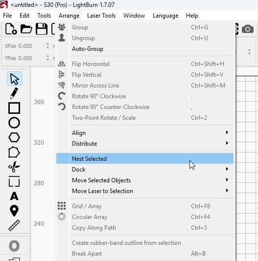

LightBurn has a connection feature to a nesting tool:
