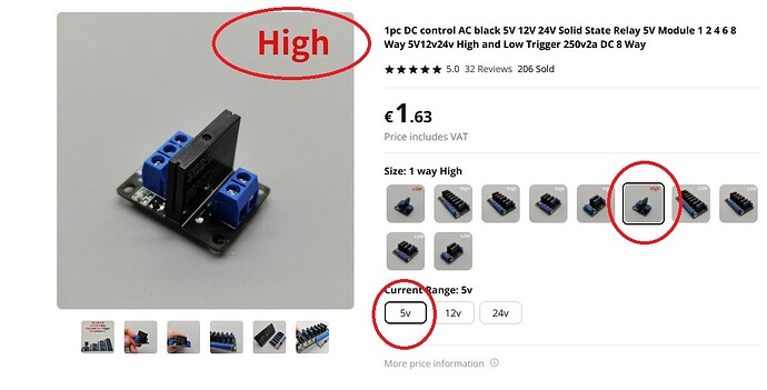

Is this one the right one?
For an S10, yes. Should work fine.
OK, thanks. I will order ASAP.
I spoke with local shop about Relay and they said important are as well Amperes.
The picture is showin air pump model AP-30A. I suppose it doesn’t mean the pump has 30Amperes.
Relay is working probably only up to 2A.
It’s probably got it’s models number from it’s 30 l/m volume.
This pump doesn’t have the current use in amps posted. It uses watts so you can use volts * amps = watts. So amps = watts/volts or 16/220 = 0.076A
You should be fine…
Good luck
