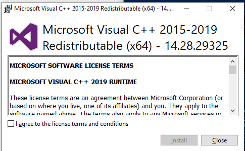

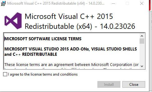

Visual C++ 2015 is version 14.0.23026

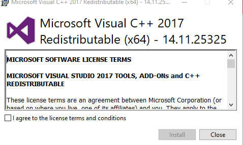

Visual C++ 2015 is version 14.11.25325
and the most recent installer that combiles 2015, 2017 and 2019 is version 14.28.29325

Now as I stated 2010 is a non-issue but doing the first two in that order results in 2015 not installing as the version is less than the 2017 version, thus generating an error.

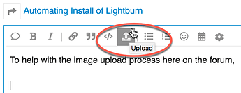

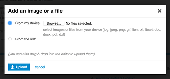

PS: Screenshots of versions and errors are available but I could not work out how to upload them
To help you with the image upload process here on the forum,
Clicking the circled button should pop a new window giving upload options.
Now I feel stupid, totally missed that
VC++ 2015 install error
VC++ 2015 Version
VC++ 2015-2019 Version
VC++ 2017 Version
