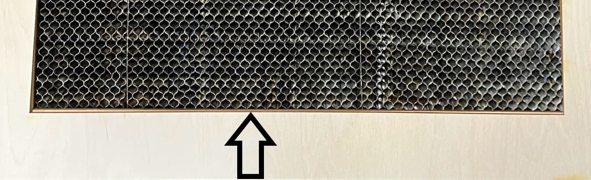

I’ve recently ran into an issue both my c02 lasers are cutting a little off only on one corner. Say i cut a rectangle thats 28.5" Wide x 22.5" high,
the top left to right is dead on at 28.5"
but the bottom left to right is at 28.4375 (7/16").
both height measurements at spot on at 22.5" high top to bottom
These are for picture frames so that little bit off is creating a lot of problems when installing the acrylic for the middle pocket.
I’ve re calibrated the axis, and reloaded the light burn machine setting original back up files. Even went the extra effort and had a friend send me his back up file from the same model he owns.
is it possible to calibrate all 4 corners in light burn, or anything else i might check? Going to rotate the rectangle and see if it follows the axis or not next.
Both machines run off the same computer, going to try is to start fresh with a new device in LB. Go hard wire direct to the machine, then try a different computer. Feel like this isn’t a mechanical issue but not sure what exactly is causing it yet.
It’s been a problem for the past few weeks (that i noticed), i’ve got about 30 different frame designs all doing the same thing. i can send the design file to a friend that has the same machines and his cut’s without the issue :/. was tempted to bring my computer to his house and test if the issue came up or not.

it’s in different locations, however i orient the project it will cut the same. This is happening on two different machines running off one computer. (one 24"x36" and one 48"x96") Attached a picture of measurements of the actual cutout.
