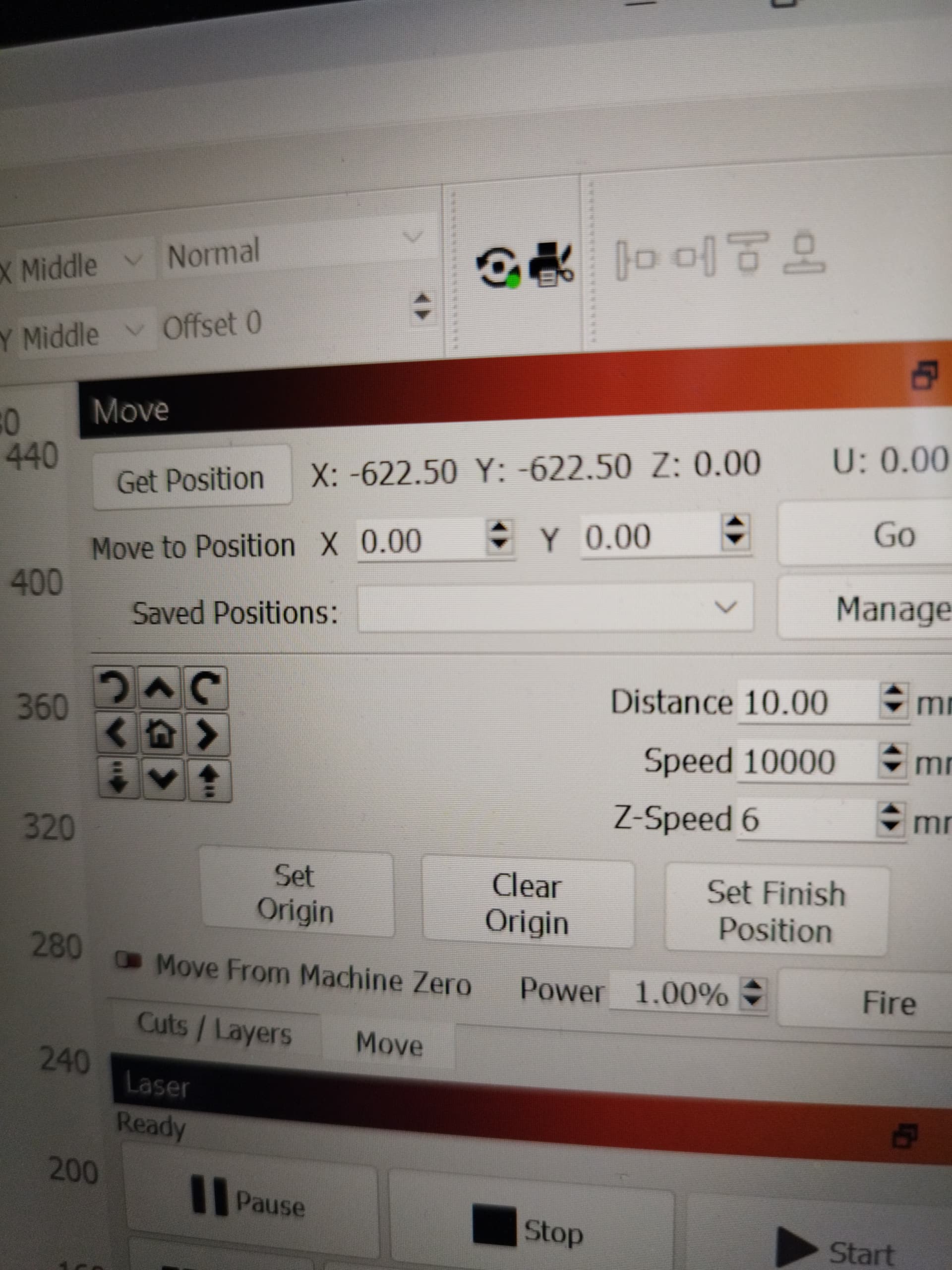

How do I get my creality laser to read correctly on light burn
When ever I connect my rotary tool
Both the x and y axis are in the negatives
PLEASE HELP ME
I have to manually set both axis back to zero and start working every time. Is there a fix to this issue ?

this is commonly the result of a failed homing cycle
Is your homing working correctly?
Right after homing click GET position
Do you see -600 -600?
Yes I have tired that.
It’s only when I use the rotary tool. The rotary tool spins and at the end of that cycle it brings up and error. And when I hit get position it’s still come up to be -600 on both the x and y axis
Thank you I will read. I know what homing is i just wanted to be on the same page.
My machine does not use negative coordinates to work. Like I said it’s just Everytime i plug in the rotors tool and I click home. When I hit get position after the coordinates come up to -622.50 for both x and y axis

if you use rotary, and by the nature of rotary itself, you must disable homing
$22=0
therefore when you pwoer machine, and you move the head to home position
You will have to press “STOP” once to unlock gcode
Normally my workflow is this
Power on mahcine at X0Y0
Click STOP
GO to move
X200 Y200
This will move Y to the center.
Manally adjust location and use “Start from”
Current position center center.
Always worked ok for me
Once done
$RST=*
in console to default everything
Unplug Rotary
Done

The ONLY 2 things that are required when using rotary are
a) disable homing
b) tell the machine you are NOT at X0 Y0 (or it will alarm 2 )
So you can have a script button that does
$22=0
$X
G0 X200
G0 Y200
(you wil need to double check this i am typing from memory)
This would enable rotary mode
and another script that does
$RST=*
This disables rotary mode
What the first script does is tell the machine that you are no longer using homing to define your X0 Y0
Then unlocks machine (if its locked)
And then moves the head away from home position
This means that once you start moving your head around machine will not “THINK” its at X0 Y0. Any hand motions of the laser head are not known to the controller
thats it
