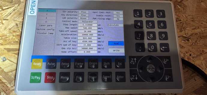

Hello again, and thank you for your feedback.

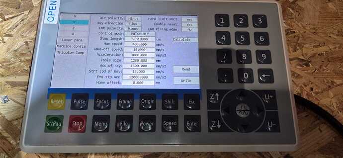

As English is not my native language, I have taken some pictures of the parameters entered for the X and Y axes. I did a video showing what happens when I perform a reset, is it possible to post it?
I’m from Belgium… I’ll send waffles to whoever finds the solution :blush:
I am definitely not a CO₂ machine specialist — I challenged myself to build one. So I’m not entirely sure what is supposed to happen during a reset, but the behavior I’m observing does not match the information I found online. It seems quite strange.
Sequence:
  1. Reset
  2. The Y axis moves, reaches the limit switch, then slightly backs off (this is not very visible in the video, but it does happen).
  3. The X axis also moves and stops at its limit switch. Then both stepper motors start turning for about 1–2 seconds (both pushing toward the limit switches, then they stop ???).

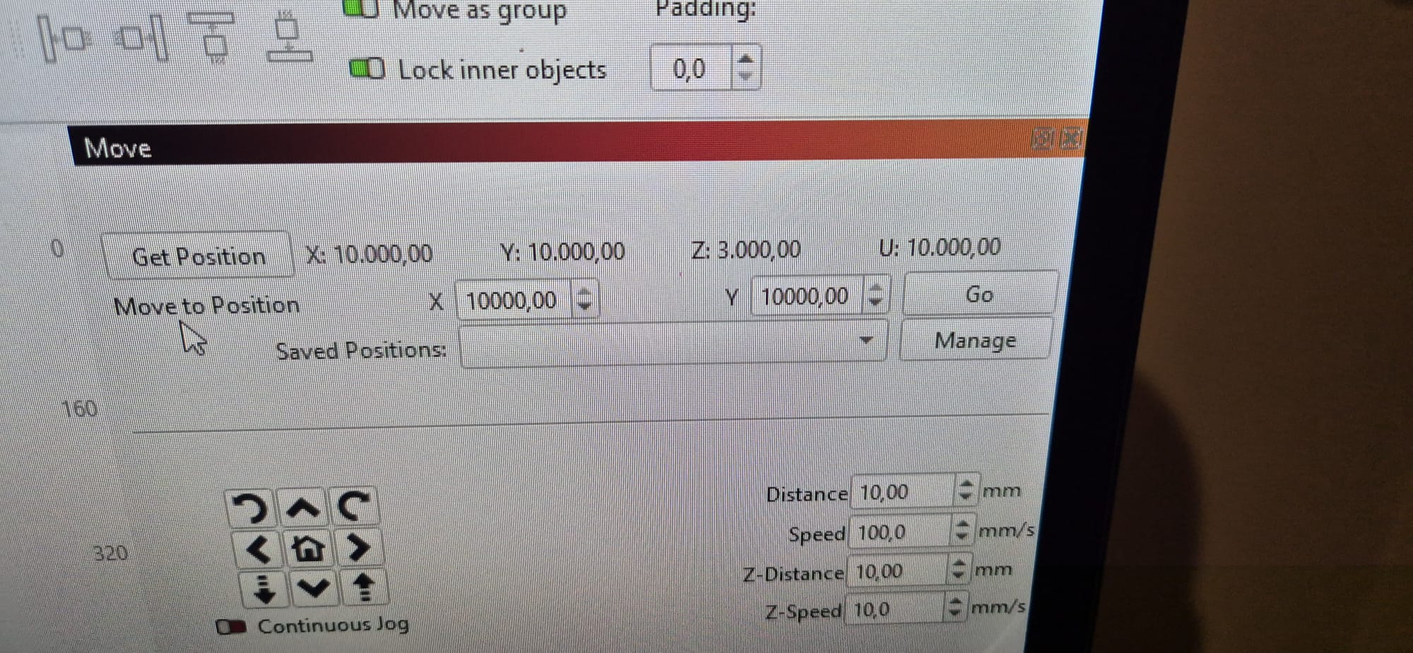

  4. The coordinates on Lightburn and Ruida are
  5. X : 300,0 mm
  6. Y : 35,6 mm
  7. Z not relevant but : 3000,0 mm
  8. Then I try to move back the carriage away from the X limit switch (with X arrow on Ruida). It moves slightly, and I immediately get a limit switch alarm ??? My limit switches are wired as NC (normally closed).
  9. After that, nothing moves anymore.
  10. (Not shown in the video) When I reset the limit switch alarm, everything remains blocked. It is impossible to move the axes either from LightBurn or directly from the Ruida controller. I have to cut power to the drivers and move the axes manually.
I really believe there might be an issue with the controller.

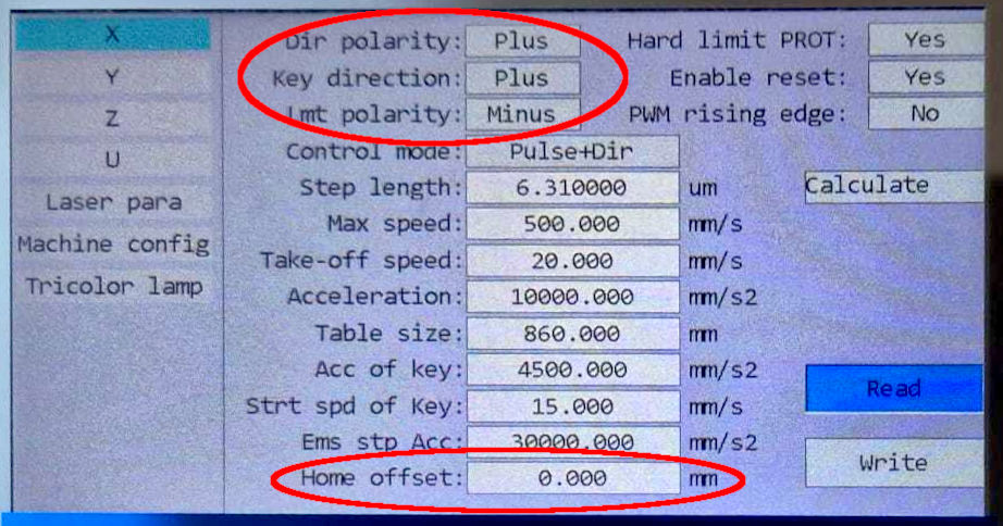

A closer look at the X axis config display:
Things to change:
  • Lmt polarity should be Plus to match the NC switches: the input is positive when triggered.
  • Change Hard limit PROT to No, unless the axis has a limit switch at the other end of the axis from the home switch.
  • Set the Home Offset to 10 mm to put the final position well away from the switch actuator.
Then both axes should home properly when the controller is turned on:
  • Laser head / gantry moves toward the home switch
  • Bump the switch
  • Move away until the switch releases
  • Bump the switch again
  • Move away to the Home offset distance
If that happens, do the Happy Dance.
After finishing the Happy Dance, if the controller jog buttons move the axis in the wrong direction:
  • Change Key direction to Minus.
Ruida controllers automatically back off the home switch until it releases, so the Home Offset sets an additional distance from that point. If the machine has mechanical switches, adjust the Home Offset to completely release the switch actuator / lever.
The controller should have a setting for XY home speed, so you can adjust that for faster or slower homing as you prefer. The 6445 manual suggests it’s in the User parameters menu, but it may also be available through the LightBurn Machine Settings interface.
Let us know what happens!

There are a million settings on these, it’s much more likely it’s just not configured correctly for your setup.

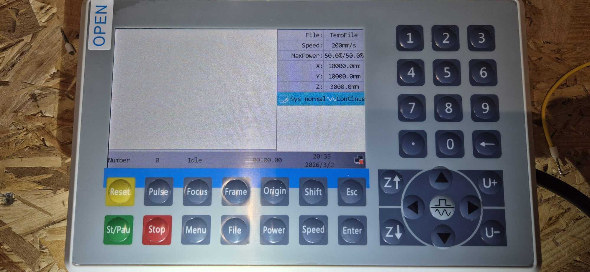

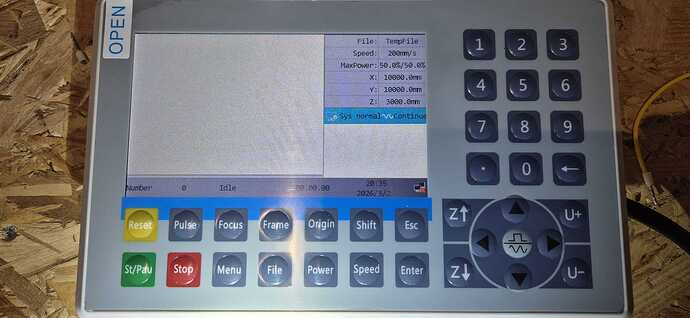

This would seem to indicate a completed boot sequence. The values of X and Y are 10,000 for each axes when a proper boot doesn’t occur.
Your Z is 3,000 which sounds correct for that axes if it hasn’t been homed.
@ednisley brought up the fact you have a configuration error, from these screenshots and I think it shouldn’t boot correctly. So I don’t know what else is incorrect.
Your main problem is most of the I/O on a Ruida is, what many call inverted logic, but it’s just active low. The machine was originally configured for NO from the factory and you put in NC. It can work that way, but it’s a change in configuration that you need to do.

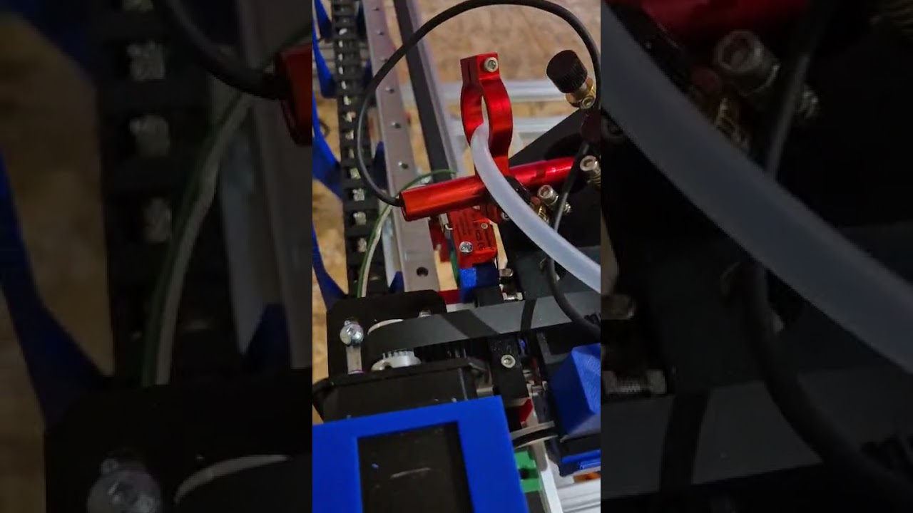

In the meantime, here is the link to the video, as suggested by ednisley. I uploaded it to YouTube. Here is the link.
(https://youtube.com/shorts/xs7wTXBs0pg?si=keWUx73ZXAWgMOJ4)
@ jkwilborn, yes is a DIY.
I get no video when I go to the link. Other videos there play OK. :thinking:
