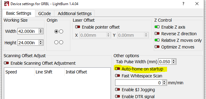

Tengo una maquina laser Xtool D1 Pro 10W
no sea que pasa con el sistema o la programacion del sistema…
no me deja trabajar… ya hice TODO lo recomendado>>> NO IMPORTA EL BOTON QUE APRIETE O ELIJA la maquina sale para la parte superio izquierda a pegar y hacer un ruido… AYUDA PLZZZ gracias
I have an Xtool D1 Pro 10W laser machine lest it be with the system or the programming of the system… He won’t let me work… I’ve already done EVERYTHING recommended>>> NO MATTER WHICH BUTTON YOU PRESS OR CHOOSE, the machine comes out to the upper left part to stick and make a noise… HELP please thank you
Do you have homing switches?
If not, then this needs to be set to off in device settings.
