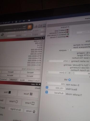

I have a bachin diode laser. Had to replace the control board. LB found the laser, it can frame move and all that. But it wont power the diode. Fan doesnt even turn on. I know before i had some setting to change up in the “$$” comands. Plus a few others. Im on a macbook air now. Running trial version of LB. Last time i ran this all was on windows and back in 2021-22.
Type $$ in Console window and copy/paste here the output.
Your controller $30 have to match S-value Max.
I checked that. It matches.
Sorry my front camera is broken.
You can select inside Console window and grab the output here.
The photo shows $30 = 255, schouldn’t it be = 1000?

Lol it was a bad brand new power wire. When i put new board in, i put a new power wire on the laser, because why not, its apart change out for new things. Well switched it back to another power and old power, both worked fine.
