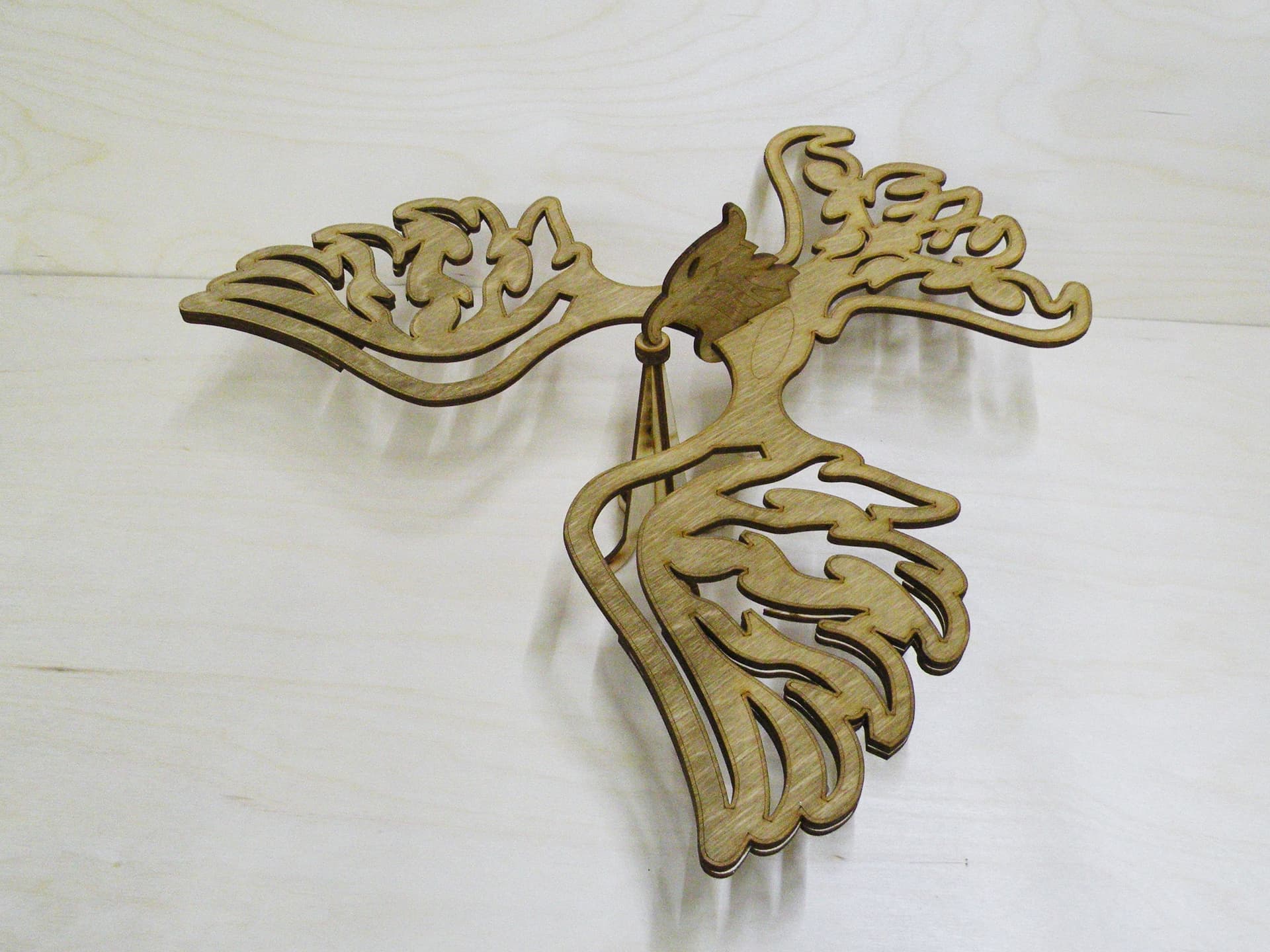

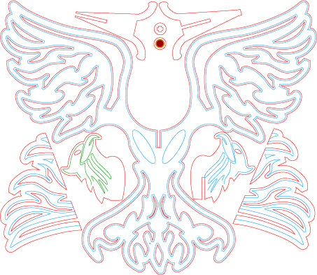

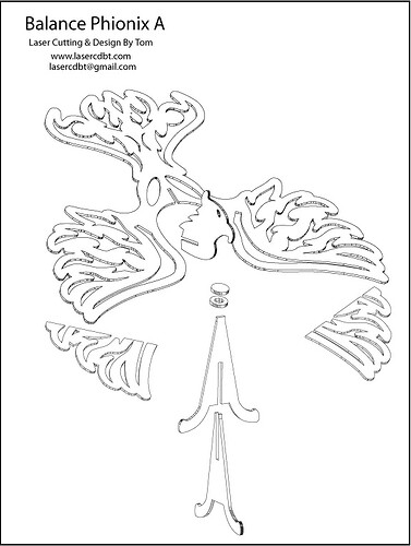

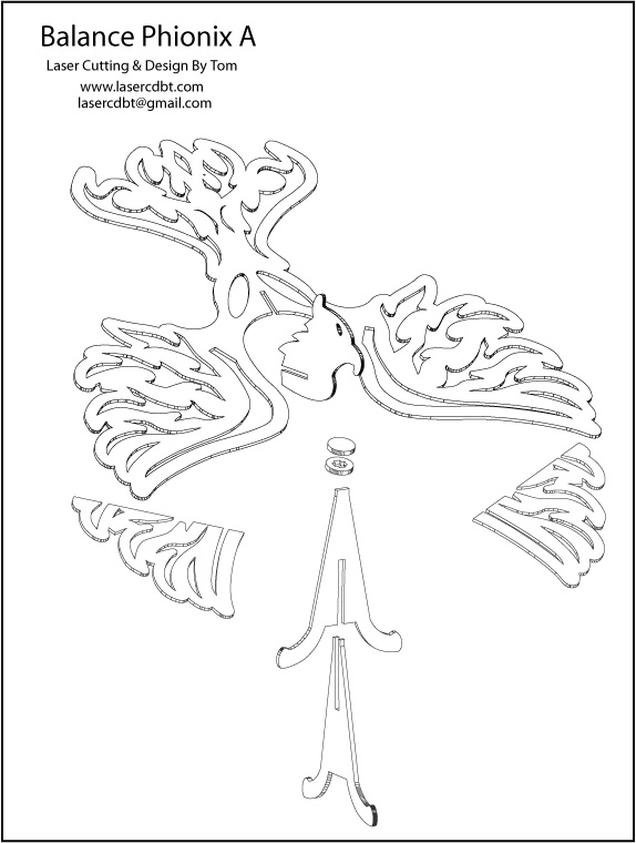

Balanced - Spin Phionex Bird a twist on the balanced bird - cut file attached

I like!
But is there a problem with the right head in the file? As in missing an eye and a slot?
No the second flip side head is to laser engrave the details on the other side, turn brown off on the first cuts, remove right side flip insert in brown, turn off all other colors and burn the brown
Ok, got ya.
