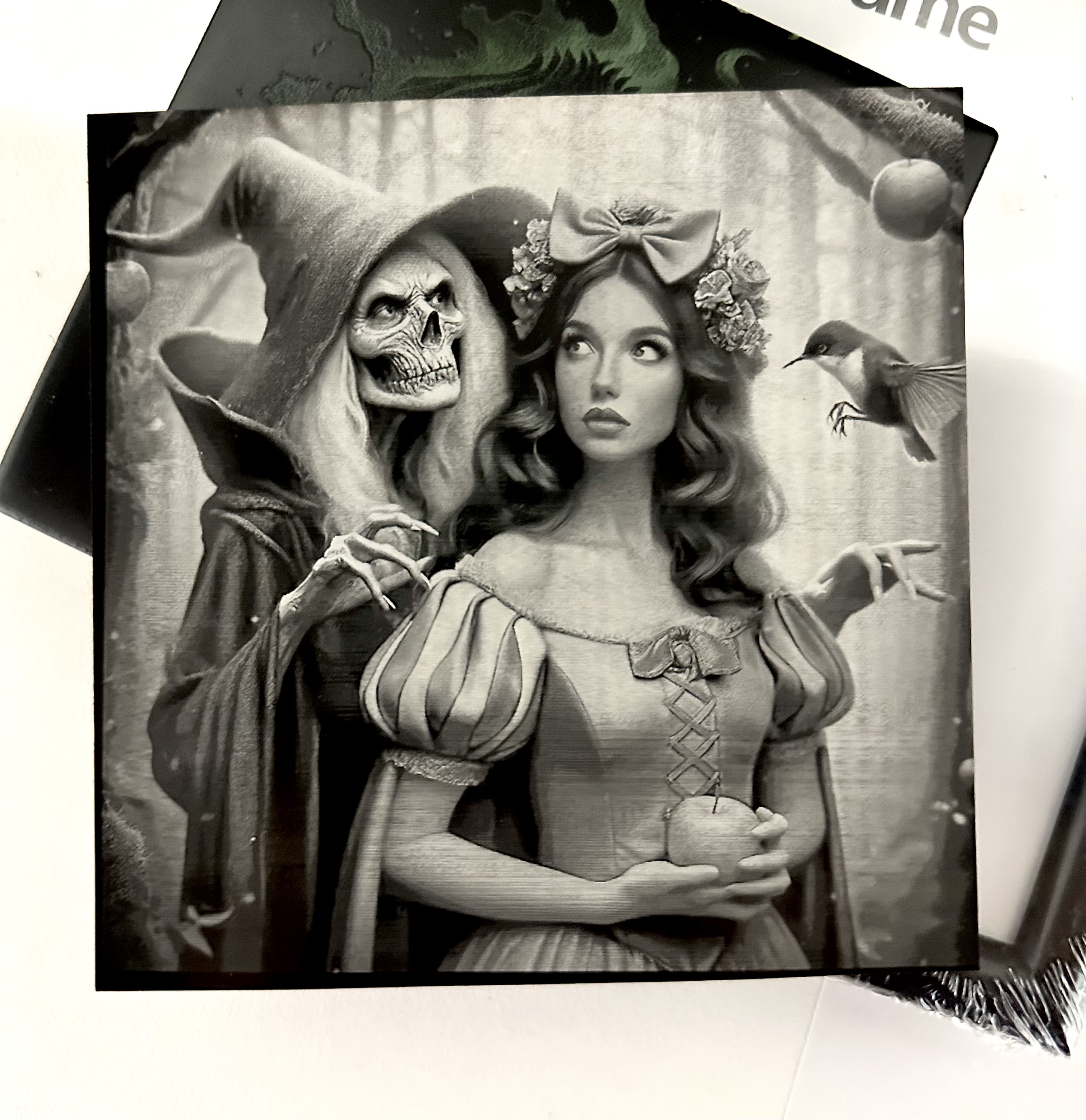

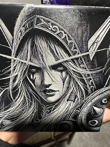

Hi everyone. I use a creality falcon2 12w from a couple of months, and never a problem (at least heavy problem). From few days i saw a bending problem on engraved image, so I checked out all the mechanical part, tightened all the belt and eccentric nuts,tryed different dpi and lpi, different material, but nothing.
I’m not seeing the bending or, more literally, I assume banding issue you’re referring.
Can you edit one of those and circle it. Might want to add items like what material and maybe the process you’re using…
Once I zoomed in, I can see it. What interval are you using and I assume these are porcelain tile?
