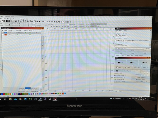

now in lightburn it shows my 180x180 bed. but if I try to put a small box in the upper left corner it will not frame, it thinks it is out of bounds. the bed of lightburn and the actual bed of the laser no longer line up. I AM using absolute coordinates. I cleared the origin… I have tried whatever I can think of but have no real clue how to get this back to where my engravable area lines up with the software again.
PLEASE HELP!
I have searched it but so far nothing has worked. Most posts say to switch to absolute coords and that fixes it… but i am on it and its not lining up still :frowning:
In one of those images is the bed. The smaller blue box is the only area the machine will let me use. The rest of the 180x180 it thinks is out of bounds

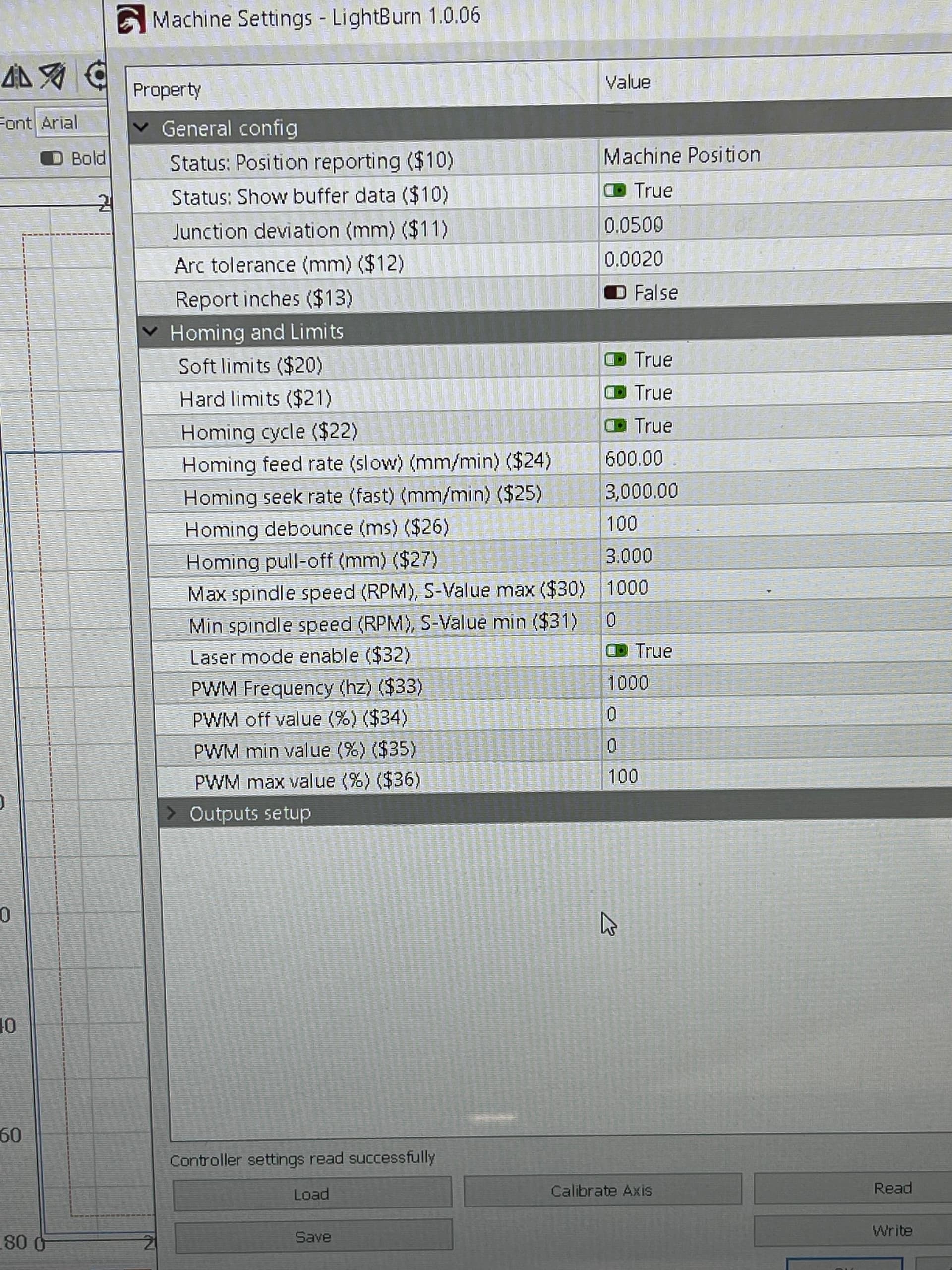

I’m noticing a few separate issues based on your screenshots.

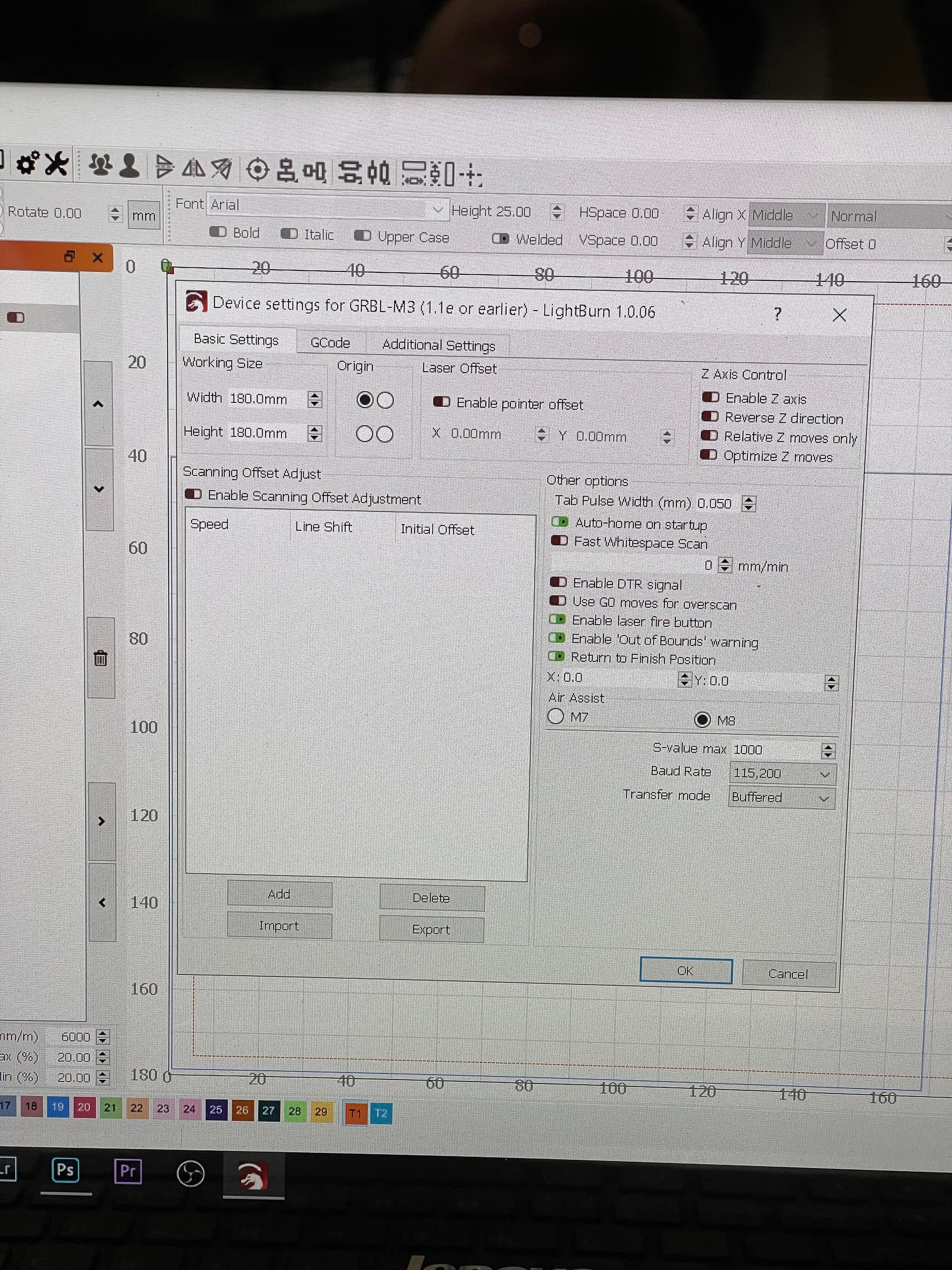

  1. It looks like your origin is set incorrectly. Do your jog controls work correctly? Meaning left goes left, right goes right, etc? If not, change the origin in Edit->Device Settings to lower left.
  2. Your device type is set for GRBL-M3. Your laser should be using “GRBL”. Change this by pushing Devices button in laser window, then Edit.

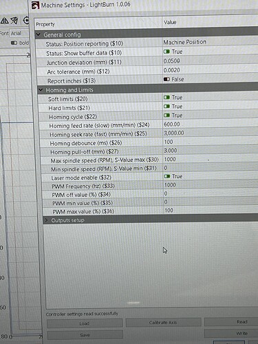

Neither of those things should be affecting your available workspace area. You may have an offset created.

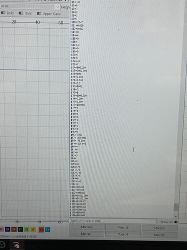

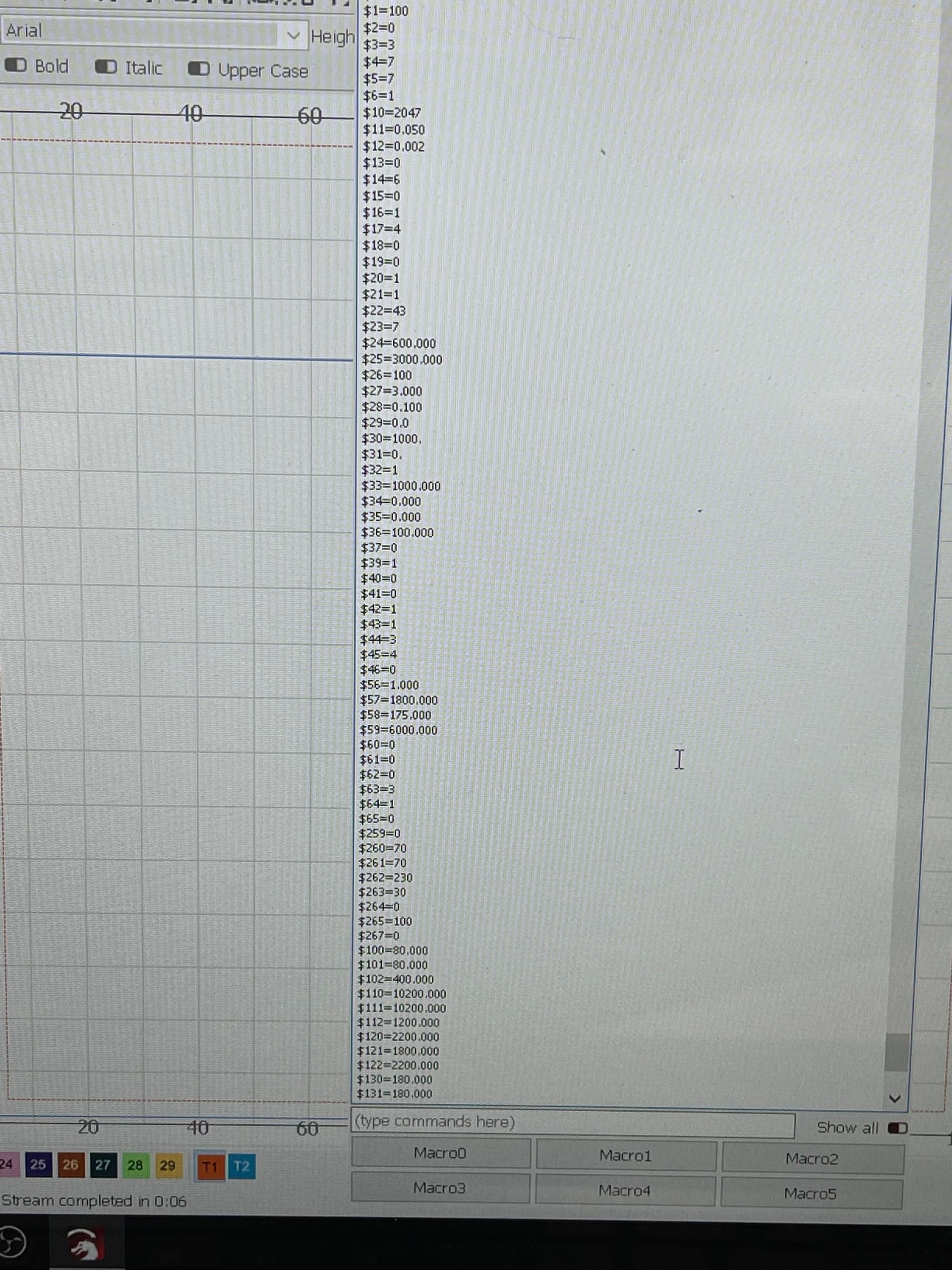

Can you run these commands in Console after doing a homing operation?
After all this is sorted you should think about updating your firmware on the laser as well. It’s a general recommendation from Ortur due to some recent changes.
