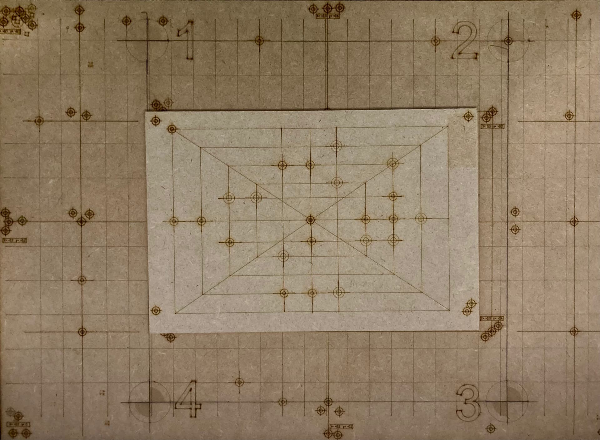

have a 16MP arducam on a 1.6m x 1m bed.
it’s a varifocal zoom lens, so i adjusted the fov to include all the sides with minimal extra margin.
the lid hinge is about a foot in from the end of the bed, so the camera cannot see all the way to the back. it naturally as a significant portion of visible space on top and/or bottom that is beyond the bed or blocked by the lid hinge. i can adjust the camera tilt if necessary.
this camera has significant barrel distorrtion so i selected fisheye lens
i used the april9 image with while posterboard covering the honeycomb.
it graded it ok and got valid images on the preview window. but this didn’t actually apply it. the update overlay is still fisheyed. in fact, the Align Image step that immediately follows the bdc cal still has all the uncorrected image
what’s going on?

my result was not that great. i made a couple of fiducials about 2/3rd of the way to opposing corners, aligned perfectly, tried some fiducials elsewhere but they’re off by as much as 10mm.
would it help to make a bigger april9 test image card? the 8x11 is pretty small on the bed overall
like i say, the camera fov doesn’t cover all the way to the bed’s top and bottom, so the test card shots went to near the fov limits on left and right but vertically they were far from the fov limit
actually, the errors I’m seeing are much larger in the x than y. is taking the shots near the fov edge where the distortion is highest making it worse overall?

ok, with april9 blown up WAY bigger… like 1/3rd the bed size, so with 9 shots it covers all the bed…
this compensation is MUCH better than I’ve ever seen! it’s perfect, like 1mm of error!!

Did you check for consistency all over? With smaller test cards, it seemed to accurately locate the cards, use them as reference points, and be precise where the pattern was found. But with large gaps between the 9 placements of smaller cards, it has to make wild guesses how to flatten there without having any actual reference data. So it aligned well near where the card features were placed but warped around between those spots.
I got fooled a few times thinking I had it precise, fine-tuned with resized and realign the XY for 4 points I just cut and took a shot of, only to find it could be perfectly aligned for those 4 points alone, but the rest of the bed, not so much. Got as bad as 3-4mm in the worst spots.
I probably noticed it more than most because of the 1600mm x1000mm bed size.
With the card cut from a large piece of board on the laser itself and placed in 9 places, huge april9 features blanketed the whole work area. almost nothing was far from where one of the many april9 corners was found.
