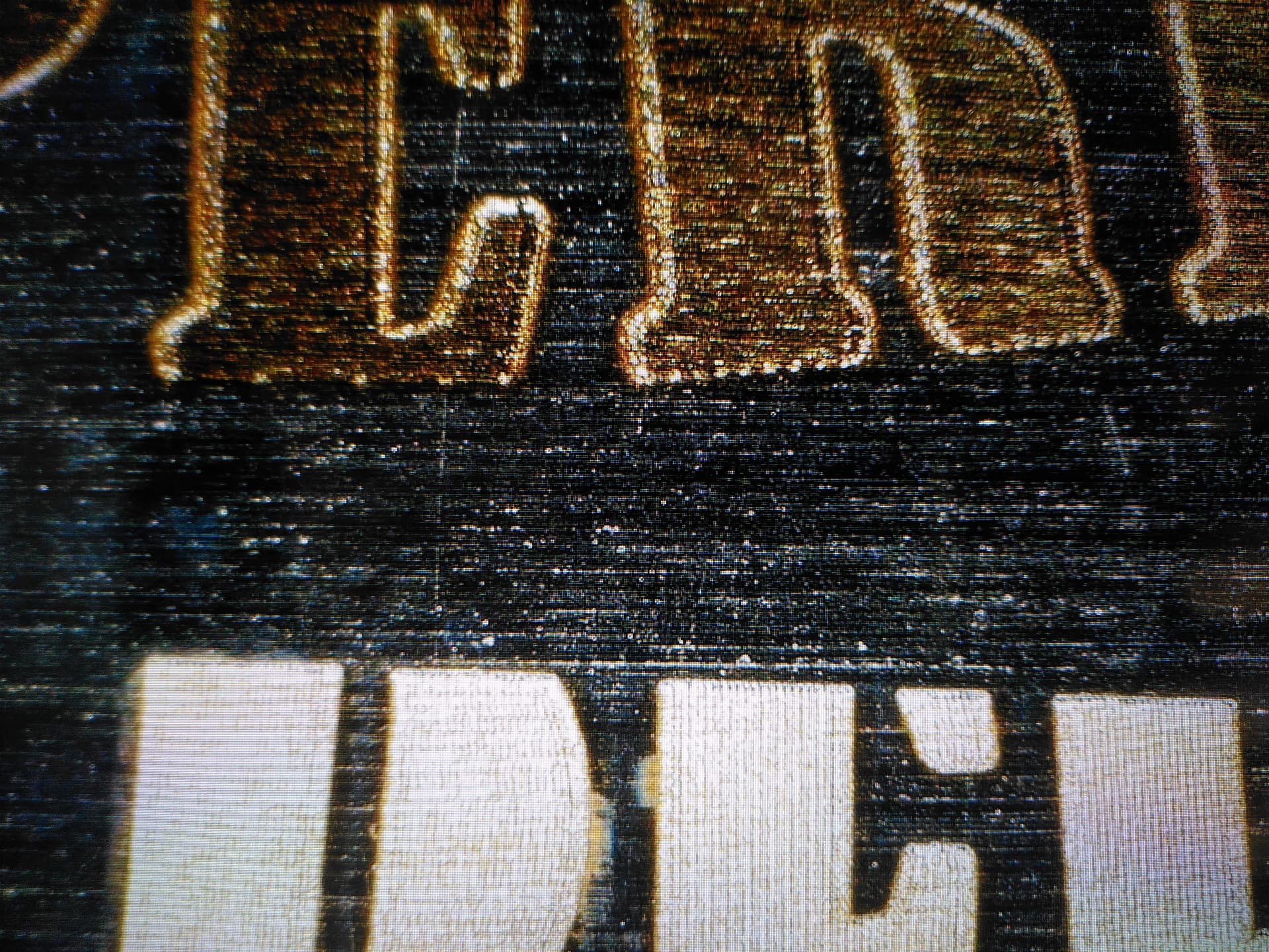

I am new to Lightburn, hope this is not a stupid question, however as it took me quite some time, hoping to get some insights, thank you!
After dialing in settings for engraving stainless steel on JCZFiber device, somehow suddenly the visual result for filled areas changed without obvious parameter changes. After long time reasoning what setting I changed, I noticed that I had switched off beginner mode. All obvious settings are the same (Speed, Power, Q, frequency, line interval, fill settings), except toggling the beginner switch, the visual result strongly changes (reproducible). In beginner mode I can see lines with some kind of aliasing pattern perpendicular to scan direction, in non beginner mode the fill is smooth, but power density seems higher (material color change).
I could not find out which parameter in expert mode would allow to switched back to beginner mode result. (e.g. it is not the “optimize cut path”).
Using 1.7.06 on Ubuntu.
Would be glad for insights
Edit: upper engraving: beginner mode OFF, lower: ON
The top is beginner mode on, bottom is beginner mode off? 100% sure no other changes?

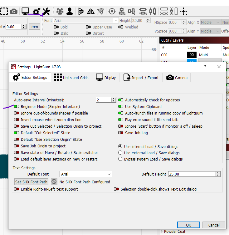

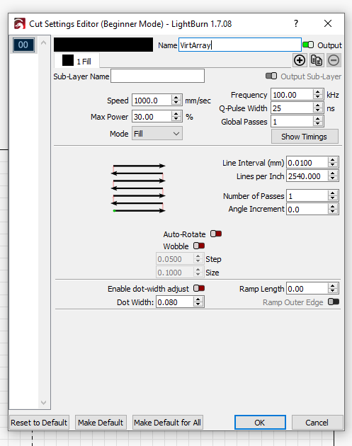

Here is the toggle.
Hey, yes exactly this is the toggle switch. The upper engraving (darker/more oxidised) is beginner OFF, lower with visible “dot pattern” is beginner ON. No other changes, just flip toggle, repeat job.
(I added a note to first post to clarify)

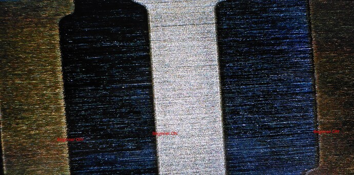

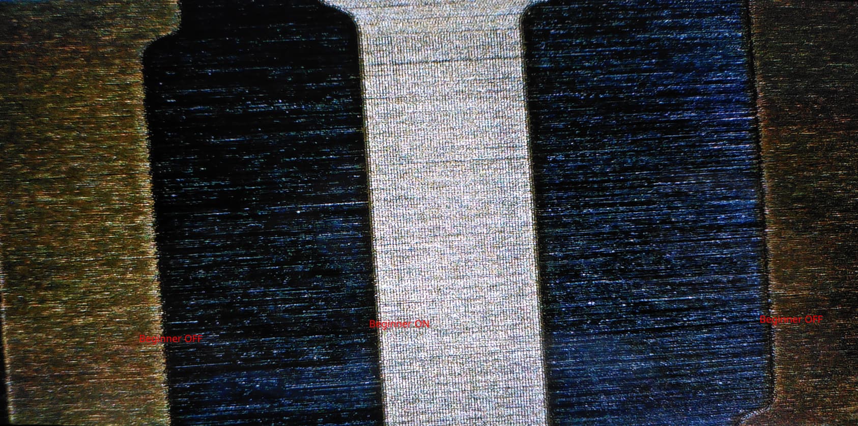

Thanks for your help. Unfortunately it seems not like this is the reason. I created a minimal test project.
test_project.lbrn2 (7.5 KB)
It only contains one Letter “I”.
I run this once (beginner OFF), toggle the beginner switch (ON) and move the stainless to a fresh spot (no changes to the project), then run again, then again move the stainless and toggle to OFF, run a third time.
Wow. I’m going to go try it. Appears you eliminated all the possible variables. Be a few minutes. What lens, what is laser max power?
210mm, 60W
I don’t believe beginner mode really helps and put in a feature reqest to eliminate it.
The response is that manufactures wanted a beginner mode.

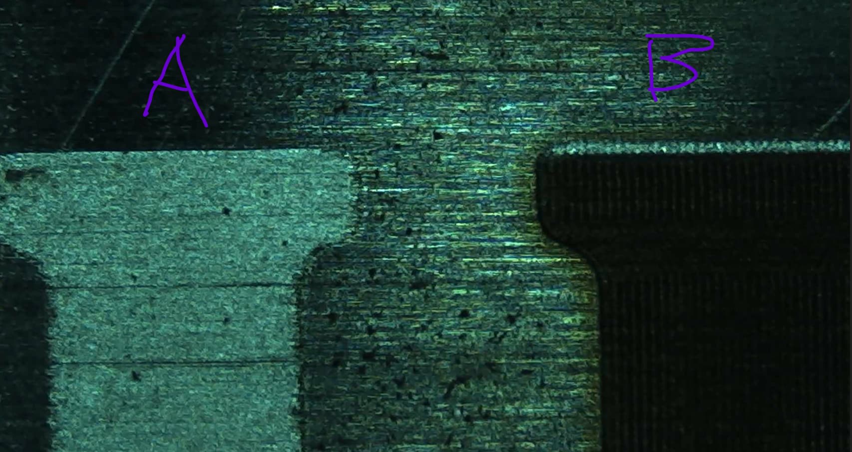

You are 100% correct, this is a bug.
Advanced/ Beginner

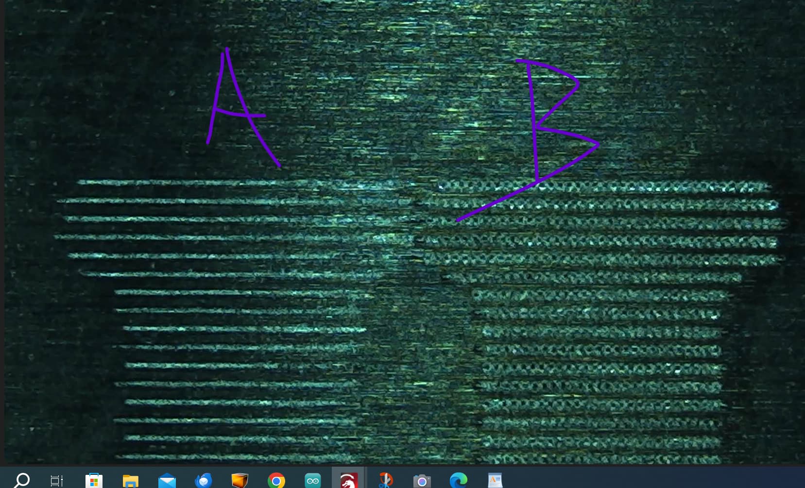

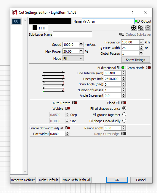

Spread out the scan lines to 0.1 LI. Looks like wobble is on on the beginner mode.
Cool stuff.
If you could change your title to “bug report- Beginner mode: Impact on engraving results” I’ll bet the boys and girls would like to take a look at this.
Never tried it before. In this case beginner mode adds wobble. Strange stuff.
Thank you very much for the quick confirmation, indeed very good idea to increase the line distance to check what is going on!!!

That is understandable. But there is a wobble toggle in beginner mode but it seems to wobble anyway. On or off.
