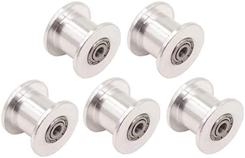

I don’t quite understand what you mean by ‘opposite extreme’. Can you explain that like I’m 5 years old?
I´am sorry, english is not my natural language ! sometimes i use the traslator, sometimes i try to write without it to practice
with “opposite extreme” i try to say the free pulleys, the other pulleys except the pulley of stepper motor
Something like this?
Yes ! this type of pulleys
