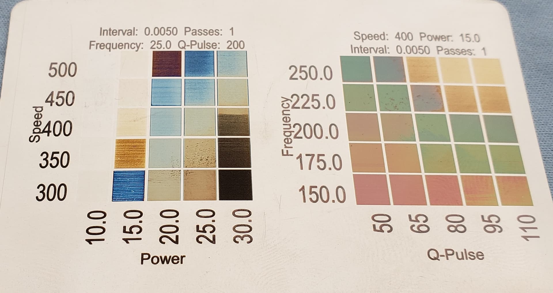

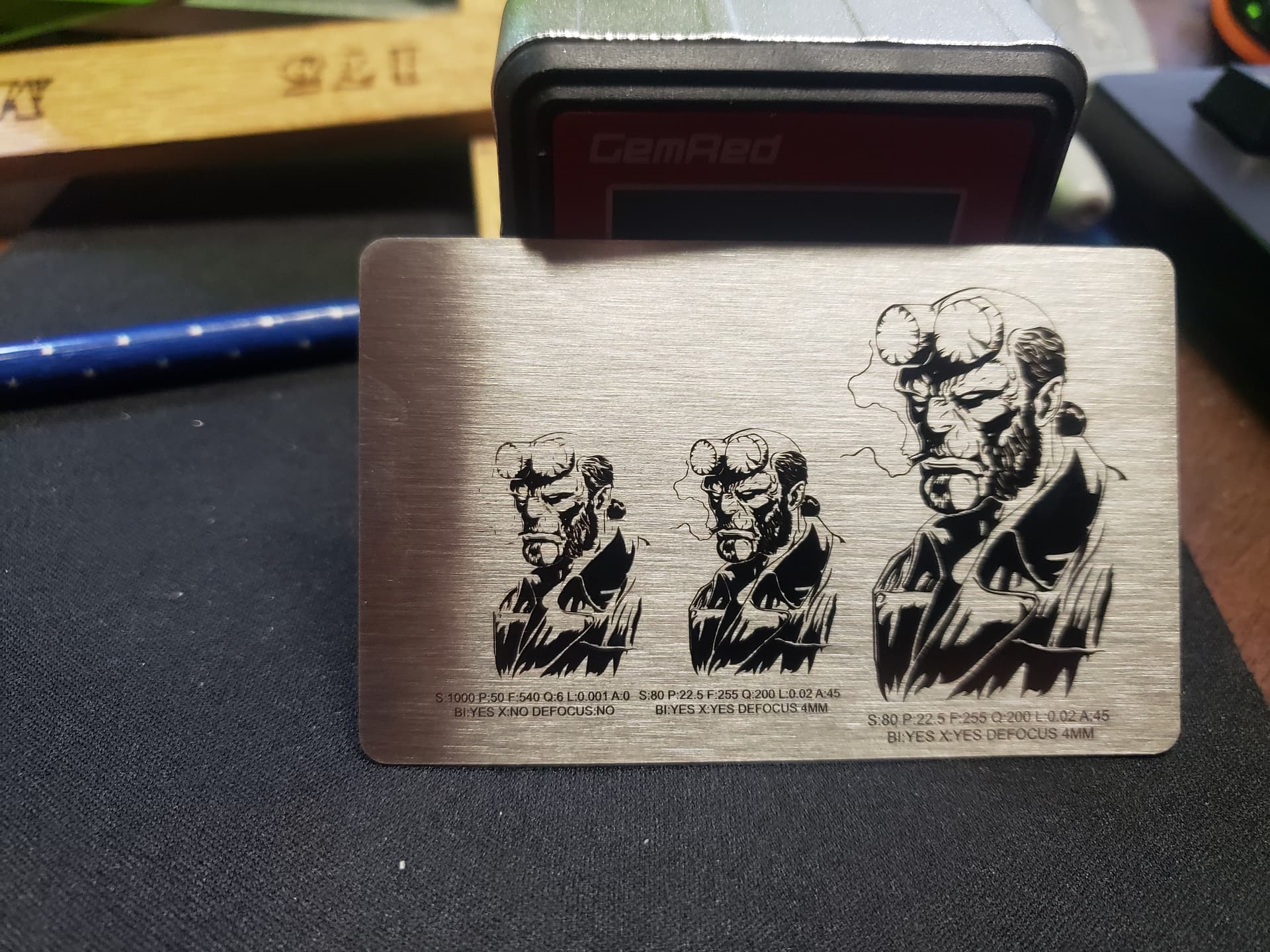

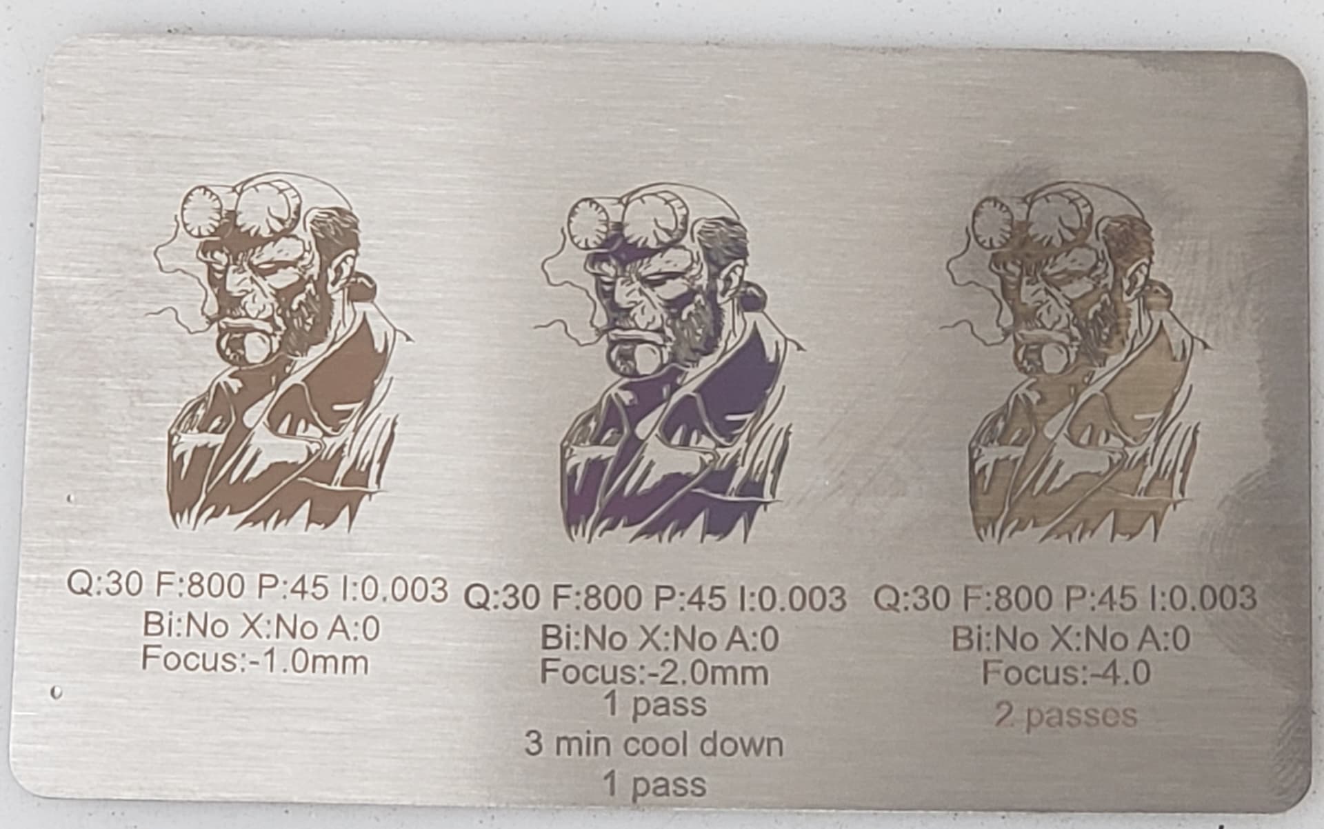

You didn’t mention what laser, but if it is a MOPA fiber, we have a lot of tests and parameters on stainless business cards on the Laser Master Academy. And yes, what is mentioned above, it is difficult to get color on a thin piece of SS without warping. And as mentioned above, changing from one ss product to another changes everything.
I even milled out an aluminum jig to hold the cards flat and absorb heat, maybe helped a little but in the end just takes a lot of testing.
