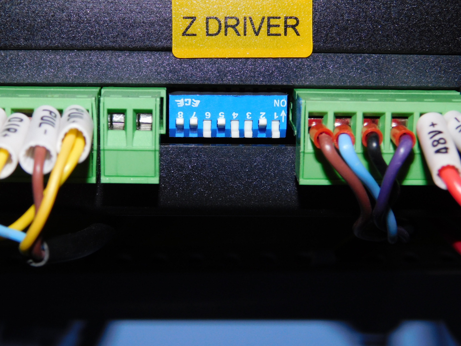

Thank you for your quick response. I think the k50 is more in line with what I have in mind. I have a full spectrum pro 3648 but am very unhappy with the program that must be used with it. Hopefully I will be able replace the controller someday with one that I can use lightburn. I am looking for a smaller unit to use for smaller projects
I keep telling people I don’t read minds, then demonstrate the opposite. :slight_smile: (lucky guess)
Send some pics of the controller, electronics, and wiring that’s in there and I can take a look.
Thanks for any help you can give
Ruida or Trocen is an easy swap for FSL Pro series lasers.
If that laser is working great and you just hate the controller/software, I would put your money into buying a Ruida controller and swapping things out versus spending money on another laser that is small and limited.
Sorry about confusion I am not getting rid of my fsl and I plan on getting a different controller for it. But the only info about compatibility I have been able to find was someone changed over an old hobby series fsl. I have yet to see anything on a newer pro series fsl. If anyone knows of someone or a link to information about it I would really appreciate it. I was asking about a smaller system because I wanted the ability to run more than one job at a time and l don’t intend to give fsl another dime. I would like to run lightburn on both machines to keep things simple.
Here are the other pics and the black box is going to the laser pointer
It should be relatively straightforward to switch that system to a Ruida or other supported controller. I say “relatively” because it depends entirely on how comfortable you are with wiring and following the diagrams involved - I’ve done this a number of times, so while it’s a bit finicky and time consuming, it’s not “hard” for me.
The wiring is likely going to be the easier part, and setting up the machine configuration will take some time and some trial and error - homing settings, limits, step sizes, speed settings, and so on.
