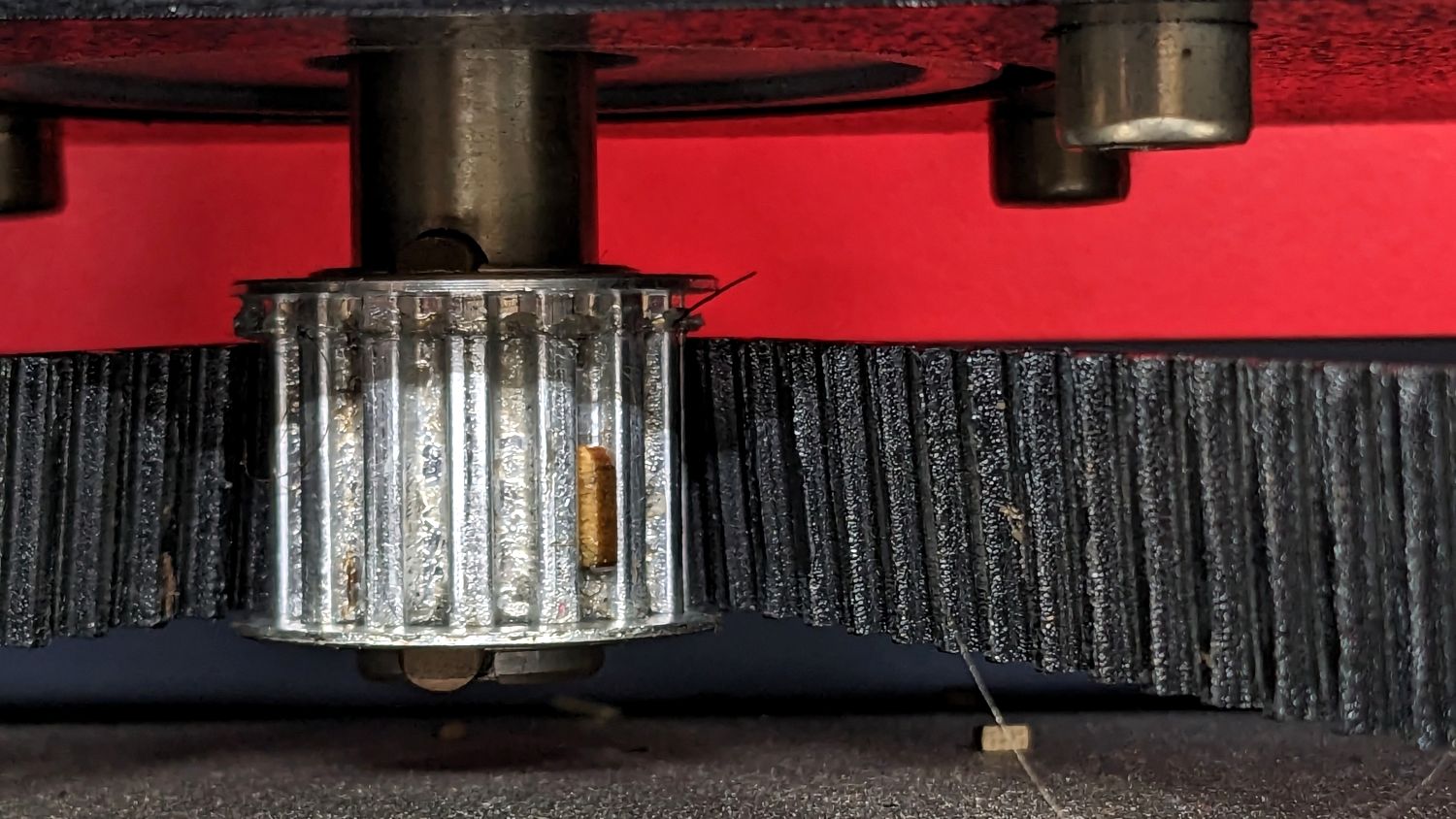

That’s basically the setup in my OMTech 60 W machine:
The hulking NEMA 34 stepper motor (on the left) drives a continuous 15 mm wide belt around the four leadscrews at the platform corners.
Each leadscrew has an upper bearing, but they seem to be sufficiently warped that the platform moves in a gentle 1 mm circle as they rotate, so hitting precise XY locations at different heights doesn’t work well. :slightly_smiling_face:
Because the Ruida controller cannot home more than a single motor, using one motor with sufficient mojo to raise the platform seems more practical than hacking anything with multiple motors. That motor will require a much wider belt / pulleys than the skinny ones found in small lasers & 3D printers, plus dramatically higher belt tension to avoid skipping (even without debris in the teeth):
