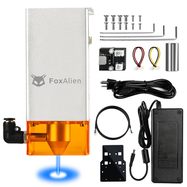

These marks look like they might all be out of focus. FoxAlien lists the focus of their 80W module as 40 mm — based on their diagram it looks like that should mean 5 mm between the shield and the surface of your material.
