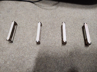

Better grip magnets
Magnets 30mmx10mmx3mm. Inside magnet glued to the wood.
They are magnets with a better grip that can be increased with engraving on the sides,
10
they can be stacked,
11
You can increase the power by placing one or two magnets on top,
12
You can increase the height by placing another magnet underneath,
13
The groove is used to insert a stainless-steel wiper blade to work as hold down that can be bent to fit at one end so magnet stays away from the laser head.
14
Countless possibilities…
Use your imagination. You have a laser!
