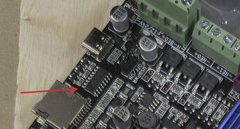

There are thousands of CH34X driver downloads on the internet.
The original source of this driver is WCH-IC, the manufacturer of the USB-Serial chip on many PCBs.
That’s this 16-legged IC here: (Makerbase controller board):
It also exists in a smaller package but is usually close to the USB port.
The manufacturer of the controller board should know exactly which driver and version needs to be installed.

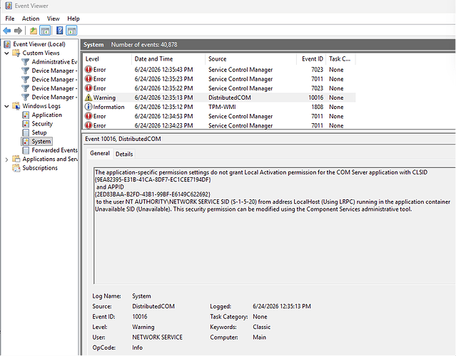

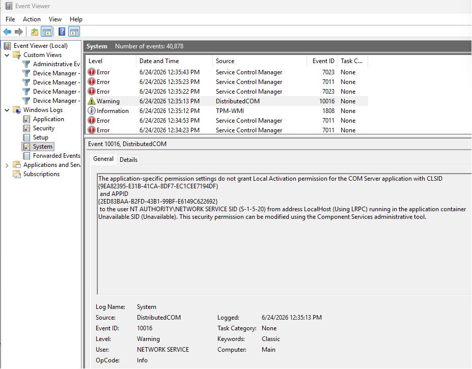

Have you looked at the event viewer to see if there is anything that happened at a certain time?
Not really. So, now that you mentioned it, I went and looked. Bunch of warnings and errors for about 15 minutes or so during the update. Does this look like it might point to whatever was causing this? It’s the only one that says COM. Whatever it was is fixed now, though. The device was showing up under USB on the first day, and failing repeatedly, then the next morning (or whenever) it suddenly showed up under Ports, and all was fine from there on out. No idea how this happened.

The Event ID 10016 is about DistributedCOM (Component Object Model). That’s unrelated to the serial COM port
