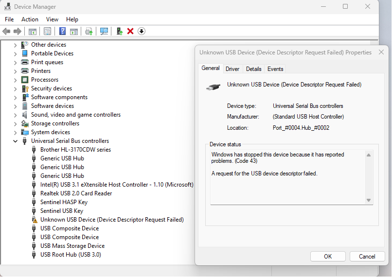

Today Windows 11 did a massive update. At the end of this update, my Omtech K40+ could no longer connect to my computer. Although I do run Lightburn, this is definitely a WINDOWS issue. In the Control Panel/Device Manager, the formerly “just-fine USB link” fails. Here’s what it says:
Unknown USB Device (Device Descriptor Request Failed)

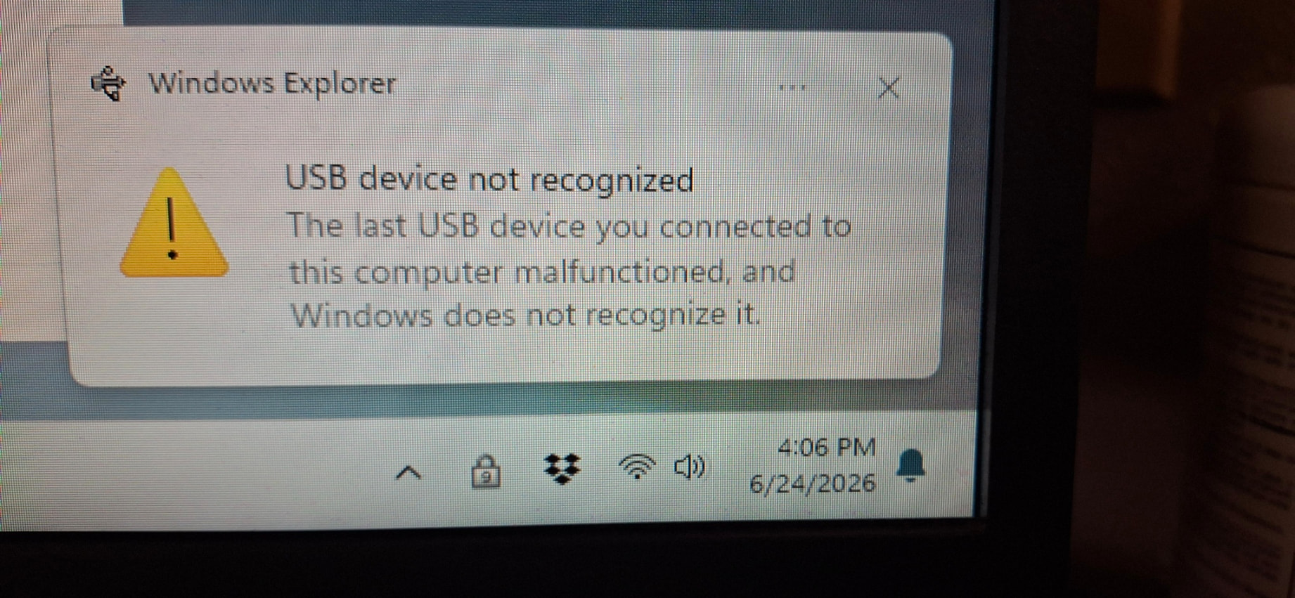

Before the update, everything was just fine. Afterward, I’m dead in the water until I can figure this out. The second I flip the on switch of the laser, this is what pops up in the system tray.

Thank you for this, although it doesn’t seem to have made a difference for me in this case. Omtech Support has been working with me on this since yesterday evening, but a remedy hasn’t been found. Their latest driver continues to fail after this Windows update. For some reason I don’t understand, Windows itself is severing contact with the machine. I have no idea what a Code 43 even is, nor do I understand this request for the USB descriptor. It seems to HATE this driver, LOL.

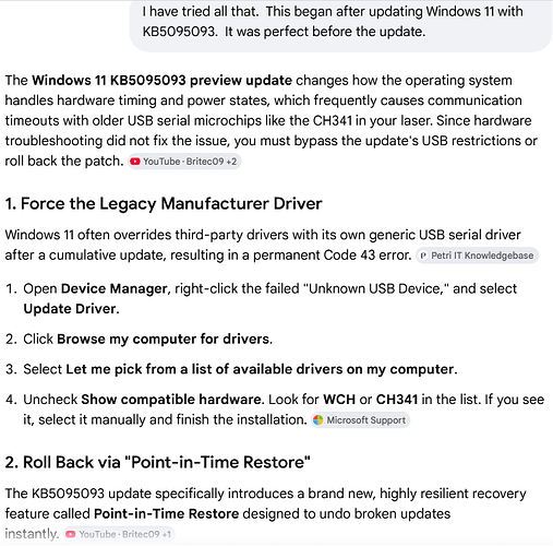

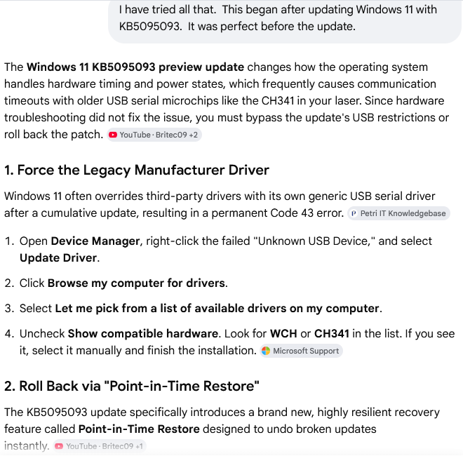

Looks like it’s “roll back” time on KB5095093 for now. Unless…

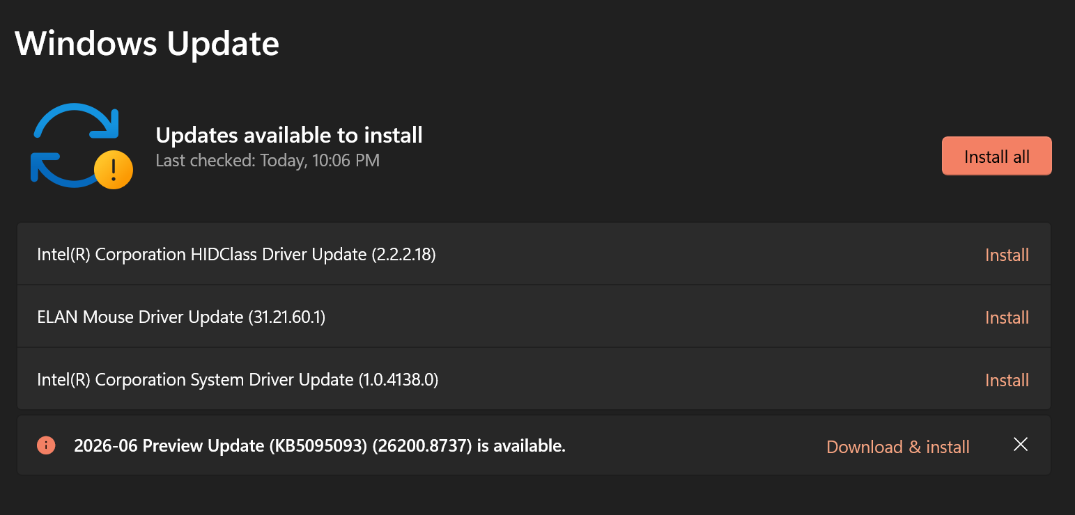

Two days ago, I also saw these components.
I was worried that the Intel “HIDClass Driver” could potentially bork something COM-port-related.

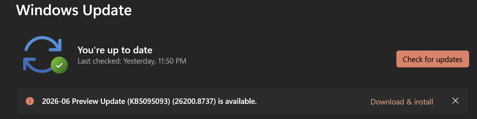

I’ve read the changelog of KB5095093, but didn’t spot anything related to USB drivers, so I took this screenshot and installed the update.
The one CH34X device I’ve tested after the install connected without issues, but now I see that KB5095093 didn’t install after all.
