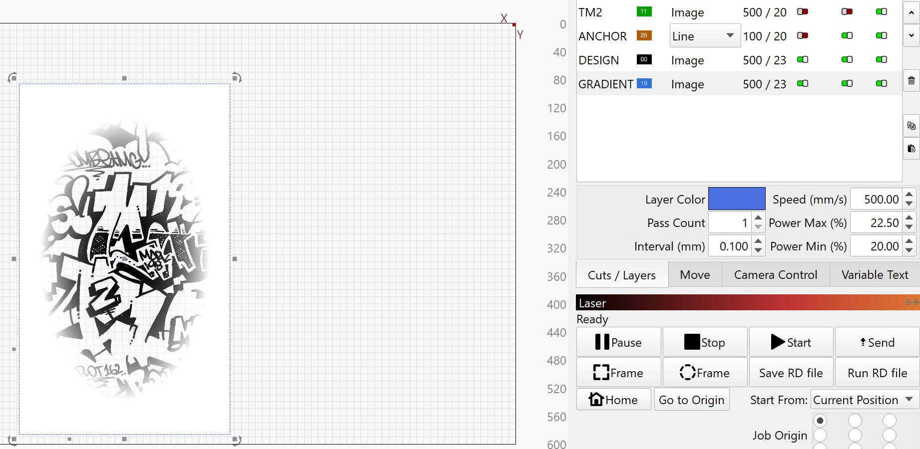

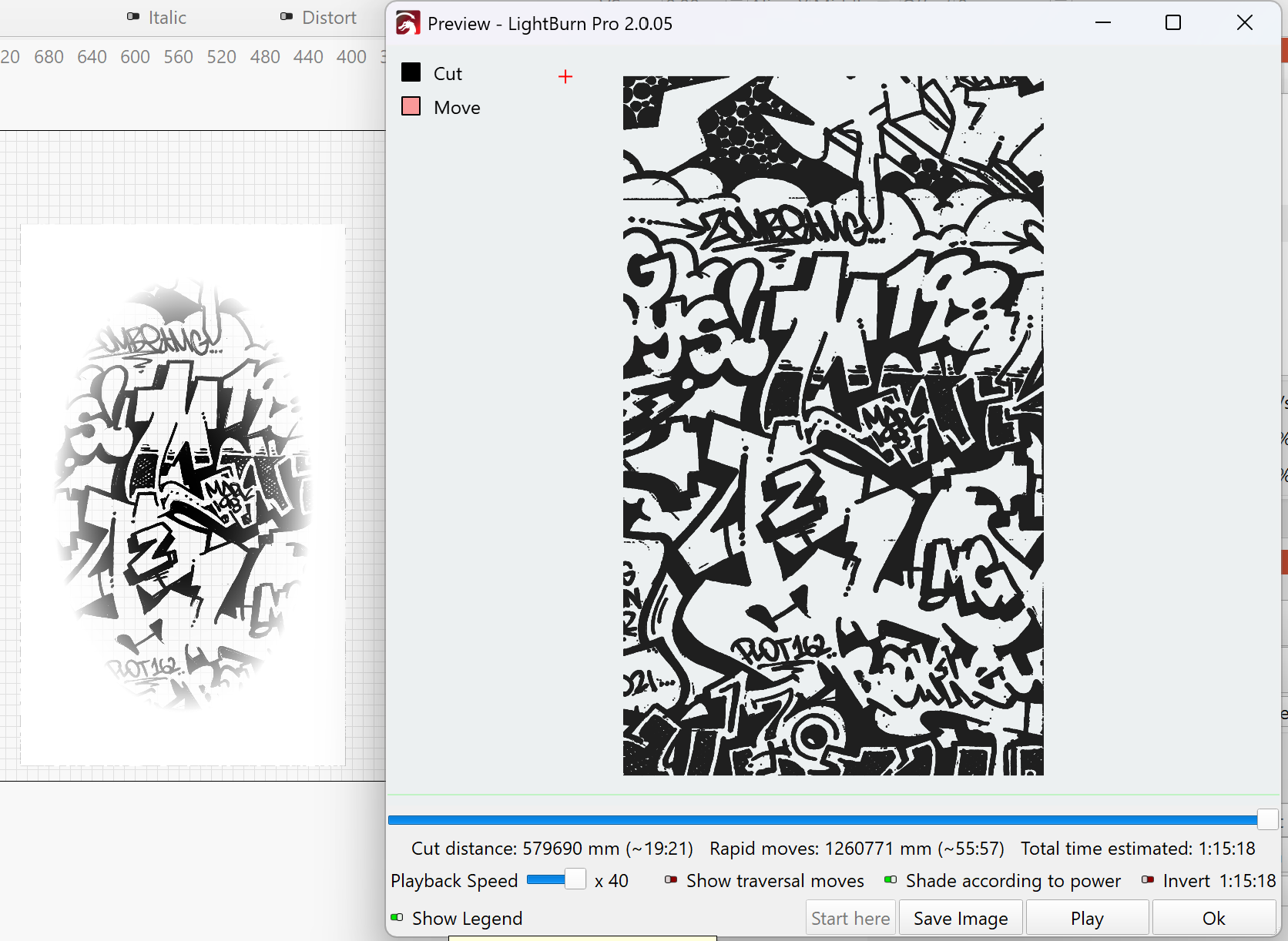

Hi team,
As there are no vector gradients in lightburn, i have tried creating a white-to-transparent bitmap mask and placing it on top of my original graphic. I am hoping to acheive a design where it engraves the black and not the white, with the power decreasing from black through grey to white, with white being 0 power/no marks left.
I am doing it this way as i want to hold the position of the print that has already done one pass, then do more passes in certain areas of the design with a feathered edge, so that the areas with multiple passes do not have a defined hard edge showing the differences in depth/colour in the end result.
I am engraving on an object that is not flat and need to change the height of the bed for certain areas. if i don’t mask it off, the laser head will hit the object being engraved.

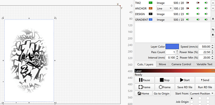

Here is a screenshot of the bitmap mask over an area of the design with the design masked to only the area where the white fade is.

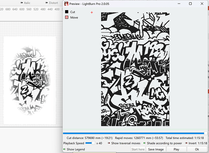

Here is an image of how this shows it will engrave (all of the white is disregarded)

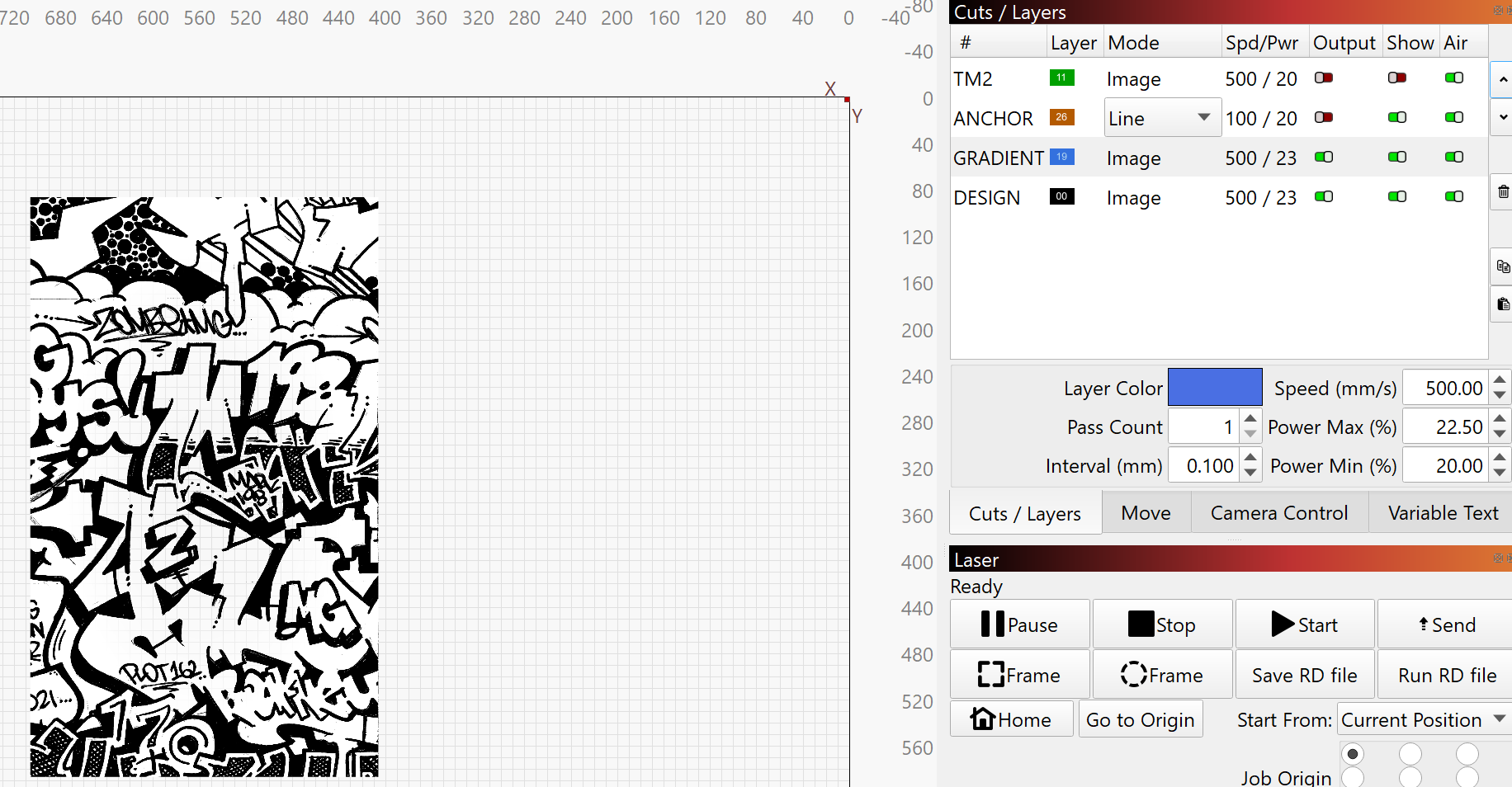

When i move the gradient to the top layer, it is not visible at all, even before clicking into preview. (i tried using illustrator/photoshop layer order logic to see if this was the problem)
Running with the theme of using illustrator/photoshop logic, i have tried to select both bitmap layers (the design and the gradient mask) and merge/flatten the two into one layer however i cant seem to find a process for this.
What am i doing wrong or what can i do to achieve my desired outcome?
Thanks in advance!

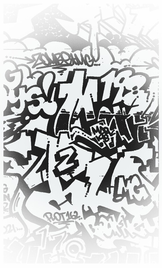

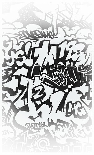

I took the liberty of downloading and editing the image (using the “preview” image you posted) and applied a filter with PhotoScape.
Try this image to see if it works better.
What I think might be happening is that LightBurn is overlaying one image on top of another.
But the laser power settings (max 22.5% and min 20%) seem too close to achieve the desired blending effect from dark to light.
White usually is ignored along with transparent, so I’m hoping the mask goes from black to transparent with transparent being equated to white.

You actually have both of the images done with the same power level.

It’s worth stating that layers in LightBurn never affect each other. LightBurn layers do not “paint over” each other like they would in a design application.
To make this work you’d need to export the graphic as a bitmap and embed the transparency (or color fade) directly into the bitmap itself.
