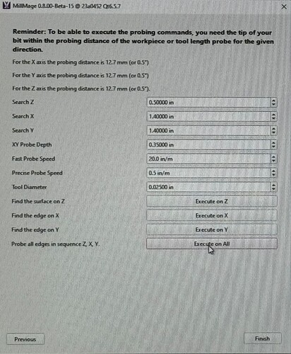

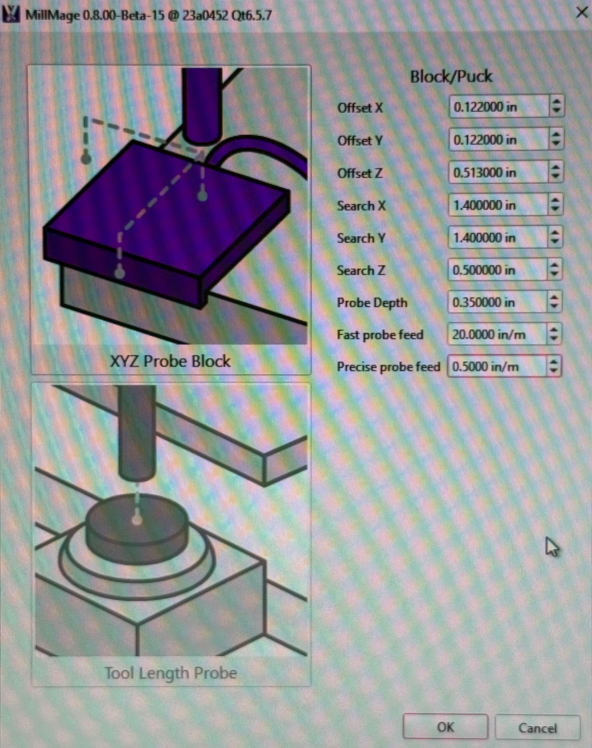

BitSetter Probe Configuration
I’m using a BitSetter V2 and only using side taps for X and Y zeroing.
Below are configuration screens that work for me to see XYZ zeros.
Shapeoko owners, let’s get MillMage up and running for all configs!

Bitzero? - Setup the block in the probe wizard and ignore the hole. - XYZ/Puck Probe Block - MillMage Documentation
Bitsetter - Setup the tool length probe and enable it - Tool Length Probing - MillMage Documentation

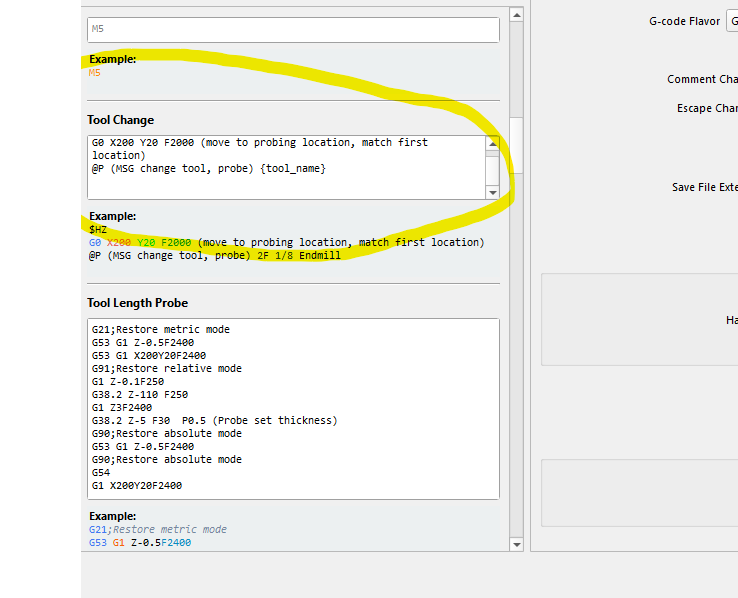

Tool Changes - Enable these in Device settings
and add something like this to your Tool Change block
;Tool Change Script
M5                                 ;Turn Spindle off
G53 G0 Z-2                   ;Lift Head to top of Z
G53 G0 X-300 Y-600    ;Move to front of machine to present tool
M5                                 ;Make sure its really off
;Millmage specific message script. This will cause an error in other senders
@P Please insert tool #{tool} {tool_name}
After that, run a multi tool process in one go. It should just work. The process isn’t hard, but it’s complex and we haven’t documented it well yet.
i do jobs with multiple tool changes in a lot of my jobs , normally 3-4 in the operations tab i drag them into the order of how they are to run, when it is time for the next tool MM will come back to my tool change and probe position and a pop up will appear on screen telling me which is my next tool i need to use. Putting something like this in here brings the popup on screen
you don’t need to manually keep track of it MM does it for you, pre running the job run the preview it even shows different types of tools during the preview . yes it does take a little setting up custom g codes but once its done it all runs seamlessly, i really enjoy i can do everything inside MM
