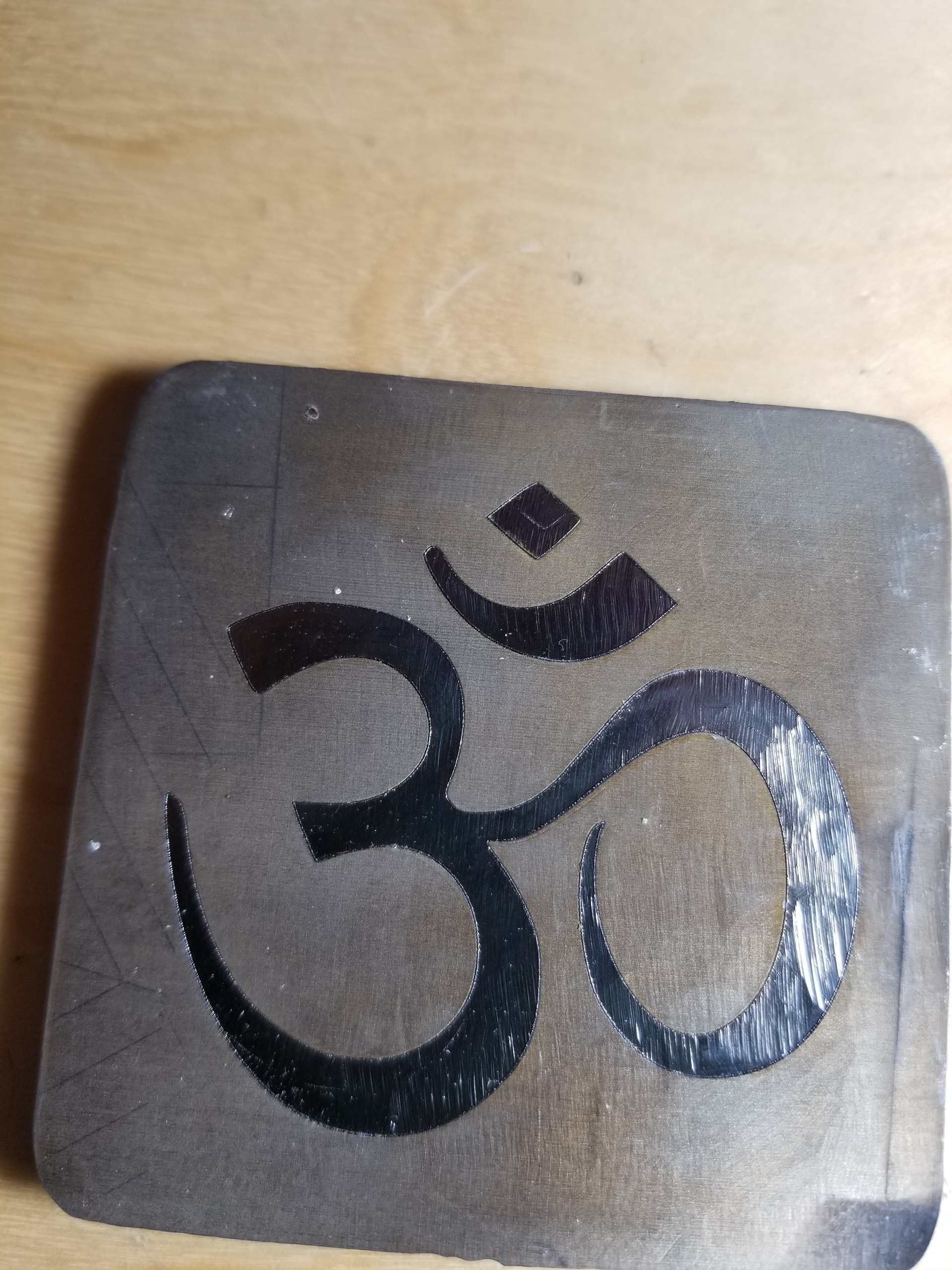

CerMark. Small can is about $20 Amazon.
I have some steel parts that I have managed to create black markings on.
It’s sanskirt for OM, first sound made, supposedly. It’s on steel that’s about 1/2” thick.
Unfortunately I corrupted my source file disk along with the backup disk, so I can’t tell you what settings I used.
I’d fine a bar of the same material and see what you can discover. I believe it was a lower frequency and a long q-pulse, that’s about all I recall.

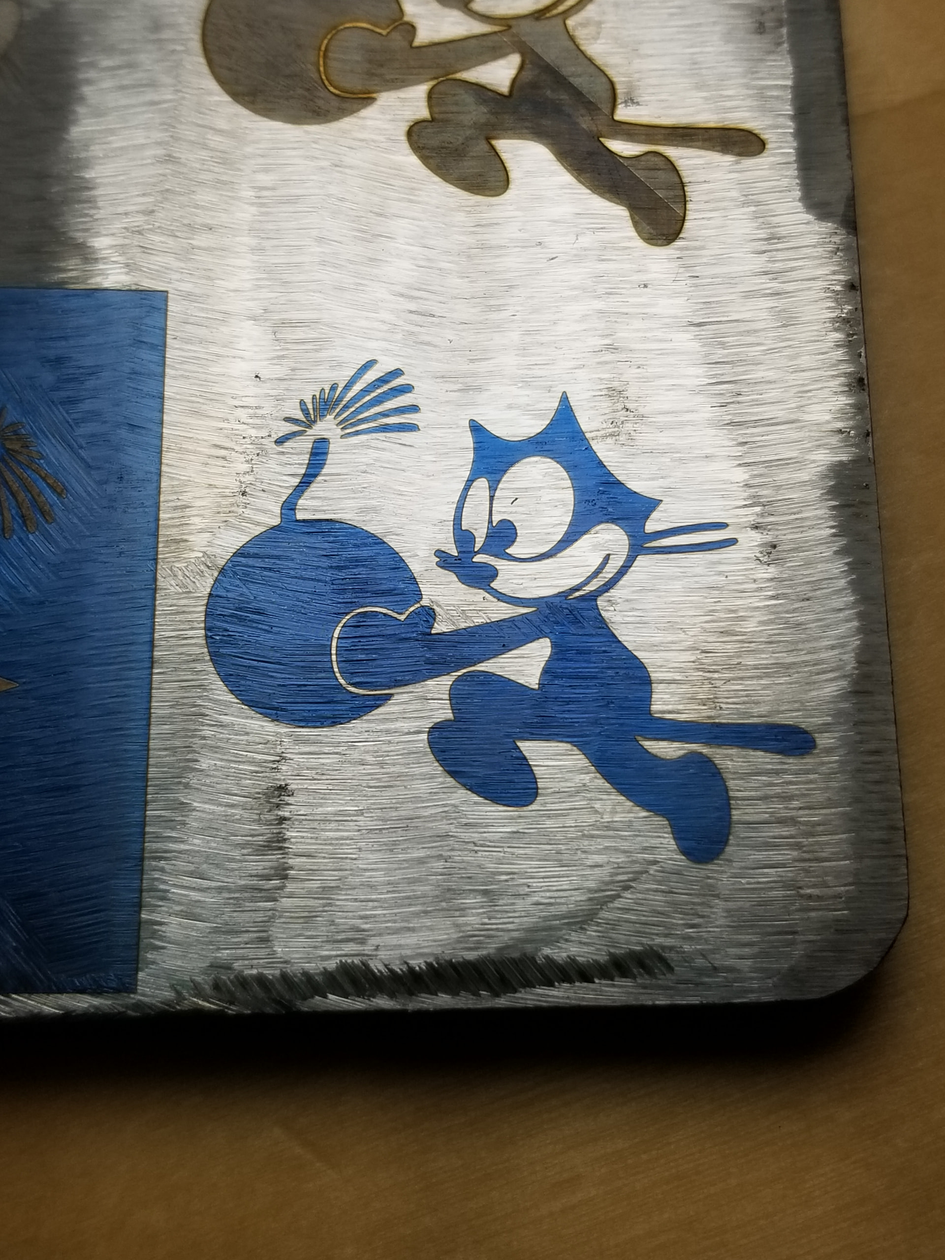

This is another piece of the same scrap, there are limited colors available with steel.
