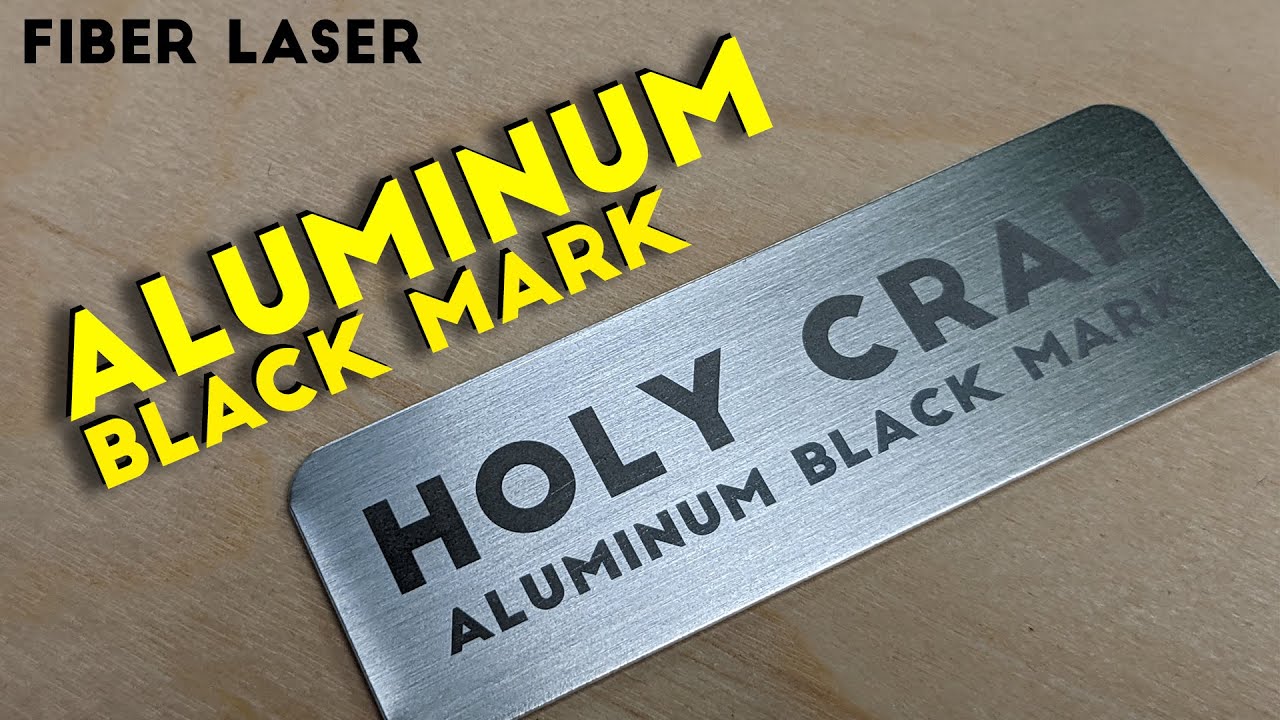

I’ve done little aluminum, just don’t have much if any laying around to mess with.
Laser Everything has a free library of settings including a dark on aluminum.
You can see, on the right, it’s from aluminum → general → dark in the library. Also it’s for my F254mm lens.
Laser Everything has a short video on dark marking aluminum. I remember seeing it, just couldn’t find it.
Unfortunately they use Brilliance marking spray. About 6:04 in, is a comparison from his fiber with/without … Might be worth check the comparison and see if it’s similar to yours. You might be stuck with one of the coatings…
