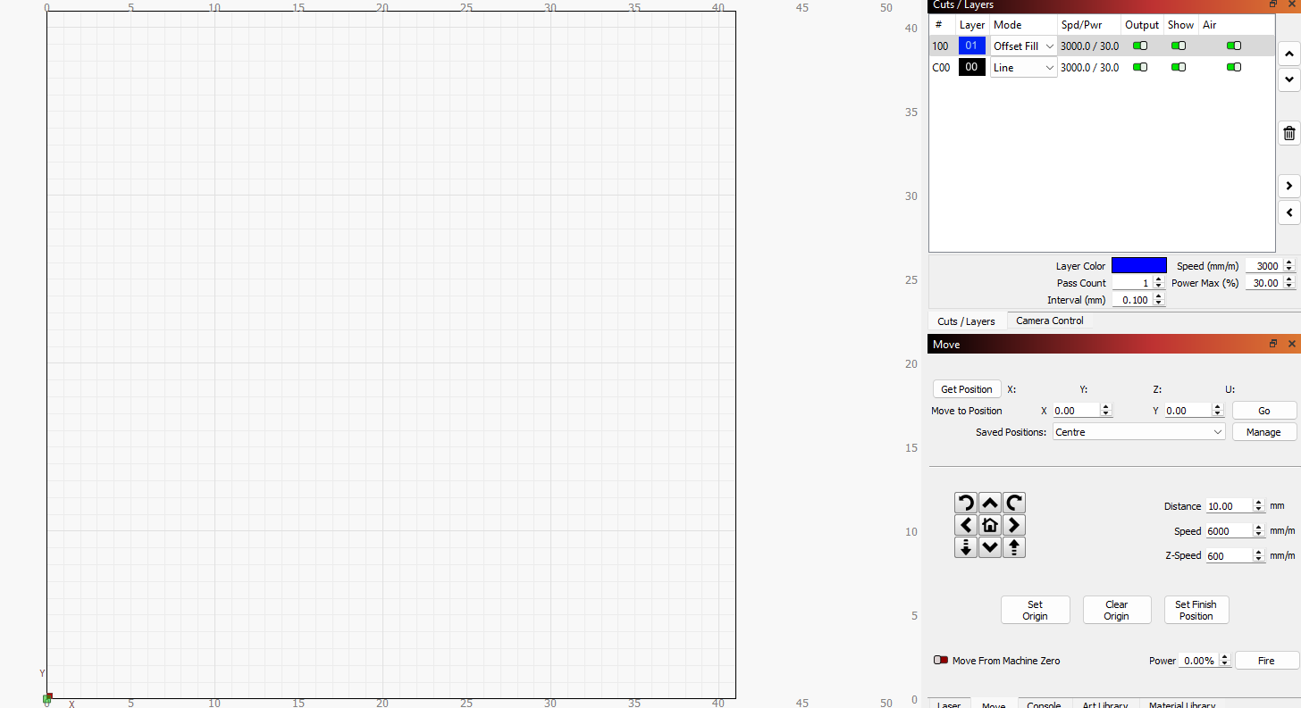

Hello, I have an issue after installing the latest version 1.7.08. All Lightburn files are blank, and after opening them I see blank also on previous version of LBN, and those files are corrupted. For the moment I reinstalled the old version but I’ve lost some of my files. Anyway I see the dimensions of blank files are the same (i.e. 198kb vs 198 kb) of previous working files.
I didn’t change anything, settings or machine, pc, etc.

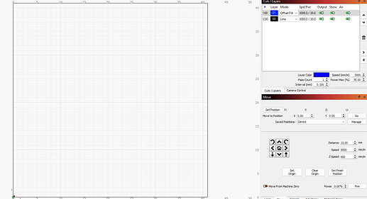

Not the OP but I came to the forum to say the same thing happened to me on upgrading Lightburn to v1.7.07. Just updated to v1.7.08 and the problem is the same. I also tried downgrading to v1.7.00, which was the version I made the files with and still the same issue.
Screenshot below shows the issue. The layers window shows that the layers are still there, but there is nothing in the grid area.

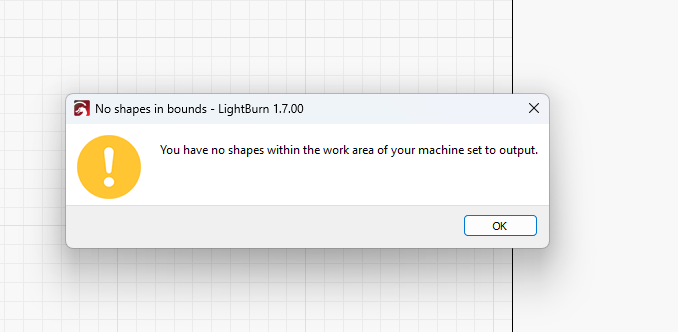

If I try to burn the pattern anyway, I get this error:

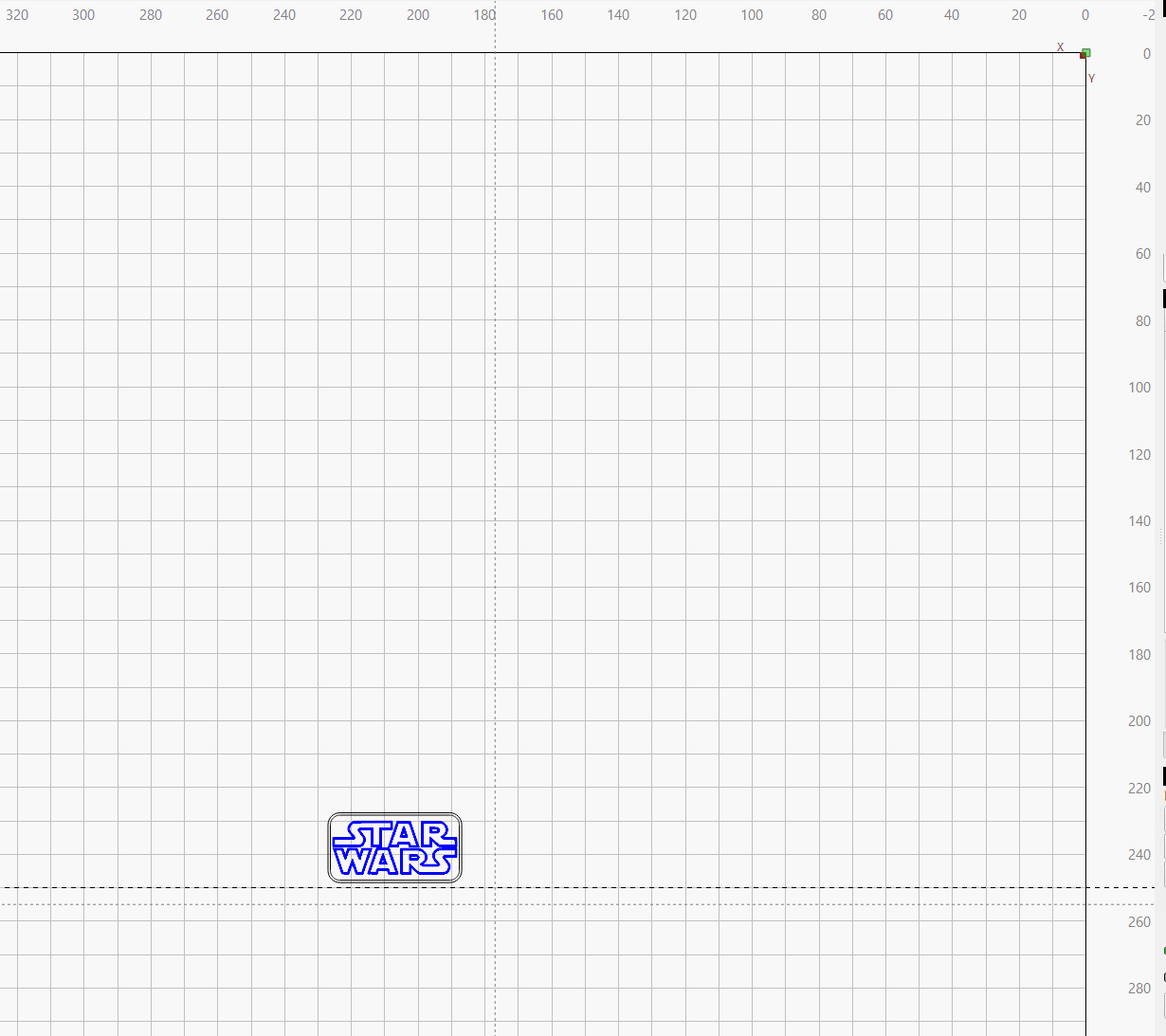

Have attached a sample file (this problem is affecting every single one of my files). The file should show the Star Wars logo on the engrave layer and an outline on the cut layer.
The .lbrn2 is stored locally on my laptop, but in a folder that is also backed up to OneDrive.
Sample file
SW logo.lbrn2 (56.7 KB)
Like this?
Your screenshot shows a workspace grid about 40×40 mm, which seems very small. According to the description, the workspace should be a little under 400×400 mm.
I think if you correct the workspace size, the logo will show up where you expect it.
Restoring the LightBurn preferences from an automatic backup made before you did the update should solve the problem and, perhaps, eliminate any other problems:
Amazing! Was hunting through all the setup menus, I totally missed the really obvious thing staring me in the face. Thanks for the quick reply, can confirm that resizing the workspace once has now solved the issue in all my saved files. Thank you so much.
I’m using an iKier laser which has an engraving area of 410mm x 410mm
