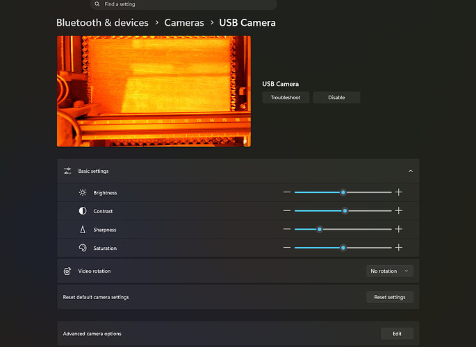

More evidence…
its connecting in windows camera ap..it is even working in cutlab x which is a horrible software because it doesn’t have the features i need and it keeps crashing.
have the features i want.
As you can see its working fine in windows

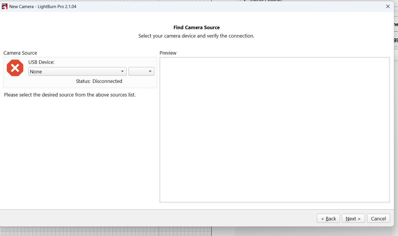

Ok, please do this…
  1. Delete or remove all cameras from Lightburn.
  2. Click on Add Camera and select USB.
  3. Now screen capture (SHFT+WinKey+S) what you get like the image below.
  4. Drop that image in your reply
P.S. My window is empty because I have no camera connected for it to find. Click on the pull-down before doing the image capture.
Tried that multiple times…But in the end what i had to do was download a very old release of lightburn. 1.5, which is wayyyyy back from 2024. camera works now.
Thank you for your assistance, it was greatly appreciated. I will not be able to use 2.1.04
Please do not give up. I am sure the Lightburn developers would like to know what is going on. And me too because I bought a dirt cheap USB camera and it is working just fine. I even added a desktop document USB camera the other day.
