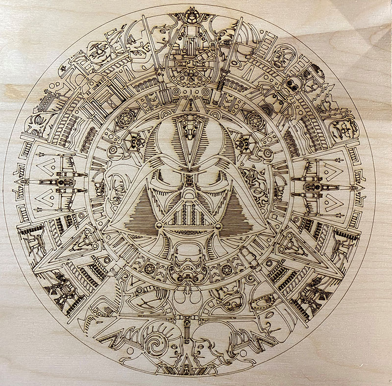

I have an MPCNC running the mini Rambo board with the Marlin firmware that I’ve added an Endurance 10w to. I used the laser successfully in lightburn to draw a fairly complicated Star Wars Aztec calendar. Looks incredible. Now I’m trying to learn how to do photos. I get this weird blurring when trying them. I got a few answers to a post in the FB Lightburn group that say don’t use Greyscale, use Jarvis. Well that didn’t work either. In an old lightburn forum post I found directions on downloading and converting images from public access museum sites. Same problem. I’m wondering if my settings are wrong. I tried doing the $$ at the console that i saw in that post and lightburn shows unknown command. Maybe because that was a GRBL the poster was using?
