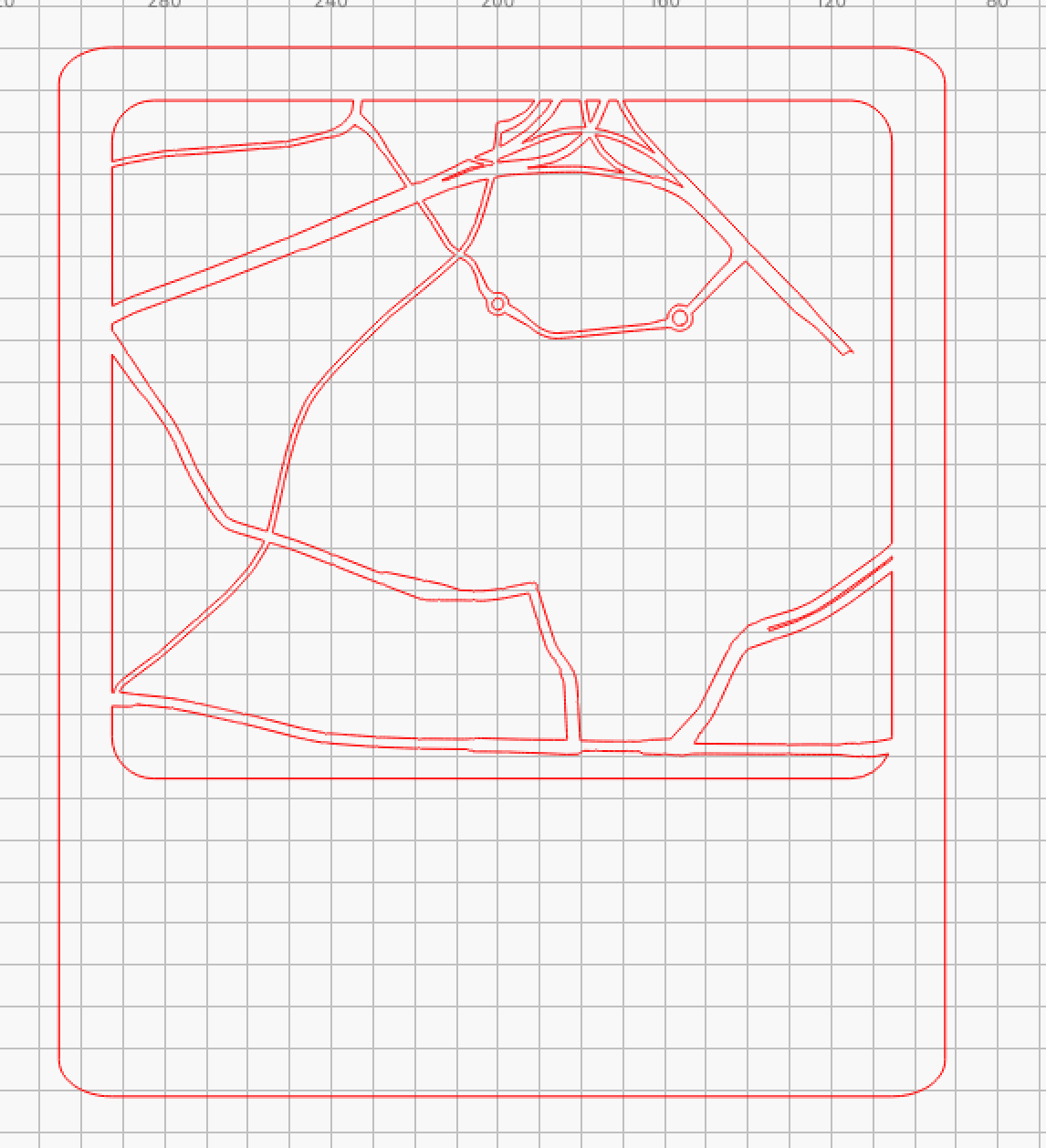

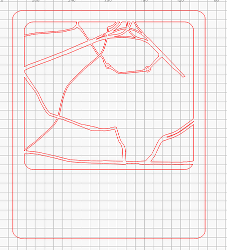

You have several open shapes in your center shapes. Boolean only works with closed shapes. After fixing your open shapes I was able to get this result.

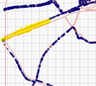

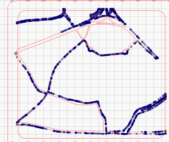

I used a few methods to get there. First, ungroup. Then Edit menu> Auto Join Selected Shapes. That took care of some of them. Next, click Node Editor, click on the perimiter line and look for the green squares and adjust them to connect the lines. See here, the line is not connected. There are 4 disconnected segments here. Zoom in and adjust the green square until it connects with the remaining unselected line. Don’t forget to close the last spot. Click Edit> Select open shapes to identify the other open shapes. Rinse and repeat.

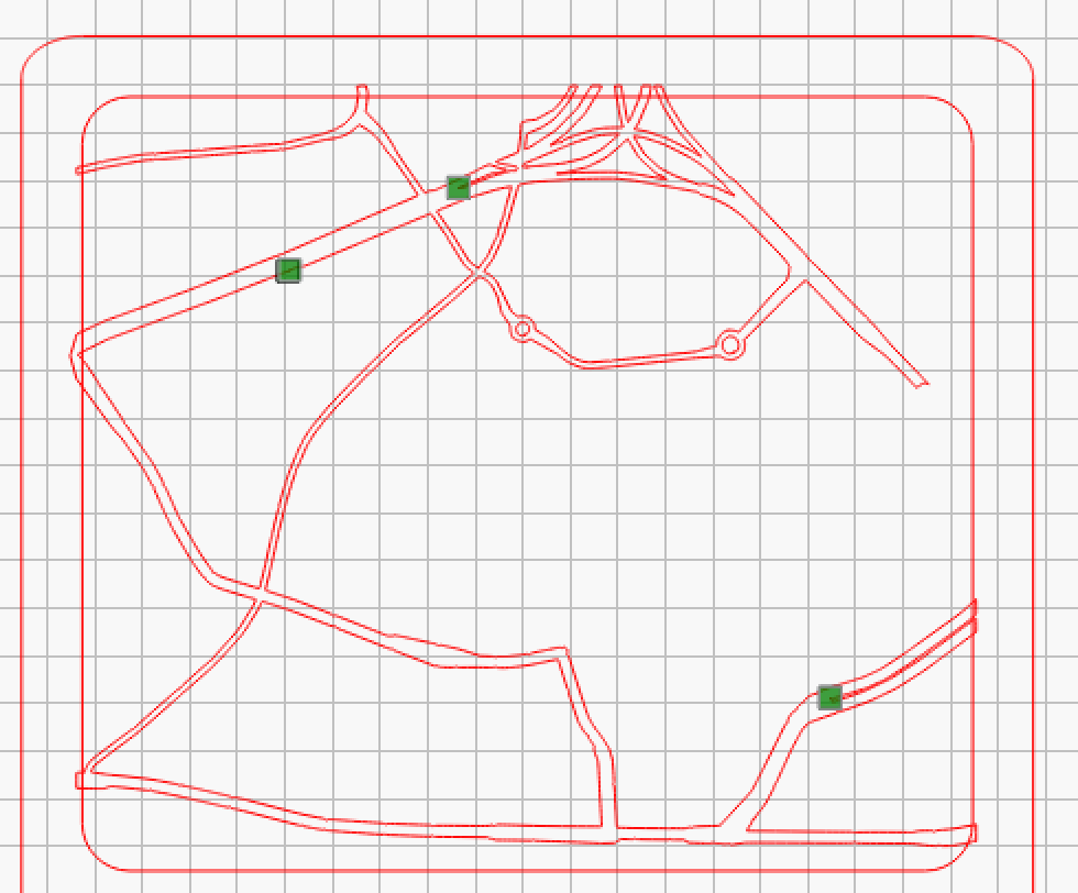

There are also a few random shapes that should be deleted. These green boxes are random line segments that should be deleted.

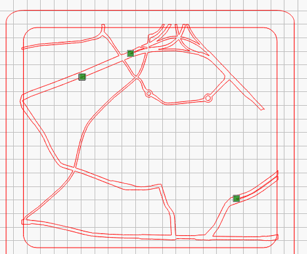

Hi Tim, I really appreciate all your help and I think you’ve explained it very well, but after 2 hours, I think I’m over thinking it. I see the green squares (see pic) but I tried clicking on them and dragging them and it doesn’t work. I’m extremely computer savvy but as I said, I’m probably over thinking this. Any other assistance you can provide is greatly greatly appreciated. Thanks
