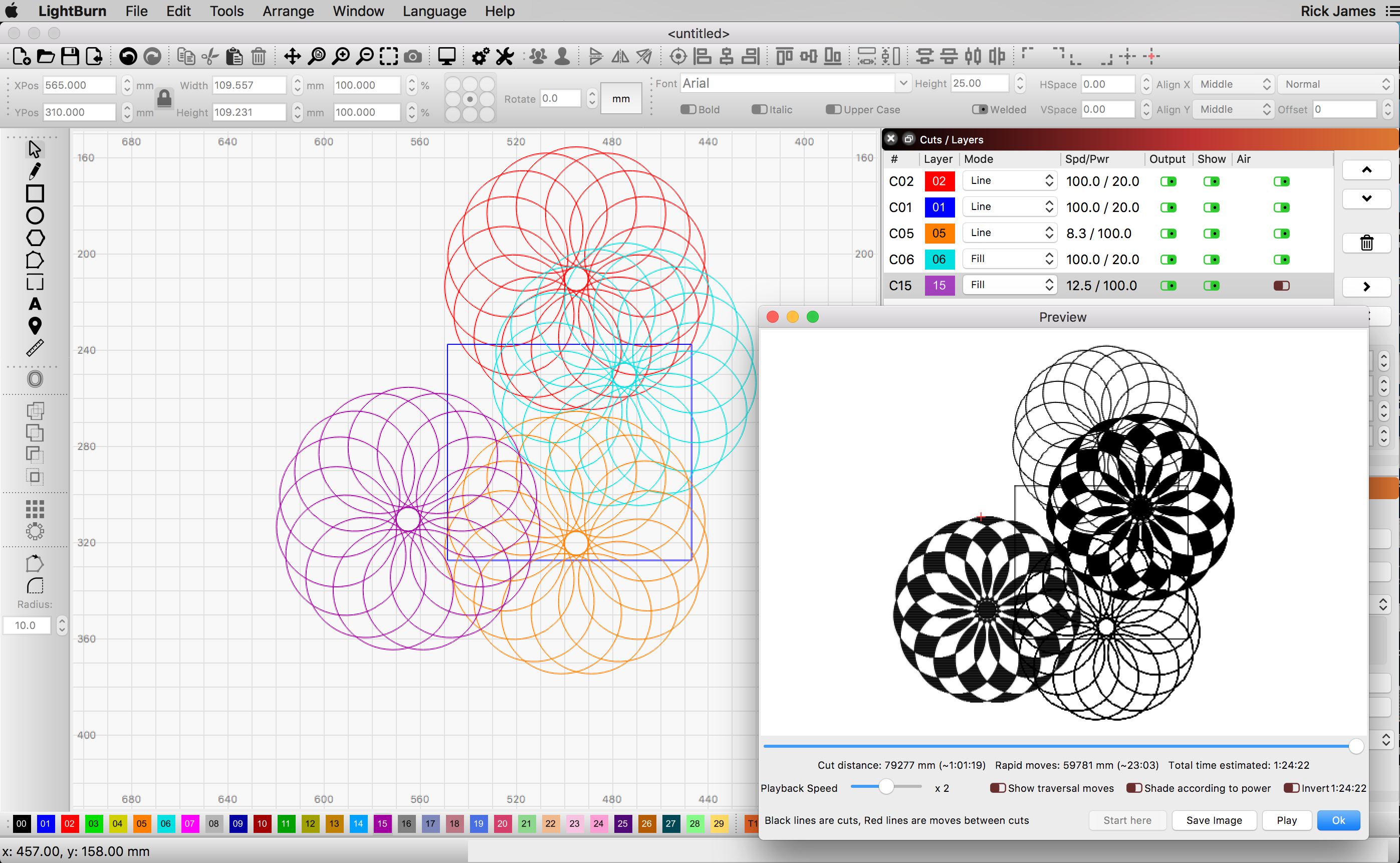

I’m trying to “mask” off a small portion of a big job so I can test my settings quickly and not waste my material. I have a few layers, some images, lines, line+fill etc. with really complex patterns.
I want to draw a little square and delete everything outside of it. So, I made small square, then selected everything else and grouped it, then selected the group and the square and did boolean union.
This almost does what I want but unfortunately it also flattens all of the layers into just one. I want to keep all the layers separate after doing the boolean intersection. Is this not possible? Do I have to do the boolean with every different layer individually one-by-one?

I would use the ‘Cut Shapes’, then delete the unwanted or use the ‘Cut Selected Shapes’ only selecting the desired test to be cut.
