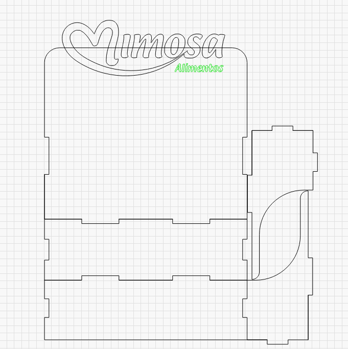

I’m trying to make the boolean with the letters and the box, but when I select both, the boolean is not available
The shapes must be closed and your letters must be a group or you must perform the boolean operation individually with each letter.

Are your letters individual shapes or is it an actual font based text? If it is individual shapes, you’ll have to perform the boolean operations on only 2 at a time.
Are the box shapes closed? Again can’t do a boolean operation on open paths.

The letters are in a group
Boolean are grayed and unavailable. The letters is a track from a logo image. Its closes. Even trying with individual letters or groups, I can’t do the boolean
