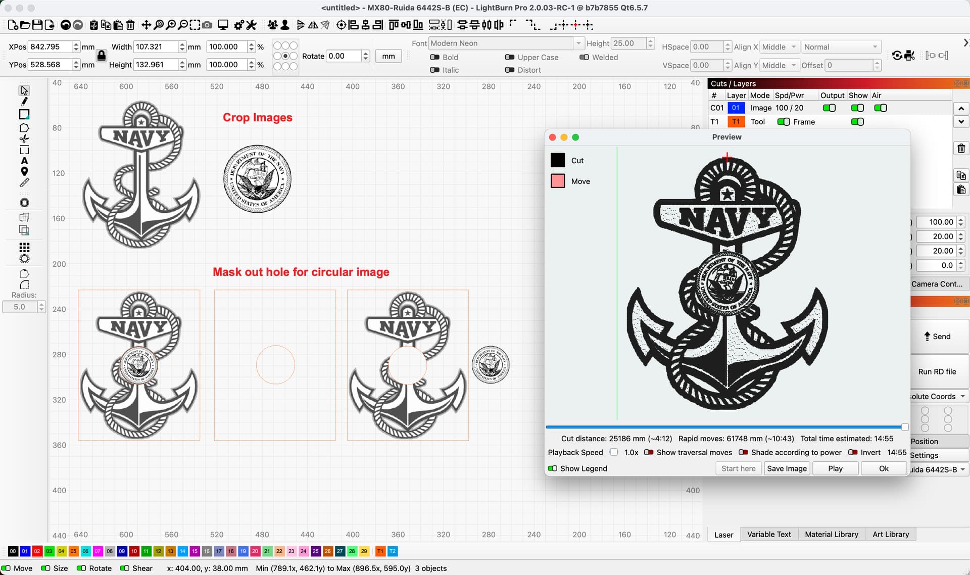

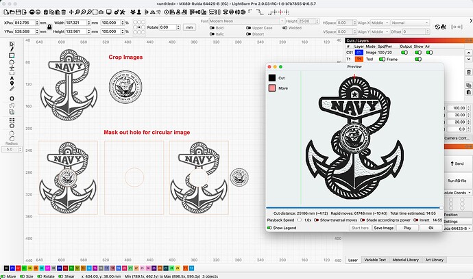

The ‘Boolean’ tools are for vector art and do not work for raster images. You use the word “photo”, indecating these are raster / bitmap images. You will need the vector versions to use Boolean.
Below I show using Image ‘Crop’ and ‘Mask’ to accomplish what you are after. I used your assets, which I note need clean-up or cleaner sources. ![]()

If I get a photo from Google Image and trace it ,it that a vector file?
Yes, the Trace tool is intended to produce a vector version of a “photo” or raster/bitmap image. When I looked at the images you posted, they are a bit grainy or pixilated. Try to find a hi-resolution version to start. This will produce better results. ![]()
