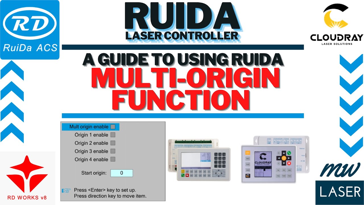

Note that your controller is likely a 6442.
Try disabling the “Multi origin enable” toggle and check to see if you’re able to set the origin.
I don’t see anything unusual in the LightBurn screenshot.
I looked at mine, the multi origin is disabled.
