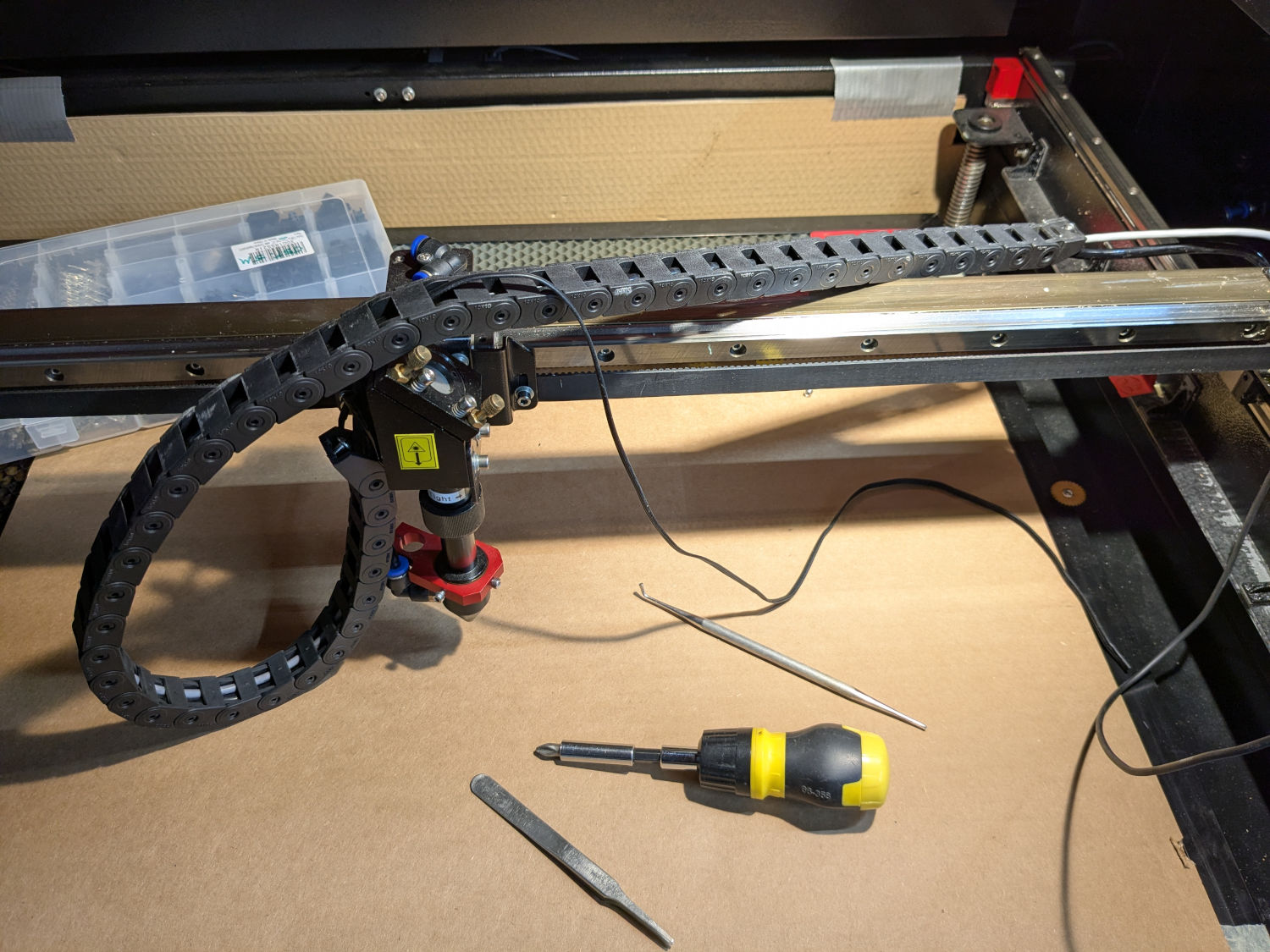

If the cable goes through the drag chains (as seems likely), then you must extract it, fish a new one through, and rewire the switch. I highly recommend flexy silicone-insulated ribbon cable, rather than ordinary = brittle PVC cable.
My adventure replacing the autofocus pen = switch cable on my machine may be informative:

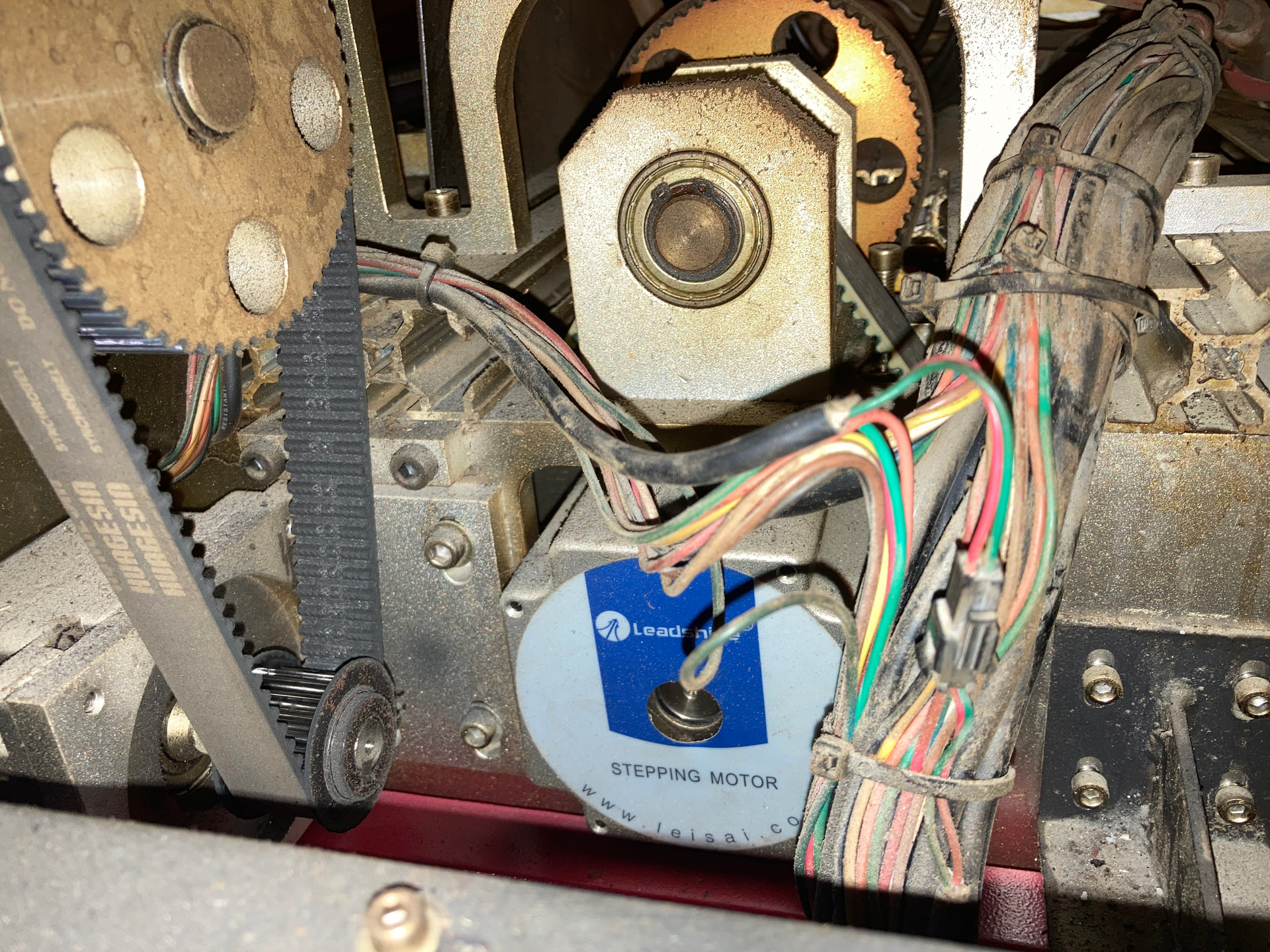

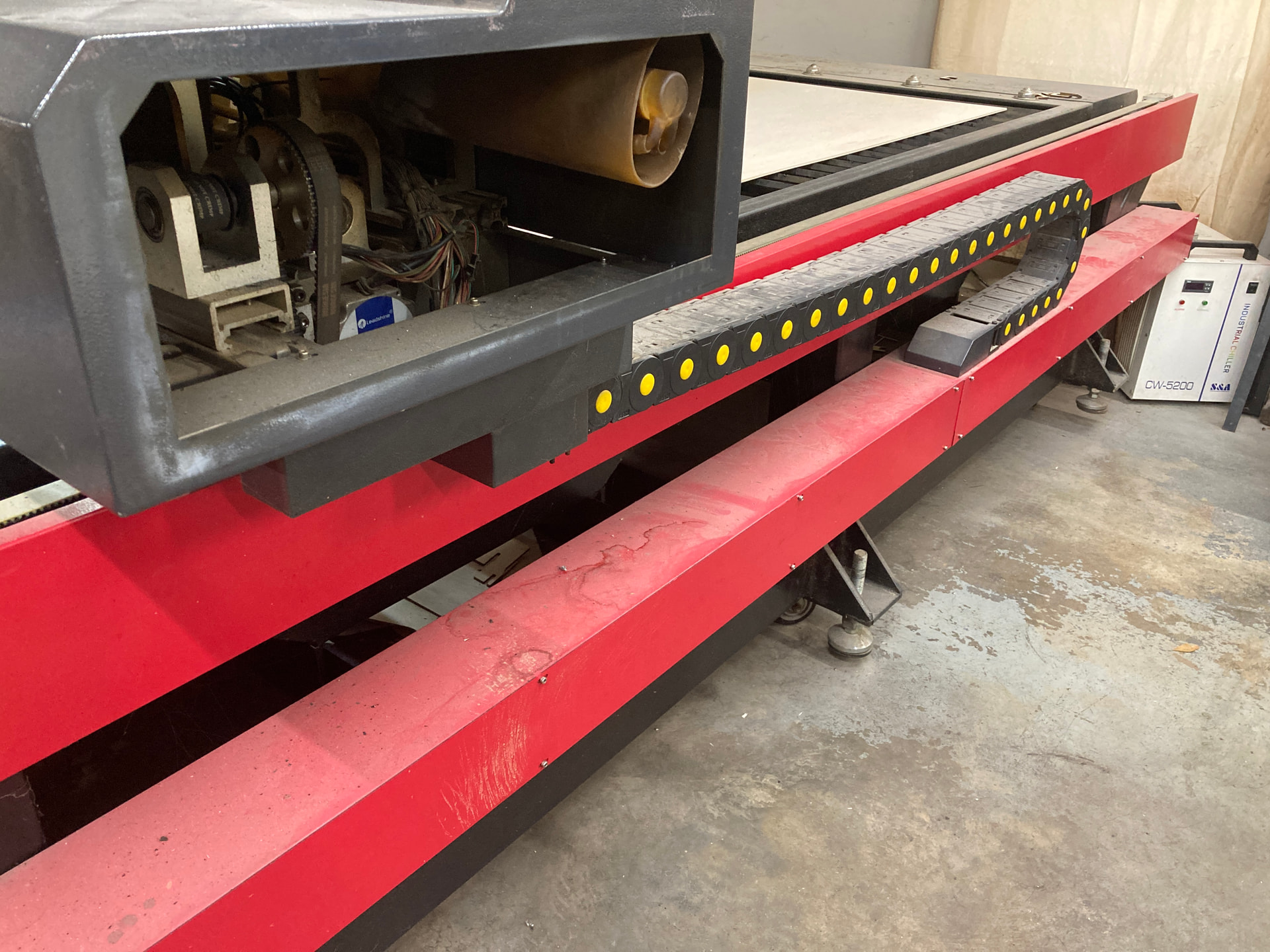

Hadn’t considered that. At first glance, there’s no obvious visible wires that it could be. I may be unlucky in that the HP5598 is pretty damn big. Cracking open this drag chain is going to be a pain, but I know that where all the movement is. All the wiring inside the cable race below it looks brand new. If any wire were going to fail, I’d assume it would either be near the stepper motor, or in that chain.
