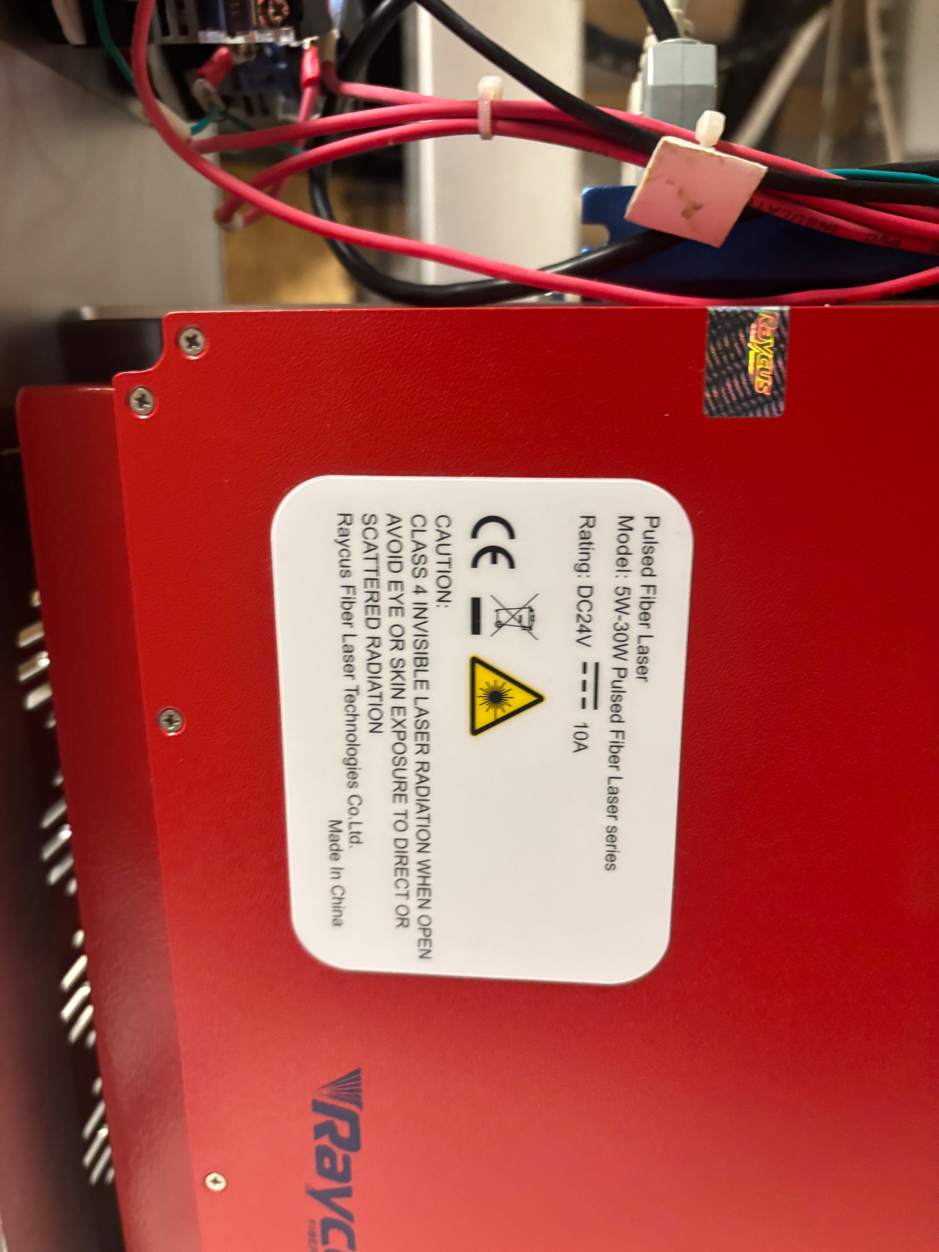

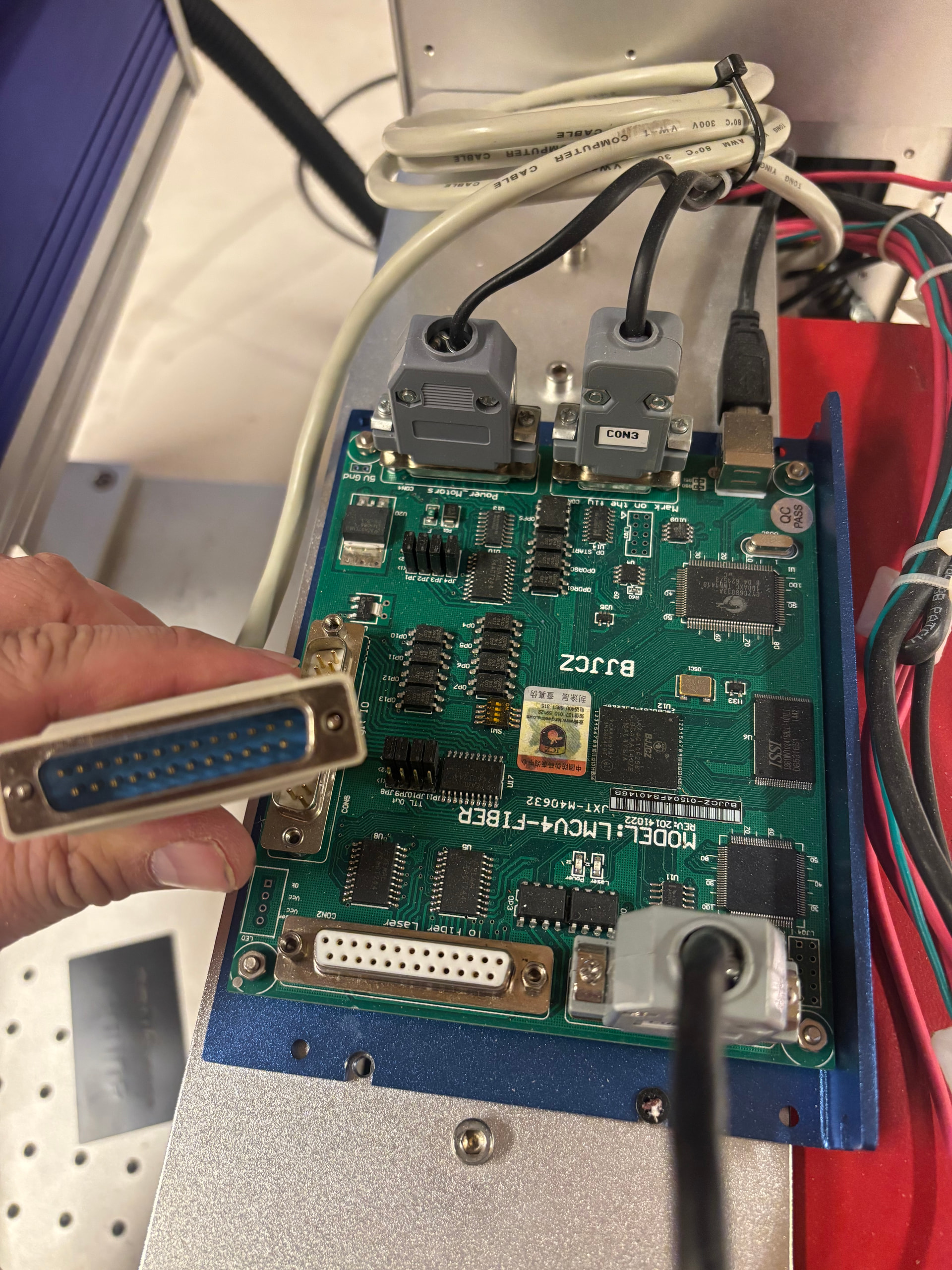

It is a cheap laser from China, so it has no known manufacturer. All I know is that it says LMCV4-Fiber and BJJCZ on the board, and “Pulsed Fiber Laser, Model 5W-30W Pulsed fiber laser series” on the laser source. It also has a F-Theta lens f=160mm, λ = 1064mm.

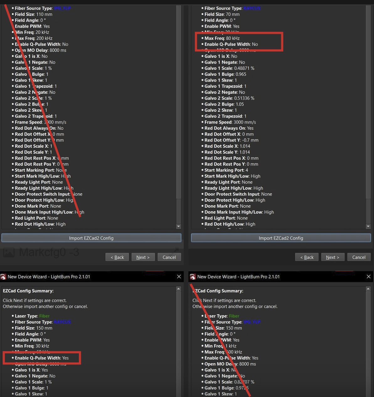

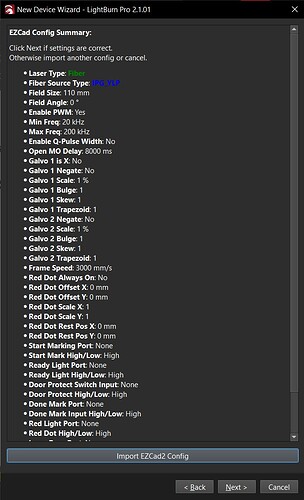

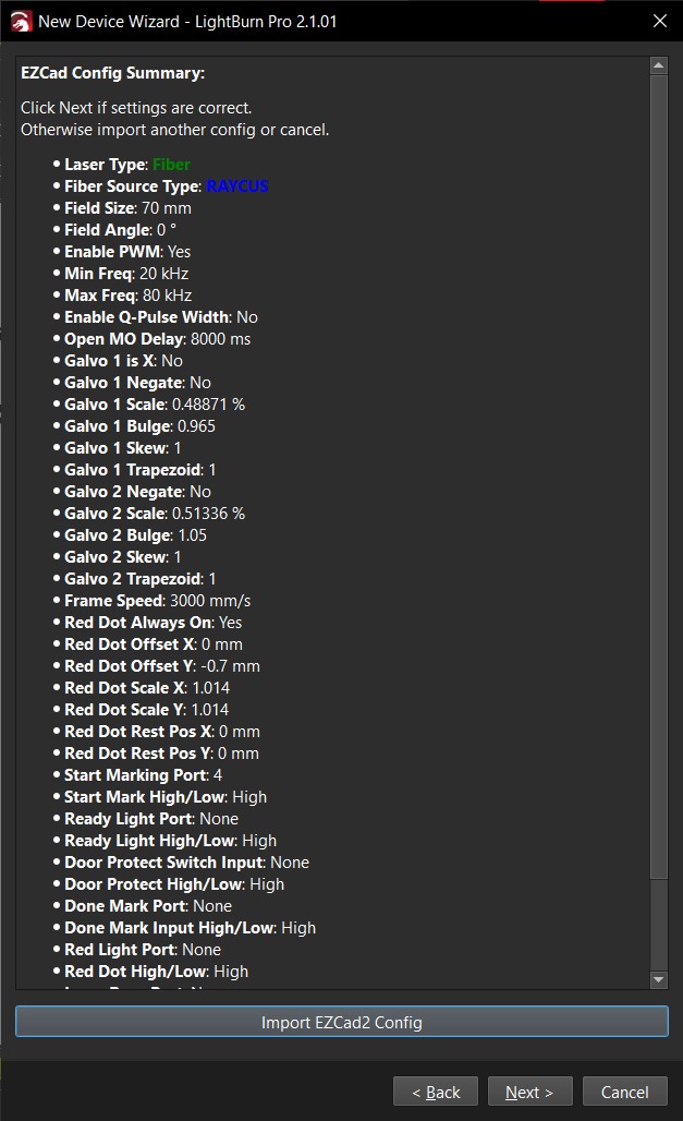

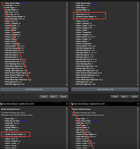

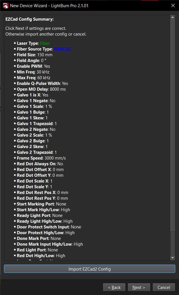

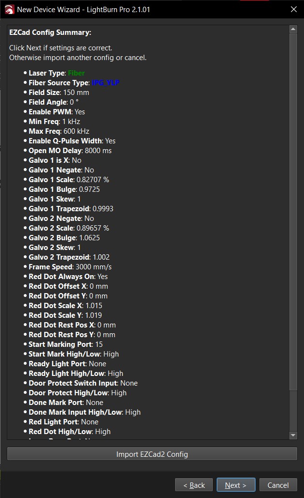

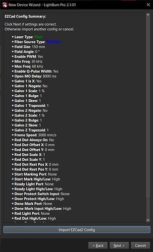

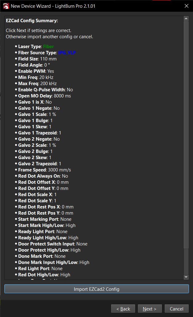

He sent me some markcfg-files he had on his computer but when I load them into Lightburn, some of them says Raycus, and some say IPG_YLP, and different size lens.
How do I know which one to use? And is it possible to set ip ut without the correct one?
The markcfg7 file has all the information about the controller and laser source. It also contains the lens correction data, that we normally find in a cor file.
You can likely build this from scratch in the device settings.
Good luck. :grinning_cat:
Is it possible to set it up without knowing anything about the controller or laser source? As you can tell this is my first fibre laser :sweat_smile:
Yes, use the markcfg7 file that’s loaded into Lightburn when you create the device.
Of course, you can do this yourself, but it will take a while, the configuration file is a better route.

To find out what kind of source you have, it’s likely you need to look inside the machine to find the laser source you have.
Some of the settings are related to the type of source, so you need to find out what it is.
Yes you can, but it would be much more simple if you find the correct configuration file. This should take care of the lenses.
You will still need to find what kind of source you have.

As far as the laser source it only says «Raycus Pulse fibre laser, 5W-30W pulsed fibre laser series». I can’t find any info about that specific model, other than a sertificate at Raycus homepage. And that file is locked, so only staff can download it.
Did the previous owner say that one of these MarkCfg files has to be the correct one?
Raycus is the manufacturer of the laser source. This fact narrows down the selection of possible configuration files to 2.
The difference between the remaining two is that one of them enables Q-Pulse control. To find out whether your source can use this, we would need the model number of the Raycus source in the machine.

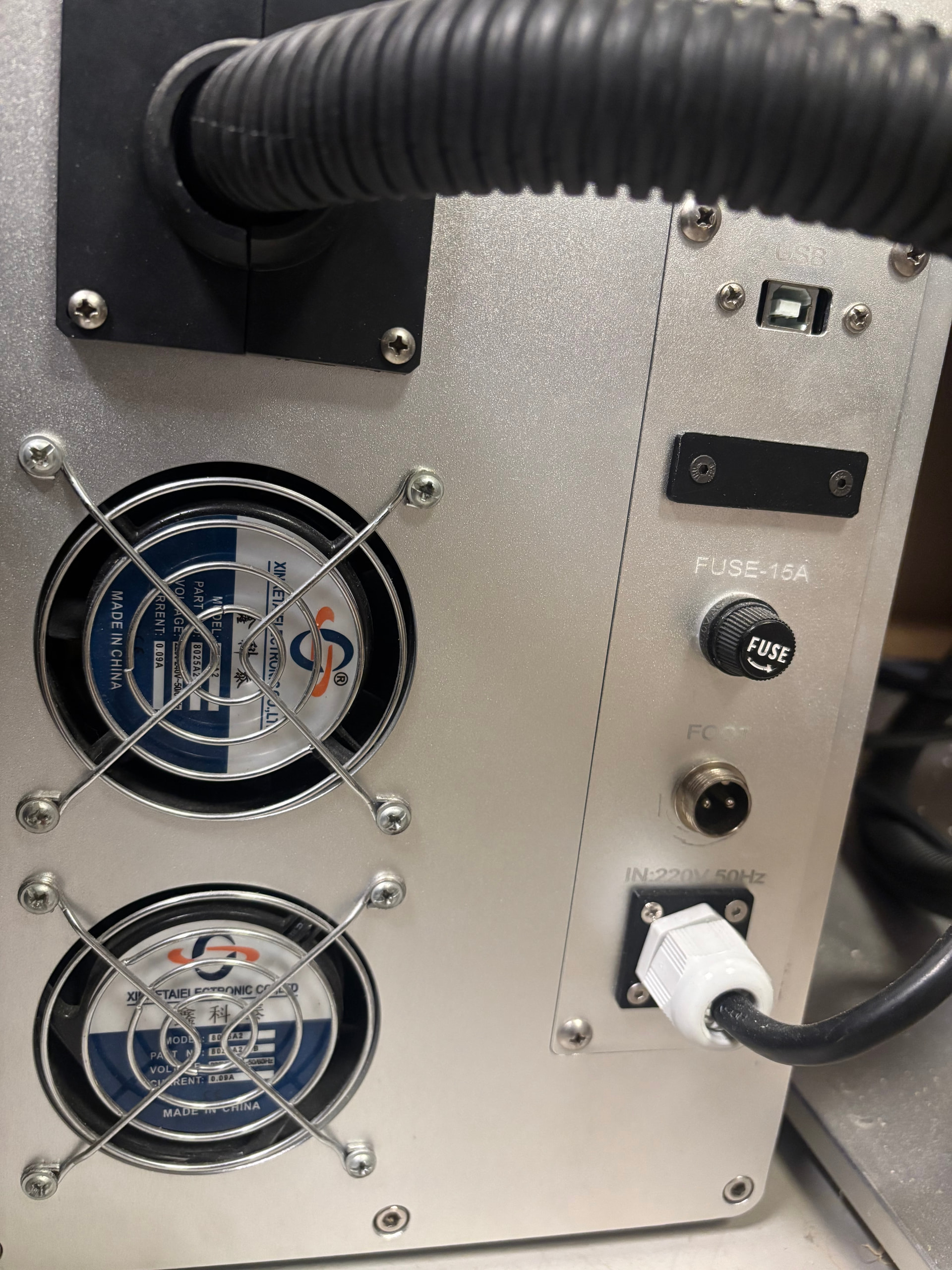

One of the config files sets a port for an external pedal. Does your machine have a port on the back to connect a pedal?
The field size in the settings can be safely ignored and changed later in the Device Settings. The link Jack sent helps calibrating the lens.
No, he first sent me two files, where one was for a uv laser and the other was from a IPG/YLP. I told him it probably was not right, so he came back with the others, from an owner before him again. But I would not bet on one of them being the correct one.
I can`t find anymore modelnumber than the one in the picture above.“Raycus Pulse fibre laser, 5W-30W pulsed fibre laser series”. Where should it be?
Yes, it looks like it has an input for that.
It sounds like neither he sent you are the correct source. You know it a Raycus not an IPG/YLP, which are German, I believe and a lot more expensive.
If you can’t ID the source, you’ll have a hard time knowing what it’s capabilities are.
Most Raycus machines I see are q-switch, but they make a MOPA in the 20W power also.
I think the suffix is they key. An RFL-P20Q and a MOPA has an ID of RFL-P20M.
Q-switch has a Q and a MOPA has an M. These might be elsewhere on your machine, such as a side you can’t see.
