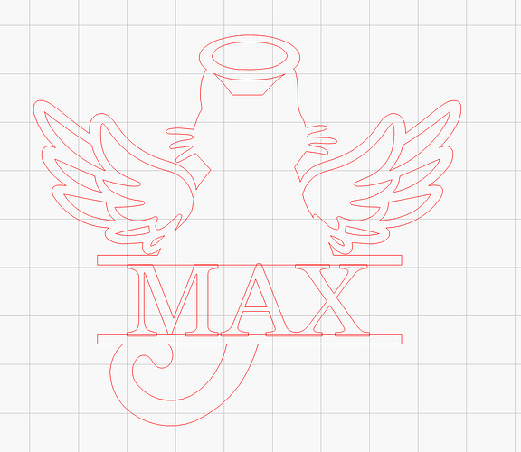

watched the video but it doesn’t show how to connect 3 pieces together that can’t be grouped because the are open pieces. Look at the bottom of this attachment. I put a name between the dogs top half and bottom half with the lines for the name touching the upper and lower lines but I’ve tried union and I’ve tried intersection neither will connect them at both the top and the bottom which is what I need to happen.

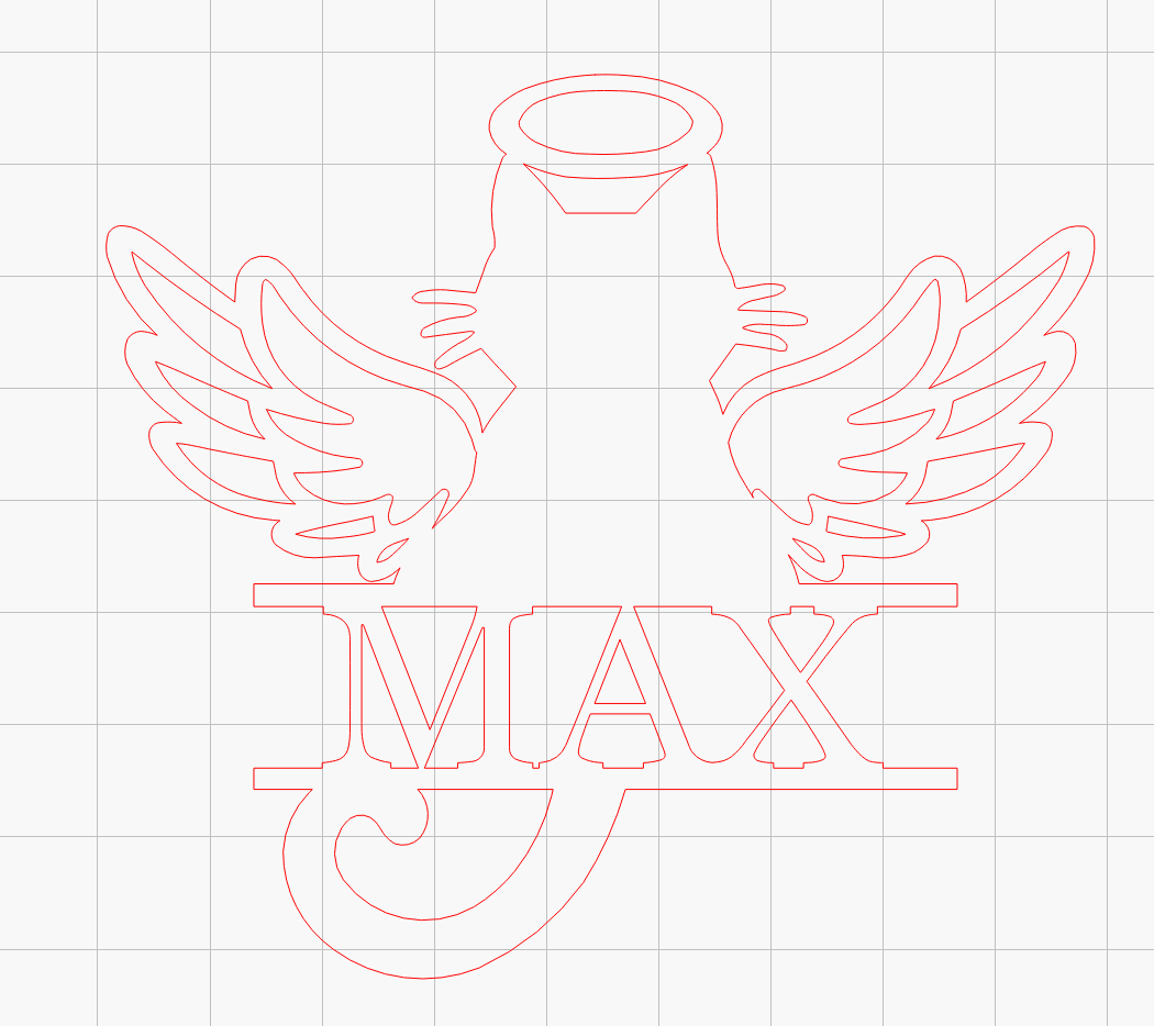

To connect the name in the middle you need to group the top and bottom parts before using the Boolean operation. That’s what I did here.

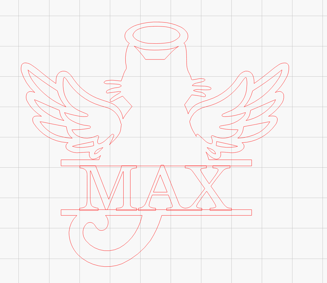

It works fine. This is on the one that didn’t have a name. It was already grouped by you. I place the text and size it so it crosses the lines.
Then I perform a Boolean Union and this is the result.

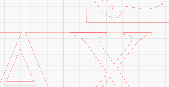

The reason the other ones didn’t work is because the text didn’t fully cross the line of the Angel. In this one the A crosses but the X doesn’t. It can’t union if they don’t cross each other.
