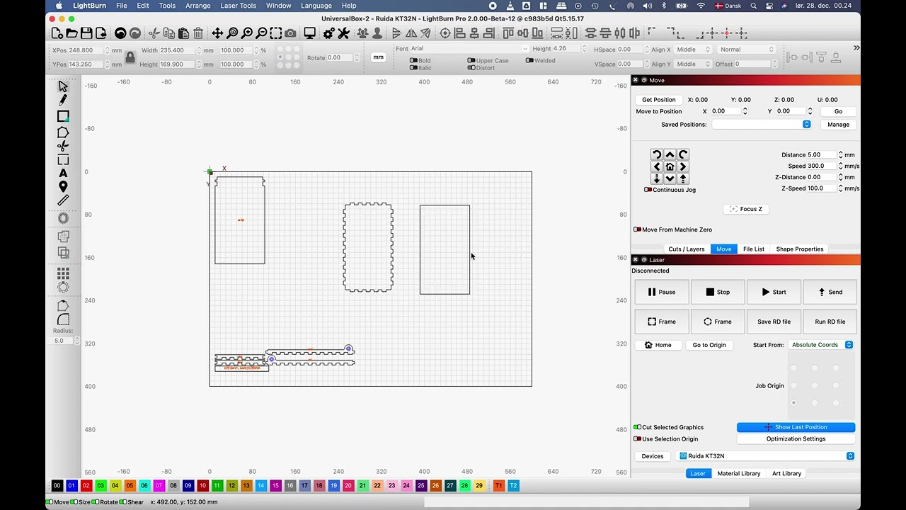

the only problem is that I have to create several different boxes like in the picture with red color, but with boxes.py I only get a box like in the black picture.
when I create a box, everything is fine, no question.
but I need a setting for boxers.py so that I get a layout like in the red picture, or is that not possible with boxes.py?
The corners can also be square, they don’t have to be round. It is important that the finger joints are not on the outer edge, but with a small distance from the outer edge as in the red picture.
Ahhh, that explains the problem, you just have to choose this one…
For my S30 Pro with air assist, I use 2.8mm Baltic ply and no Burn correction. That gives a snug fit. I only resize the box as needed.
I need several templates in different sizes for Lightburn that look like the black box.
I found the red box template on the internet,
I created the black one in boxes.py.
I would like a way to have a bottom plate with the finger joints that are a few millimeters away from the edge.
As in the red picture with bottom text with yes.
The length and number of the finger joints doesn’t matter, I need distance from the edge.
My friend (who fell in love with the red box) needs different boxes in different sizes, making them by hand is very laborious.

Strangely enough, I couldn’t get it to work in boxes.py either, but if it’s just the base that needs to be modified, it’s very quick to do manually, watch the video.

You can Offset Shapes outer shapes outward the amount you want.
WOW, thank you very much,
I wouldn’t have thought of it on my own.
If someone knows how to do it, it’s really easy.
I’m happy with this solution.
