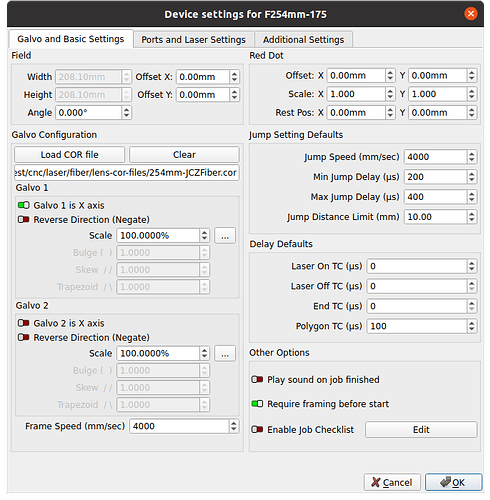

Last night, I upgraded my LB to add Galvo option and the upgrade went well, however when I ask the software to do a frame, it is actually burning the part, so the frame output power is too high.

You should have had a configuration file that came with your fiber machine. It also has all of your lens settings to correct for distortion.
Mine was called markcfg7 and lives here on the factory supplied usb stick…
/LMA22A1095JZ/Ezcad2.14.16/plug/

Thanks for your quick reply. When I wrote my post, I had already loaded the only .cor file I found in my factory USB stick. D:/software 11/software11/jcz11.cor
But it did not seem to have an effect on LB, because LB was burning inverted and the speed of the Galvo was incorrect also, etc. So at this point, how can I confirm LB is using my COR file and the file is correct?
Did you load it here? You can see what file is loaded.
In the above Device Settings, it’s likely you need to swap which galvo is X.

Here is my screenshot, it is similar to yours!
The speed of a Galvo is not 100 mm/s. That’s what I had, in some galvos I saw 4000 but for the GP20 the manufacturer says 10000
You are corrected about fixing the Inverted issue, in my case it is #2
My challenge now is to fix the issue with Frame. When I click on Frame to see the engraving area, it is actually engraving and damaging the material. In the diode laser I was able to adjust the percentage of the Frame output power but I don’t see that for Galvo.

How did you set up the laser when adding the device? It sounds like you never loaded the config. I would add a new laser and import the makrcfg file @jkwilborn mentioned above when it asks to import an ezcad config.
It appears he has the cor file loaded. This should contain everything. @micrololin is correct, it’s just lens information.
I did forget to suggest he visit Laser Everything follow the timing video… At least check them as his values, to me, are in question…
I thought the cor file was just the lens settings? There are no corrections in Galvo 1 or 2. Still makes me think he needs to add a new machine and import the markcfg file. It would not hurt and the original machine would still be there.
Thanks… I fixed it in the previous post… Yes, it’s just lens information.
If he can’t find the markcfg7 file, he’ll have to set it up from scratch… I think I put the path to it on the factory usb stick - he could search the stick…
