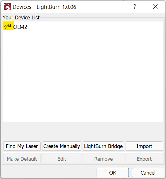

  1. Confirm that your device is setup as a GRBL device, not GRBL-M3 or other. You can check this by clicking on the “Devices” button in the Laser window.

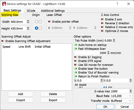

Your configuration shows $130 (width) $131 (height) of 200x200mm.
The main configuration I was looking for $32 is set to 0 which is the likely cause of the issue you listed.
In order to fix this please do the following:
  1. Take a backup of your configuration in Edit->Machine Settings; Push save button
  2. In console, type $32=1 followed by enter key

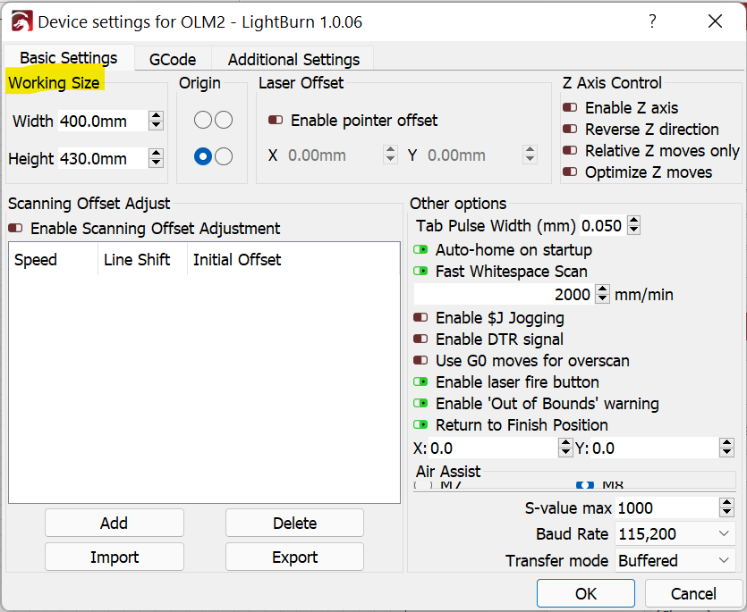

  3. If your machine is in fact 410x420mm then do $130=410 and $131=420 one at a time followed by enter
  4. Make sure that Edit->Device Settings reflects the same values:
There may be other configurations that are incorrect based on what’s happening but start with these.
