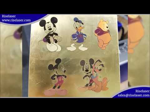

Hi! so, we have a MOPA JPT 60w m7 and we are trying to get colours on brass. But all of them get grey or do nothing on the metal, furthermore we tried a bunch of settings we got on internet or YouTube, but nothing works, including videos talking about brass.
Also, do you have some kind of information about what the parameters on the software works for and what it were supposed to do when colour marking? like the Q pulse or Frequency.

ok… thank you for being realistic! we will try to contact some people that made videos about colour engraving on brass, but after reading what you said we thought about it and I don’t really know but, im afraid it was SS or inox in a brass colours
i will put the link of the videos we saw under
https://youtu.be/a_wFn9bQzcE?si=TLmnV9r1_VqIqkUJ (this one, in fact is ss that really seems like brass)
