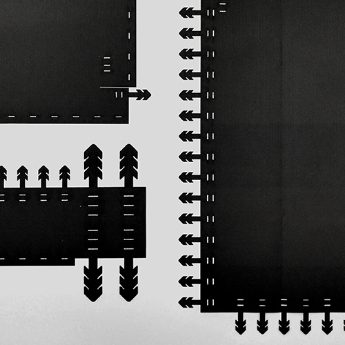

It appears that Clement Zheng is on a whole other level.
