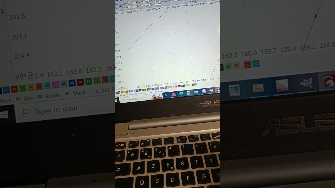

Hello, no. When I select the node appears in red, not in green.
When one of the node finally breaks the Line, then thé node is green.
Here is a video of what I do (posted on youtube)
Thank you for the video, that was very helpful!
It looks like you’re selecting the node you want to break, then moving your mouse away before pressing B. You don’t need to click the node to select it, but you do need to be hovering over it for node editing to work.

OK ! Indeed I tought I had to select the node to make it work :sweat_smile: Sorry, now it works perfectly just by hovering over the node :face_with_hand_over_mouth:
