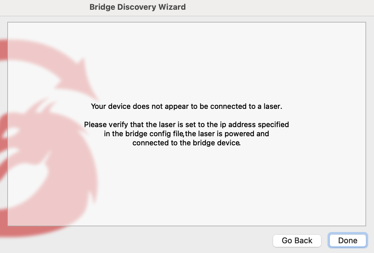

I moved the booster from the back of the house to the garage (which sort of defies it’s purpose because now its too far away from the router) but when I did that I was able to open the 192.168.42.1 page right away. This worked a few times until it didn’t. I still couldn’t finish the setup though.
At the end of the day, I just want to send a file from my laptop to my laser via the Lightburn Bridge instead of a USB cable while I’m standing right beside my laser machine with my laptop. Is this possible without a university degree?
Do I have to potentially buy a router to create a new network in the garage just to get my computer to connect to the Raspberry? Can it be done via a phone’s personal hotspot? This has been a nightmare experience, with so much time wasted.

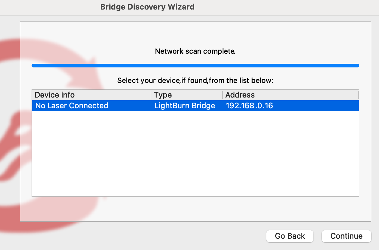

Well, right now it seems the bridge successfully connects to your network but does not connect to Ruida, which could be a fault with the bridge or with the ruida controller or the connection between them.

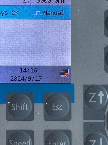

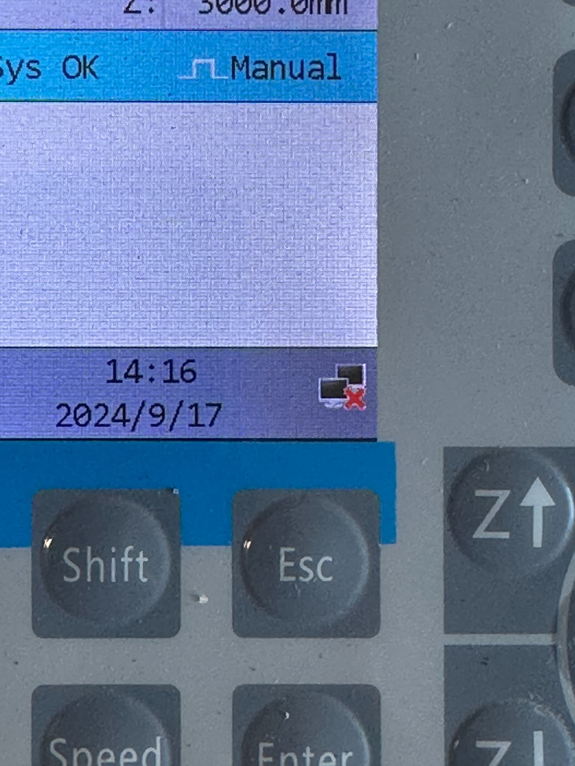

If you disconnect the lan cable from the bridge does this icon change or disappear?

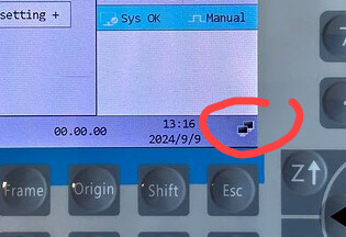

Keep in mind this means it’s hardware is connected,.
It’s likely saying that the hardware (green) is connected at 100mbps (yellow/orange)

Yes, it gets a red ‘X’ on it.

Find the bridge’s IP address, and go to that in your web browser - looks like it currently is http://192.168.0.16:80 or (if no longer there) try http://lightburnbridge.local/ , then attach here both the network and relay logs.
