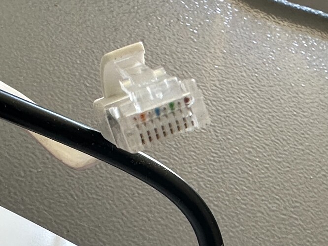

Another thing to look at. I originally used the ethernet cable that came with the laser. It didn’t work with the bridge. There were only 6 wires in it not 8. When I got a new cable it worked.

The first thing I see in the instructions that could go awry is the instruction next to ‘Short Network cable’. Please confirm the cable type you connected between the LightBurn Pi Bridge and the back panel of the engraver is a short ethernet cable (Cat5 Cat6 etc). The height difference of the ports in the 2nd picture in ‘the instructions’ is subtle.
The network cable I plugged in is the one supplied in the box of the Lightburn Bridge. It’s about 1 metre long. It has “Cat 6 flat cable ROHS” printed on it.
