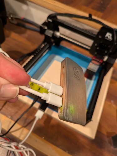

Bought an absolutely tiny and cute 3.5W laser for $70 and noted the PSU only output 36W. So I got to thinking, I could make this into a completely untethered laser. So I designed up a squaring jig and setup a Raspberry Pi Zero 2W with Octoprint + GRBL plugins and run the entire setup off a makita battery inverter. Works great, can be carried anywhere, and set on larger objects :slight_smile: Only a 130mm square engraving area, but a lot of the time, that’s all you need.
Workflow is just place my object in the square, or set the laser on my object depending on project. Export my gcode from Lightburn, drag/drop into the octoprint instance, hit go.
Bonus Points; thermochromic pi case to track heat!
Also for a bit of context on how small it is; it fits INSIDE my Prusa MK3S+.

That is a cool setup. I would like to know if you calculated how long the rig will run before the battery dies out? :thinking: I’m thinking about, what if someone wanted to take your rig to flea market type place and make trinket things that would only take a few minutes to burn. While the customer stands there waiting and watching a laser, (that they can’t see working :cry:) to make their trinket.
While I haven’t tested until a battery has died, I’ve had a 4.0Ah battery on it and it lasted all day with on and off playing with it. I’ll try to do a long run with it and try to get some harder numbers. :slight_smile: I can definitely say, if you had a charger available and two batteries, you could run almost non-stop.
But running trinkets that take 2-5 minutes apiece? I’d say you could likely run an 8 hour shift on one large battery.
You could use the box it comes in as an enclosure! That’s my plan eventually. I have a USB powered 120mm fan that I’m going to cut out for ventilation (since I have a spare USB on the inverter to run the fan as well as the Pi) and notch a small wire hole to run the pi/battery/wires outside the box. Cut a small flap so they can lift it and wear the included goggles to watch.

Well, you’re in luck. My setup lasts a long while, and it’s highly inefficient. I’m using an 18v DC battery, with an inverter to 120V AC, to a PSU that converts it back to 12V DC. If you run it directly off 12V DC, the batteries will last way longer.
The PSU outputs 3.0A @ 12V DC with a standard 5.5mm barrel jack. So, theoretically, if you have a wiring harness to convert the RC batter to 5.5mm barrel jack, you’re good to go with higher efficiency. :slight_smile:

Finally did a ‘real test’ (not until death) but to get some general numbers. On a 4.0Ah battery with an inverter, powering the laser itself and the pi. I ran a 120x120 solid square fill. 0.1mm interval, 80% power, 6000mm/min. Trying to pull a high draw with the almost 100% power, constant power, and high motor use at a fast speed. Engrave took 38 minutes, ran it once; still 4 bars on the battery indicator. Ran it again, so about 1.25 hours, 3 bars. So you can likely get 3~4 hours constant running. Which engraves won’t be 100% on and using the full engrave area, so yeah. This is also ontop of, I’ve just had it on and idle for about 6+ hours.
So yeah, take a couple batteries for safety and you should be good to go at a flea market, trade show, etc. :slight_smile:
EDIT: Also if you have a 12V DC source, running it directly without all the inefficient conversions I’m doing should last longer. I’d like to try say, one of those kids motorized vehicle batteries, or a lawnmower battery that’s 12V. However, I’m not going to spend any more money currently on this project. Hopefully I can get the solar test in tomorrow if my stuff doesn’t arrive too late.
Sorry for double post. :frowning: However, the one day the things I ordered get in at a decent time? It’s overcast and rainy. No solar tests to be done today.
However comma I am able to simulate it. I have a battery with an 18V DC output (not a makita battery, it has proper 5.5mm DC outputs). So I used that as my 18V source, wired it into an SK90C buck-boost supply and set the output to 12V 3.0A. Voilà, laser seems to be running happily from it.
Movement alone seems to average about 310mA, or about 3.7W… Not bad at all. Let’s see what 6000mm/min and 80% power consumes. Remember, our goal is <30W.
Aaaand results? That’s a lot leaner than I thought! Did a 120mm square, 6000mm/min, 80% power, and only used about 12V @ 1.3A so average 15.6W!
Here’s the graph display from start to finish. Now I really want to get to that solar test! I figured it would require a fully on sunshine day… but this looks like I might manage a partial cloudy day with decent sun. Do note; this has the pi being powered by an external source, this is just powering the laser.
EDIT: Bonus running tests on a square of thermochromic PLA. The laser doesn’t burn the PLA, but the heat causes it to change temporarily so you can see what you did, but then it fades as it cools down.
EDIT2: Don’t do this :smiley:
It works fine, but that’s a lot of exposed and weak connections. I have two 30mm stainless steel coins shoved into the contacts of the battery, with alligator clips connecting them to the wires and to the supply. Works great though. Might end up printing a proper click-on accessory with solid connections and a barrel output. Make a makita battery run DC power supply for any voltage I need. :upside_down_face:
