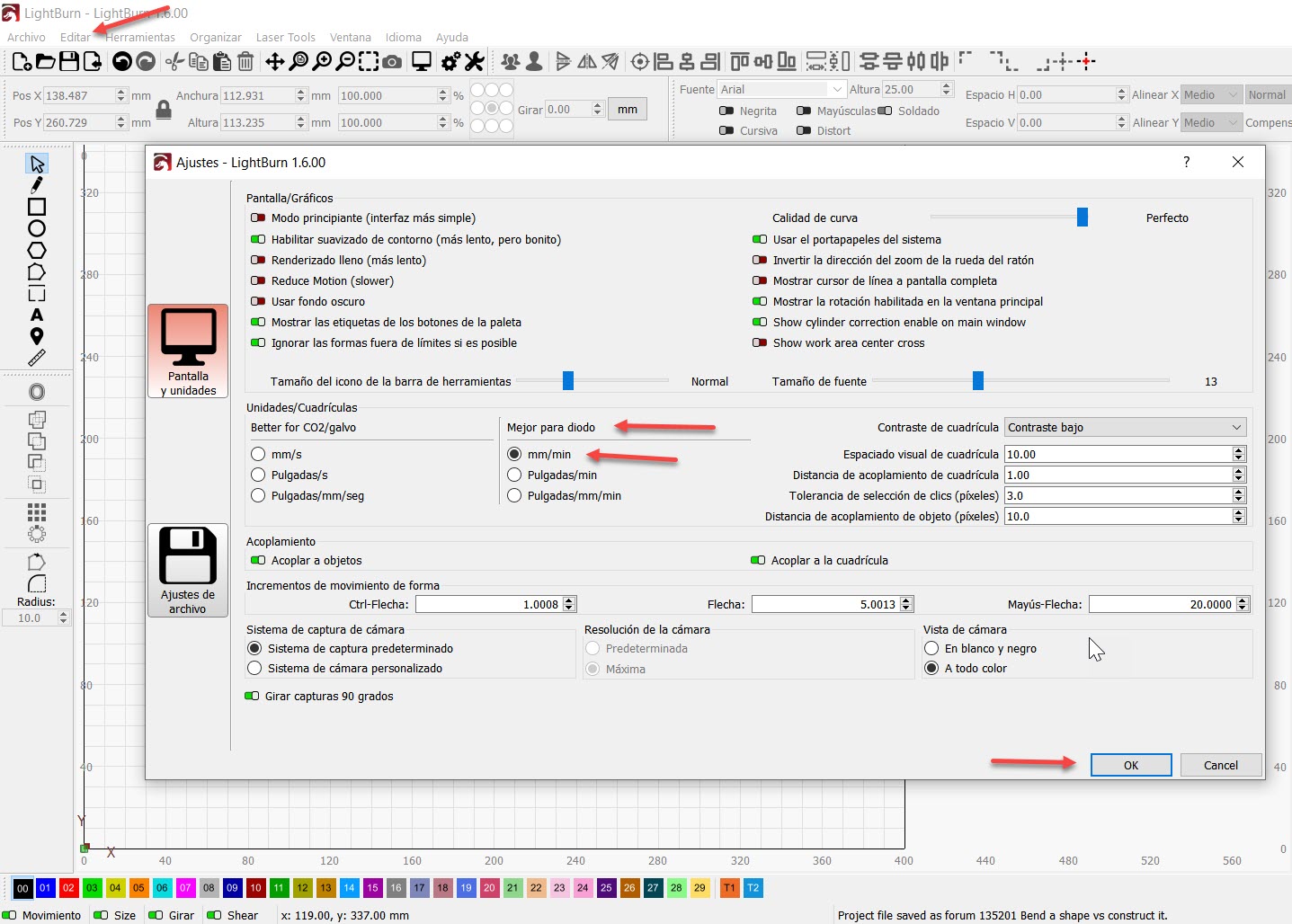

LightBurn may have left the measurement units for speed in mm/second. If this is causing the cutting to be weak, you may find more success if you work in mm/minute. It is set in the Settings window.
Click Edit, click Settings, confirm the units are mm/minute, and click OK when finished.
If you change the units of measurement, you will see the speed you had requested in the new units of measurement.
Please re-test with a speed of 240 (mm/minute) after the units are corrected.
